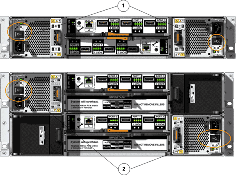

  3. Ensure that the power switches on the Drive Enclosures are switched on.
    Figure: 1 Power switches on the Drive Enclosures
    Legend
    1 The power switches on the DE2-24P Drive Enclosure 2 The power switches on the DE2-24C Drive Enclosure

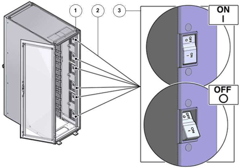

  7. Power on the PDU circuit breakers to apply power to the system.
    Figure: 2 PDU circuit breakers (example)
    Legend
    1 Rack
    2 Example of PDU circuit breakers
    3 Toggle switch
    Note: The Controllers and the Pilots automatically power on when you apply power to the system.
