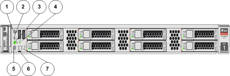

The Pilot LEDs are on the front panel of the Pilot. Use these diagnostic LEDs to determine if a component has failed in the Pilot.
Figure 1: LEDs at the front of the Pilot
| 1 Locator LED / Locator button: white | 5 Power button |
| 2 Service Action Required LED or Caution or Fault LED: Amber | 6 Fan fault LED: amber |
| 3 OK LED: green | 7 Power supply fault LED: amber |
| 4 Service processor LED: green |

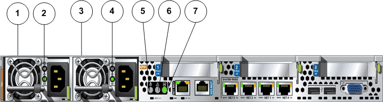

Figure 2: LEDs at the back of the Pilot
| 1 Poser supply 0 (PS0) | 5 Locator LED: white |
| 2 Power supply LEDs: Service Required LED (amber) and AC OK LED (green) | 6 Service Required LED: amber |
| 3 Power supply 1 (PS1) | 7 Power or OK LED: green |
| 4 Power supply LEDs: Service Required LED (amber) and AC OK LED (green) |
