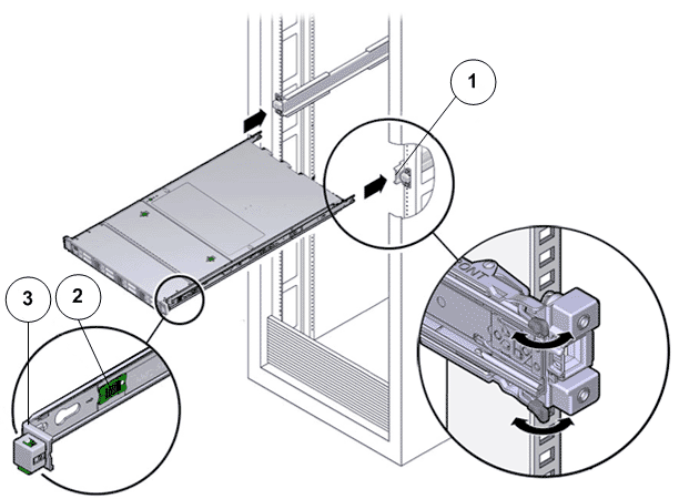

Figure 1: Pilot with mounting brackets inserted into the slide rails
| 1 Mounting brackets inserted into the slide rail |
| 2 Slide rail release button |
| 3 Slide rail lock |

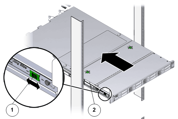

Figure 2: Pilot inserted into the rack
| 1 Slide rail button |
| 2 Mounting bracket |
