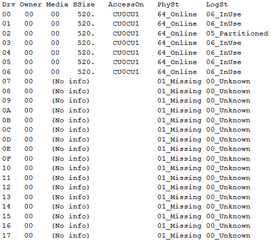

    The console displays a list of the drives installed on the Drive Enclosure. The following example shows a list of drives displayed in the console.
     alternate image text
    Note: If any of the drives are offline, select a different Drive Enclosure.
