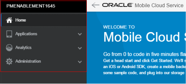

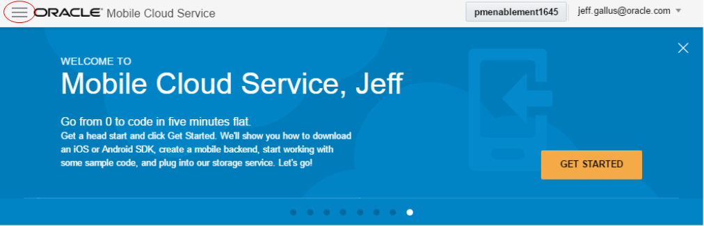

  1. Log in to your MCS instance and using the burger icon, open your DEVELOPMENT menu..
    Sample chart
    Sample chart

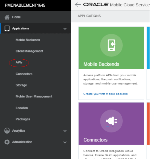

  2. In your DEVELOPMENT menu, expand the Applications node and click the APIs option.

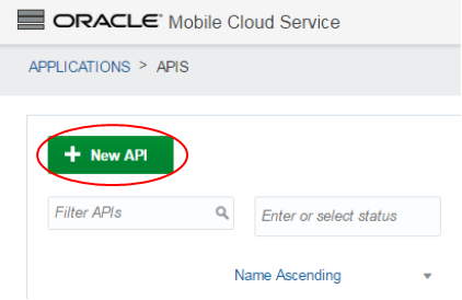

  3. Dismiss the menu and in the upper left corner of the APIs page, click the New API button and select API to start.
    Sample chart

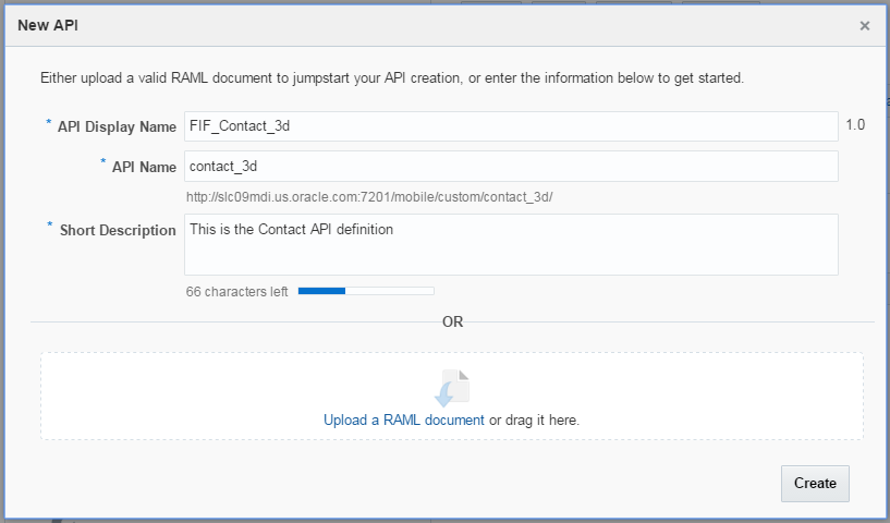

  4. Enter the following values for the new API:
    API Display Name: FIF_Contact_xx (where xx is a unique value like your initials)
    API Name: contact_xx (where xx is a unique value like your initials)
    Short Description: This is the Contact API definition.
    Then click Create
    Sample chart

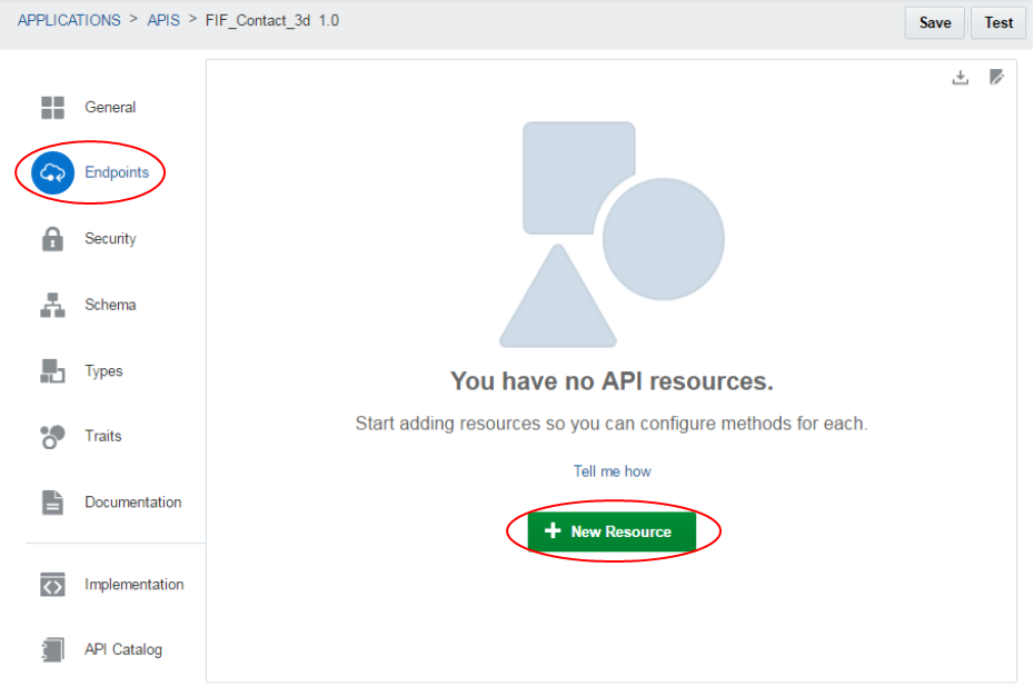

  5. You navigate to a page where you can update general information about the API. Now define some resources for the API.

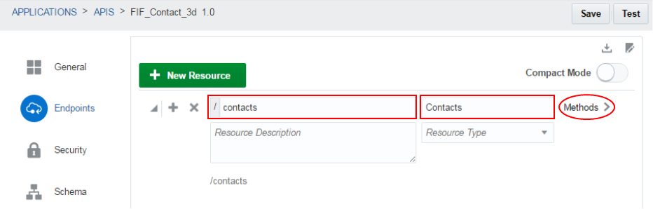

    Click the Endpoints tab, and then at the bottom of the page, click the New Resource button.
    Sample chart
  6. Enter contacts as the resource path and Contacts as the Display Name.
    Then, click the Methods link on the far right.
    Sample chart

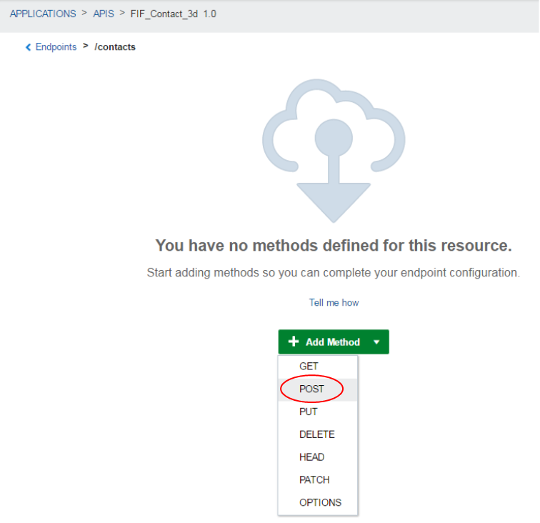

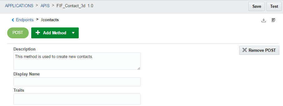

  1. Here you add a method to the resource. Click the New Method button to see the methods that you can add.
    Select the POST method because it will be used to create new contacts.
    Sample chart
  2. Add the following description: This method is used to create new contacts.
    Sample chart

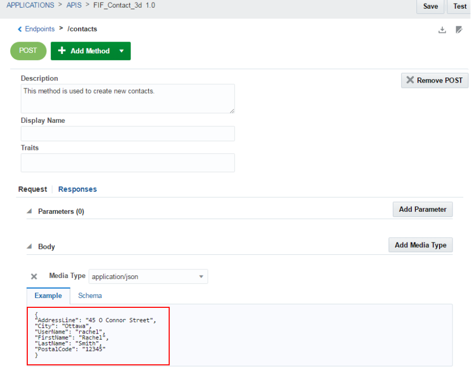

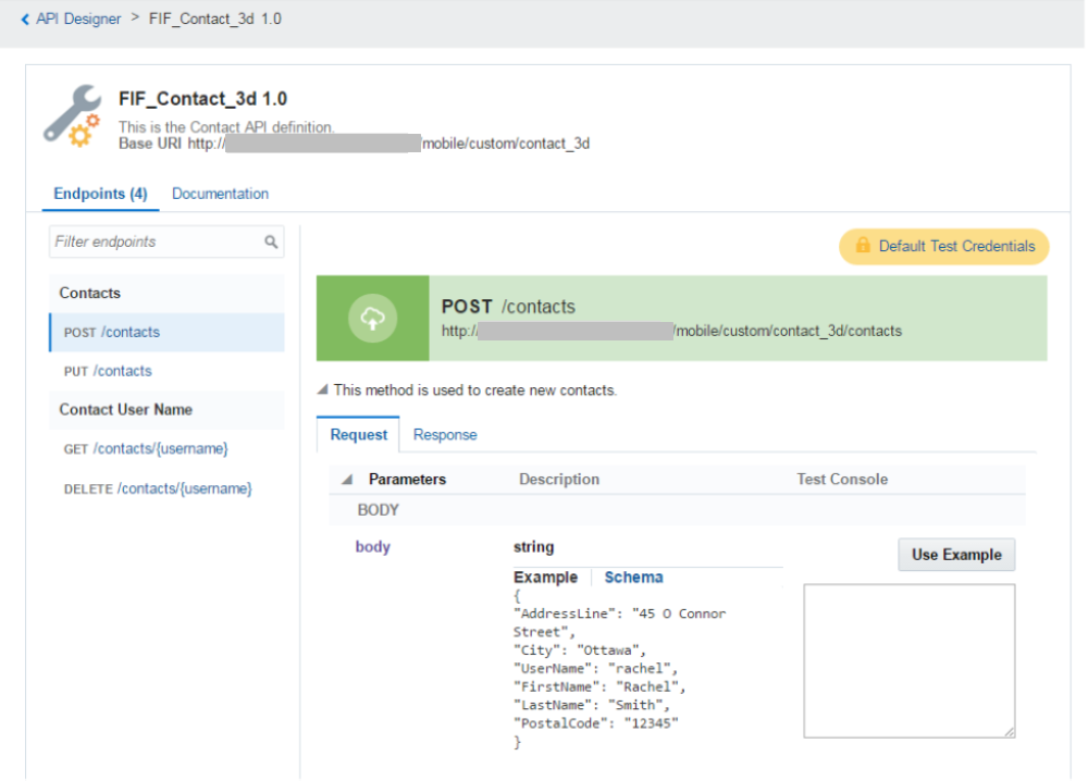

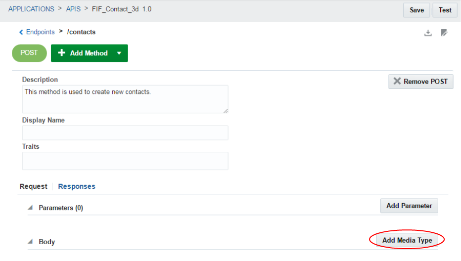

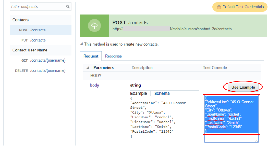

  3. Next add some sample data to use for testing.
    Click the Add Media Type button.
    Sample chart
  4. A new area appears. Click the Example tab.
    Copy and paste the following code into the example area:
    "AddressLine": "45 O Connor Street",
    "City": "Ottawa",
    "UserName": "rachel",
    "FirstName": "Rachel",
    "LastName": "Smith",
    "PostalCode": "12345"
    Sample chart

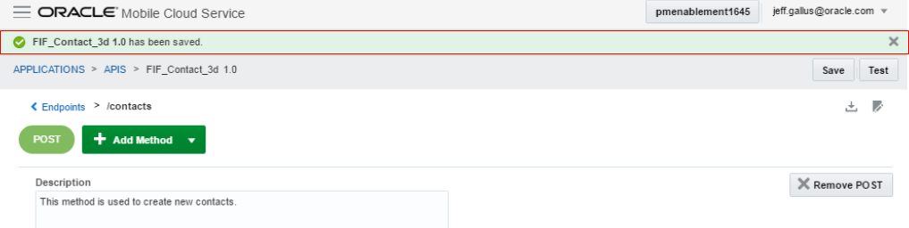

  5. Then click the Save button, and you should see a confirmation message.
    Sample chart

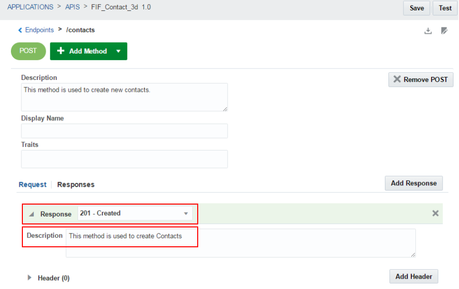

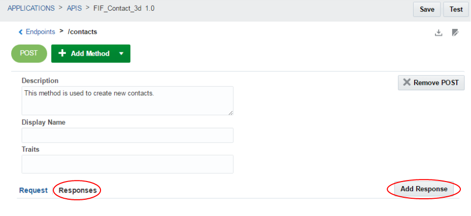

  6. Next, add a response. The response will be sent when the contact is successfully created. Click the Responses tab and then click the Add Response button.
    Sample chart
  7. For the Response, select 201 - Created and enter a description.
    Then save your work.
    Sample chart

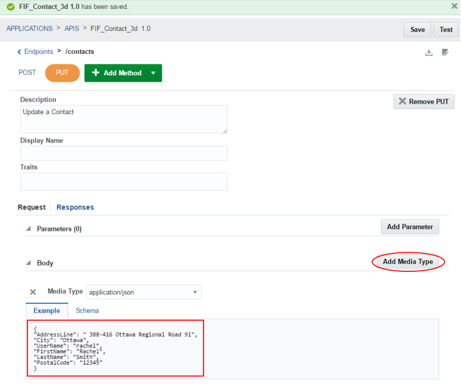

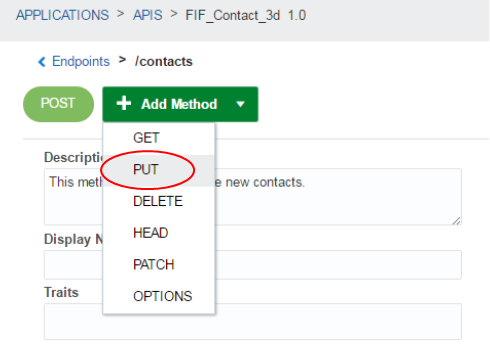

  8. Create another new method to update contacts.
    From the New Method list, select the PUT method.
    Sample chart

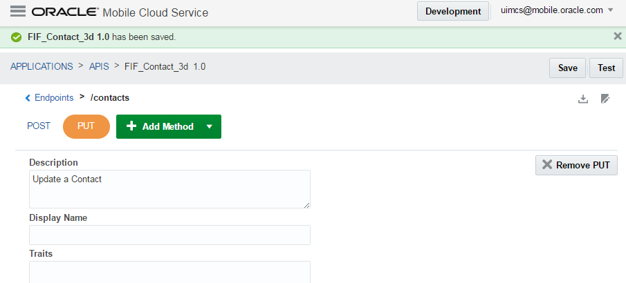

  9. As you did with the POST method, add a description for the PUT method.
    Then, click the Save button.
    Sample chart
  10. Click the Add Media Type button and then copy and paste the following code into the Example area. The code can be found in the labfiles/code/ContactsExamplePUT.txt file.
    "AddressLine": " 388-416 Ottawa Regional Road 91",
    "City": "Ottawa",
    Then click the Save button.
    Sample chart

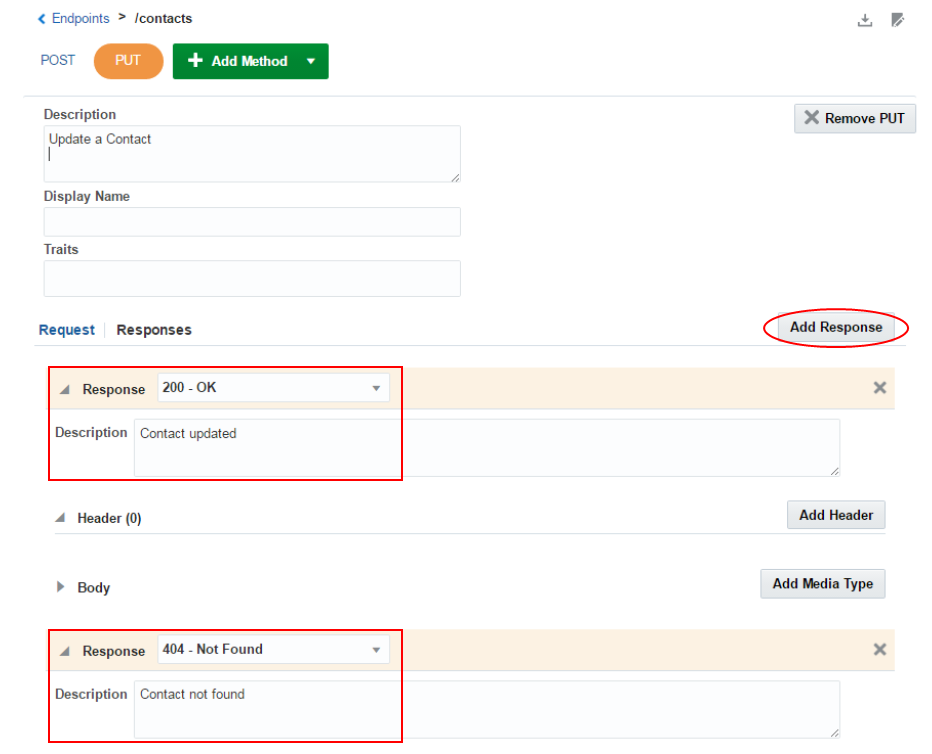

  11. As you did with the POST method, add a response for the PUT method. But this time, add two responses: an OK response (200) and a Not Found response (404).
    Include descriptions for each response and save your work.
    Sample chart

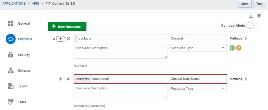

Step 3: Include nested resources in the API
In this part of the tutorial, you add a nested resource to the existing contacts resource to GET and DELETE contacts by username.

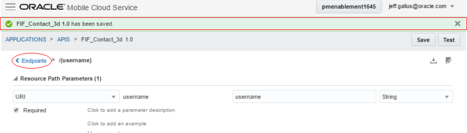

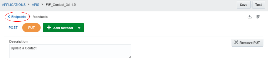

  1. Add another resource, but this time, add a nested resource to the existing contacts resource.
    Click the Endpoints breadcrumb link to go back to the Endpoints page.
    Sample chart

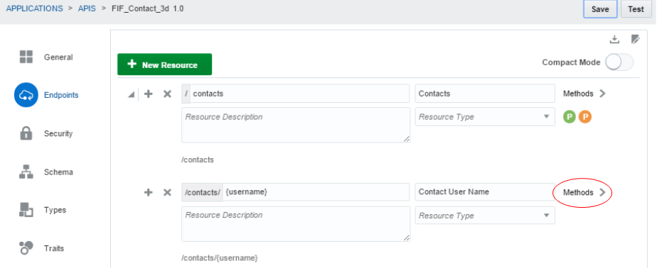

  2. In the contacts resource, click the Add Nested Resource icon and enter {username} as resource path and Contact User Name as the Display Name.
    Sample chart
  3. Save all your work.
    Sample chart

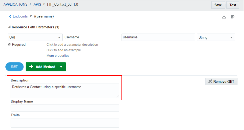

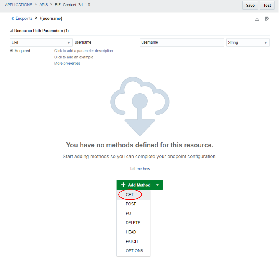

  4. As you did earlier, add some methods to the new {username} resource. Click the Methods link to the right of the nested resource.
    Sample chart

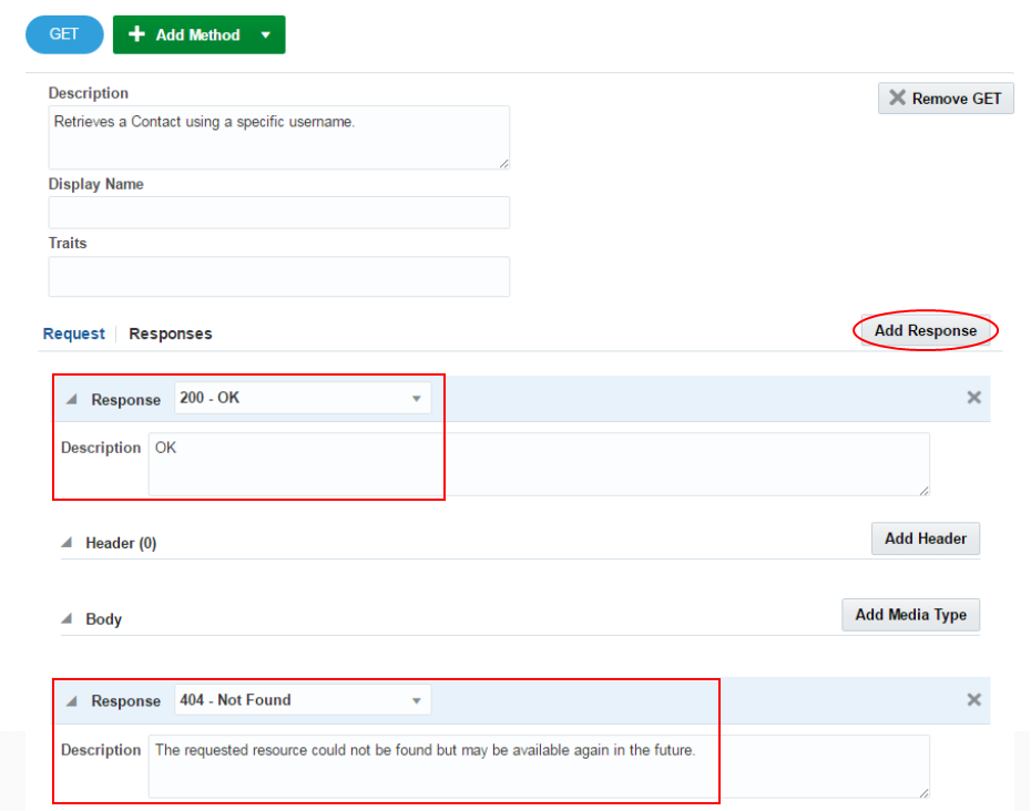

  5. Add a new GET method and specify a description.
    Sample chart
    Sample chart
  6. Click the Responses tab and add the following responses for the GET method:
    200 – OK
    404 – Not Found
    Set the description for the 200 response to OK and then set the description for the 404 response to The requested resource could not be found but may be available again in the future.
    Sample chart

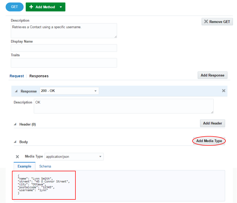

  7. For the 200 response, add some example data.
    Click the Add Media Type button to the right of the Body node.
    Copy and paste the following code into the Example area. The code can be found in the labfiles/code/ContactsExampleGET.txt file.
    "name": "Lynn Smith",
    "street": "45 O Connor Street",
    "city": "Ottawa",
    "postalcode": "12345",
    "username": "lynn"
    Sample chart

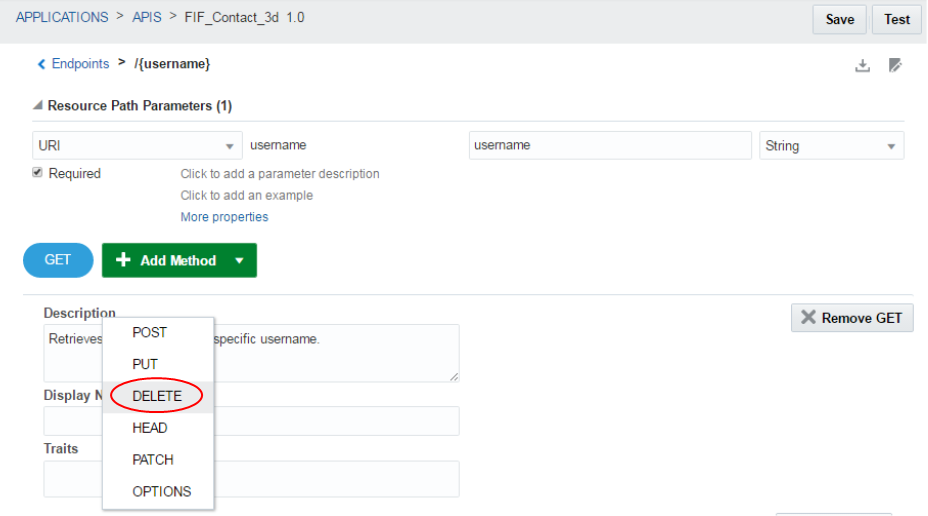

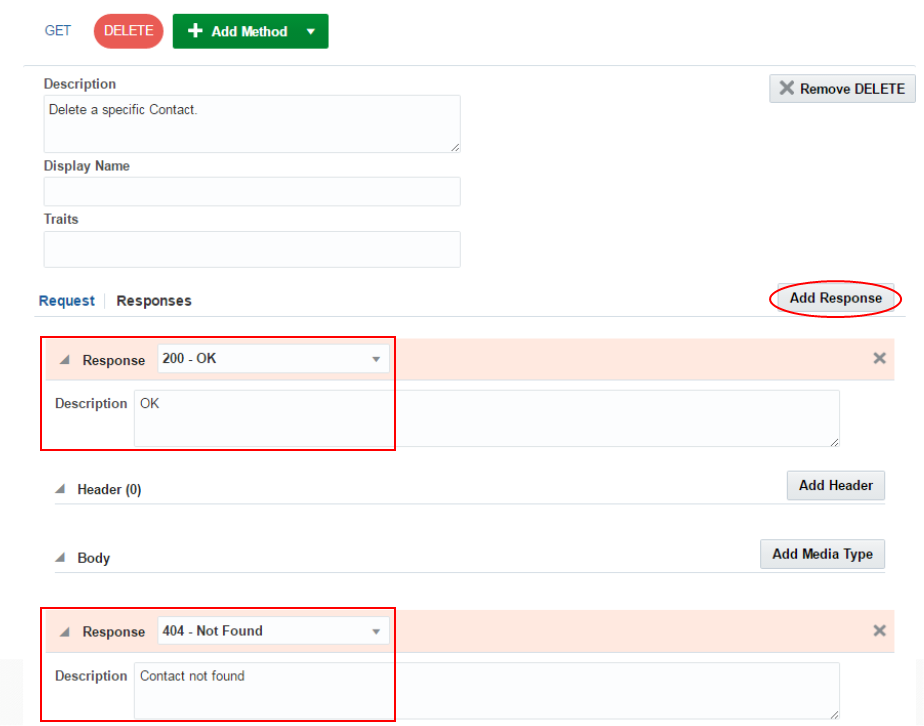

  8. Add a new DELETE method for deleting the contact by username.
    Sample chart
  9. As you did earlier with the GET method, add a description and the following responses:
    200 – OK (for when the request is successful)
    404 – Not Found (for when the username is not found)
    Set the description for the 200 response to OK and set the description for the 404 response to Contact not found.
    Sample chart

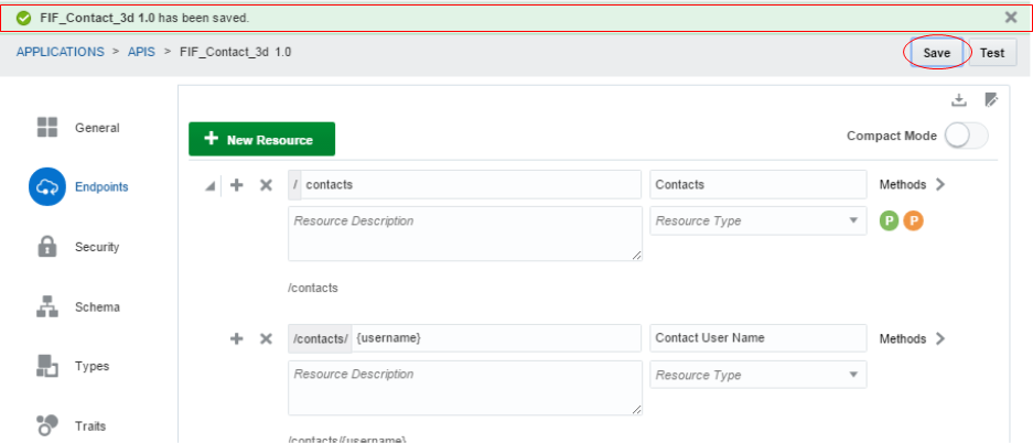

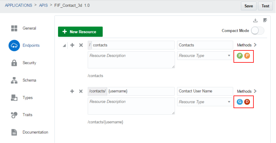

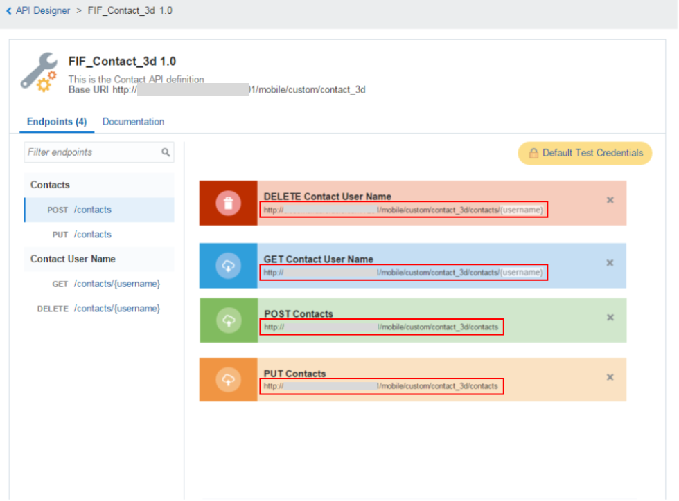

  10. Save your work and then click the Endpoints link.
    Sample chart
    You should see the following resources defined under Endpoints. Notice the colored circles on the right. They represent the methods each endpoint can use.
    Sample chart

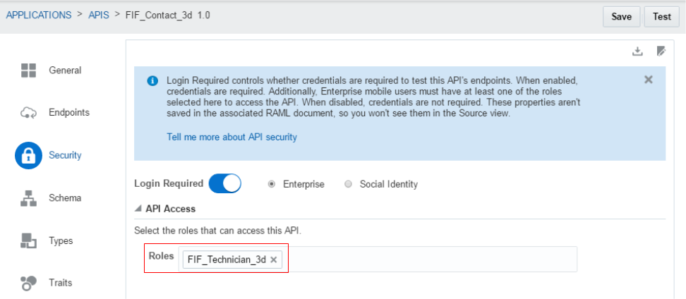

  1. Set up security for the API to control who is allowed to access the API.
    Click the Security tab and add the FIF_Technician_xx role to the list of roles that can access the API.
    Save your work.
    Sample chart

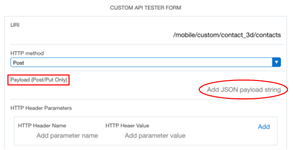

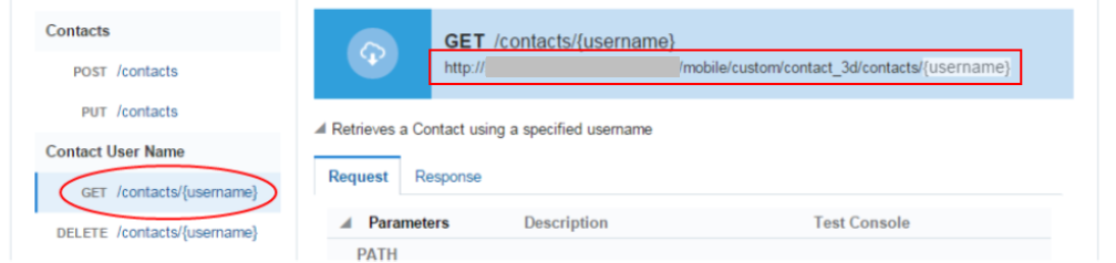

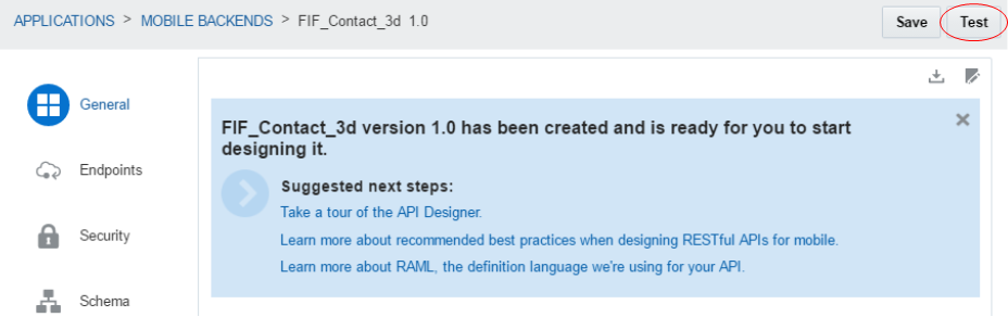

  2. In the next couple of steps, you test the resource.

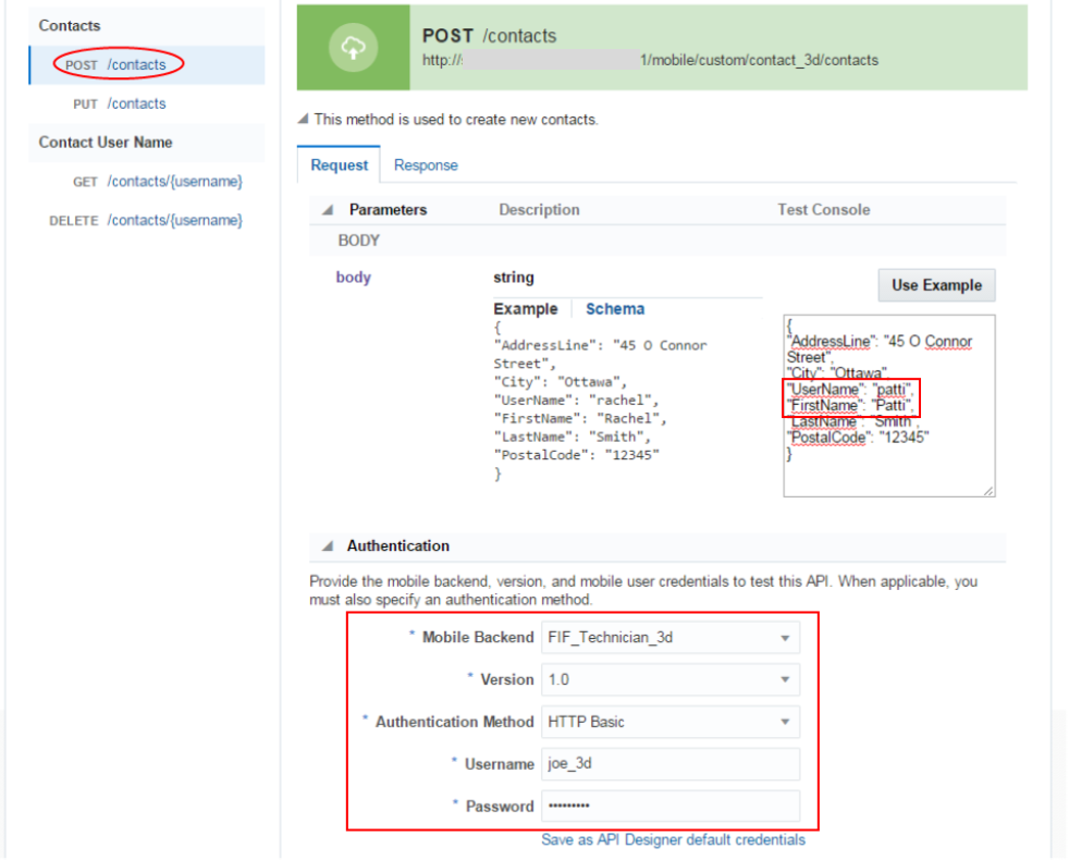

    In the upper right corner, next to the Save button, click the Test button. You navigate to a page where you can see all the method endpoints.
    Sample chart

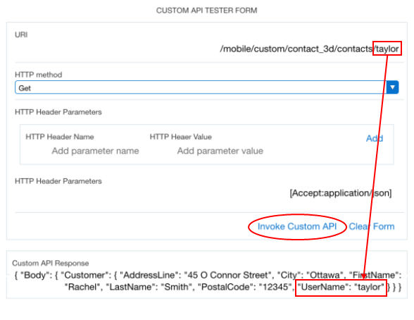

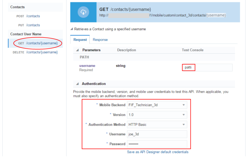

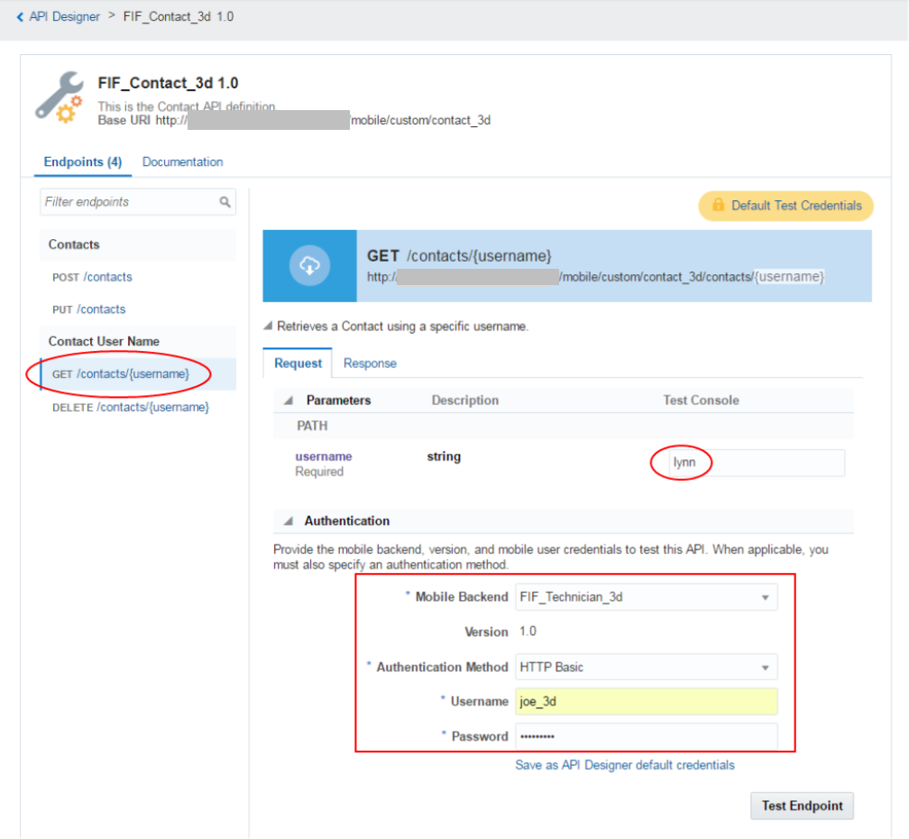

  3. In the left pane, click the GET /contacts/{username} option to navigate to the method details.
    Expand the Parameters node and enter lynn in the Test Console column. Like earlier, if you had real data, the parameter would restrict the records that are returned. Since we only have sample data, that is what is returned.
    In the Authentication node, select your mobile backend, and use 1.0 as the version. Set the Authentication Method to HTTP Basic. Then, use joe_xx as the user and enter the password that you received by email when you created the user.
    Sample chart

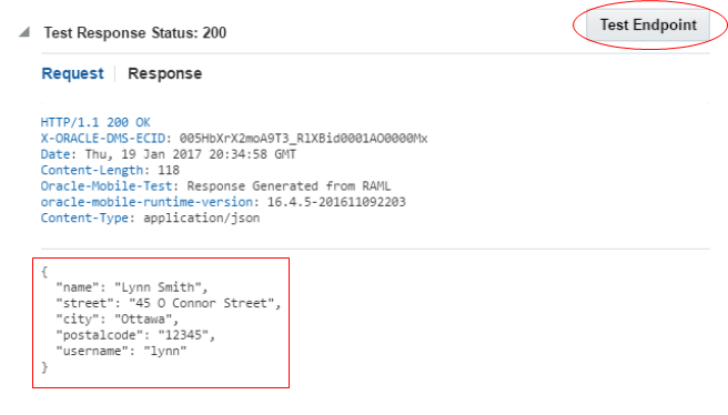

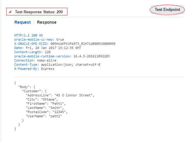

  4. Then click the Test Endpoint button.
    The results are displayed at the bottom of the page and should correspond to the code that you added in the example.
    Sample chart

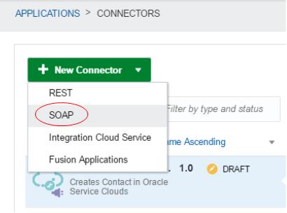

  3. Click New Connector and then select SOAP from the drop-down list.
    Sample chart

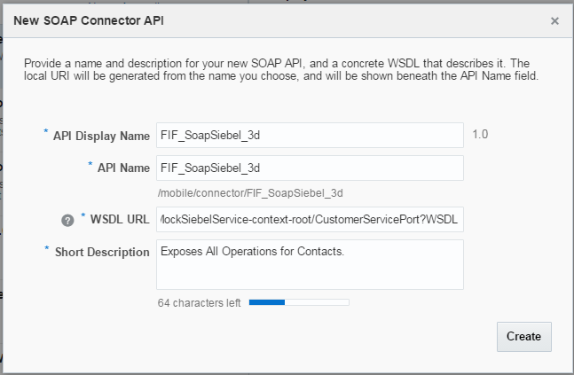

  4. In the New SOAP Connection API dialog box, enter the following values:
    API Display Name: FIF_SoapSiebel_xx (where xx is your initials or a unique value)
    API Name: FIF_SoapSiebel_xx (should be populated based on the value entered for the Display Name)
    WSDL URL: http://160.34.12.218/McsBetaSoapApp-MockSiebelService-context-root/CustomerServicePort?WSDL
    Short Description: Exposes All Operations for Contacts.
    Then click Create.
    Sample chart

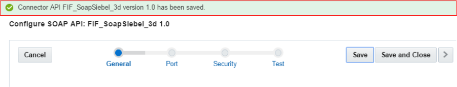

  5. In the Configuration SOAP API wizard, click Save.
    Sample chart

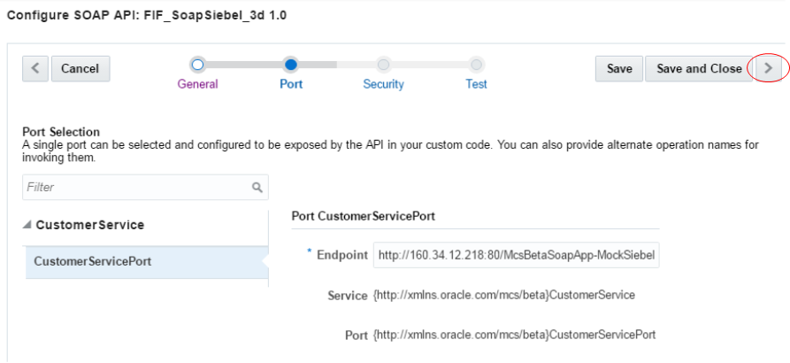

  6. Click the Next arrow to navigate to the Port train stop and observe details about the service operations that are exposed.
    Sample chart

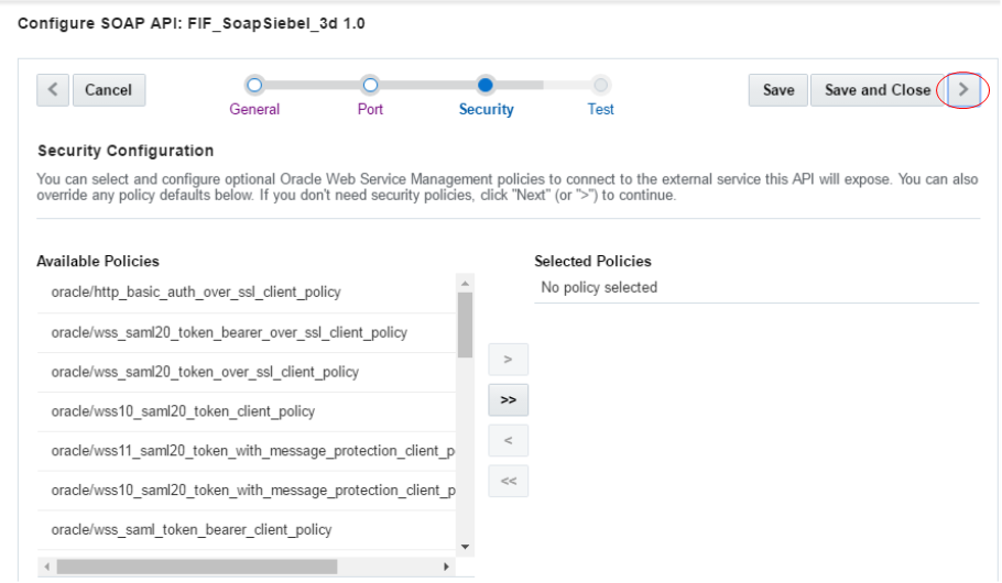

  7. Click the Next arrow to navigate to the Security settings. By default there are no policies selected in the Security Configuration. For our purposes, do not add any policies.
    Sample chart

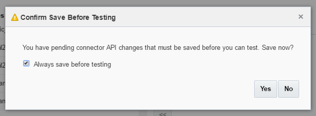

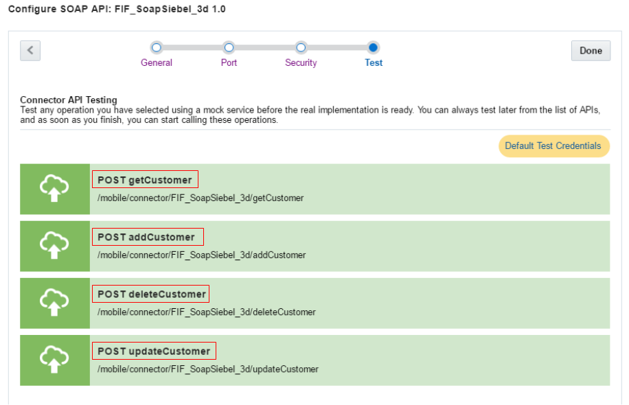

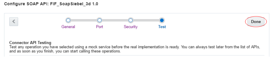

  8. Click the Next arrow to navigate to the Test page. When prompted to save before testing, select the Always save before testing check box and click Yes.
    Sample chart
    In the Test page, scroll down, and you can see all the resource methods that the service makes available.
    Sample chart

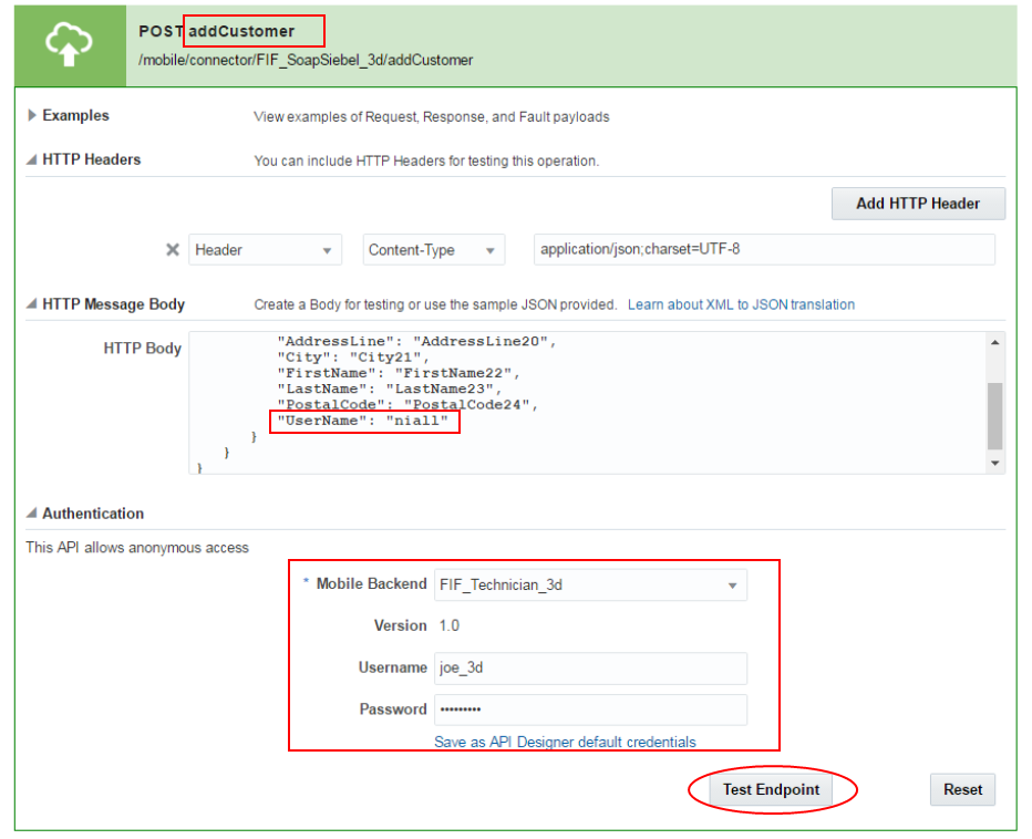

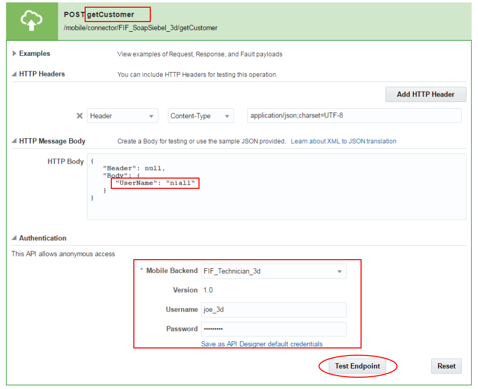

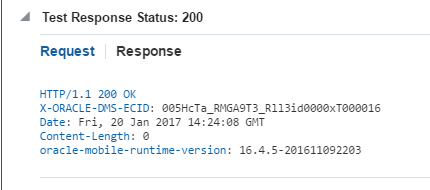

  9. Next, you test a couple of the methods. First use the addCustomer method to create a new contact in the database.
    Scroll down to the POST addCustomer method.
    In the Body, change the username to your name.
    In the Authentication node, select your mobile backend and version. Use joe_xx as the user and enter the password that you received by email when you created the user.

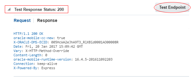

    Then click Test Endpoint.
    Sample chart
  10. The response status should show 200, signifying that a record was created.
    Sample chart

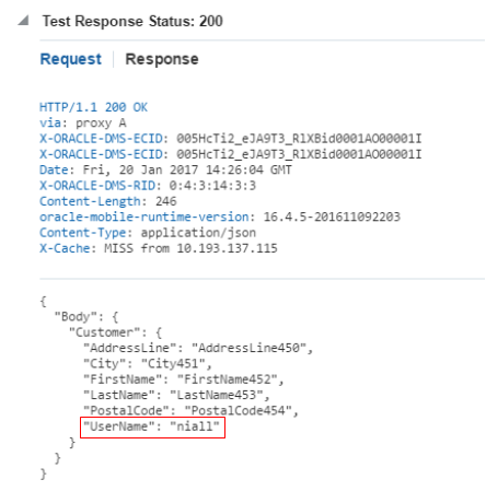

  11. Now you know that you can create a record by using the connector and service. Next, you use the getCustomer method to read the record.
    Scroll back up to the POST getCustomer method and expand it.
    In the Body, set the UserName to the name that you used when you created the customer.
    In the Authentication node, select your mobile backend. Use joe_xx as the user and enter the password that you received by email when you created the user.
    Sample chart
  12. Again, you should see a response status of 200. If you look at the body, you should see the customer that you created with the username that you used.
    Sample chart
  13. Click the Done button in the upper right corner to return to the page where you create connectors.
    Sample chart

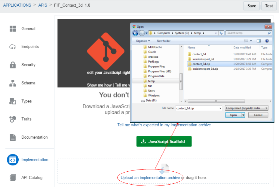

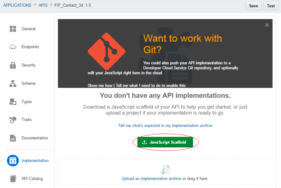

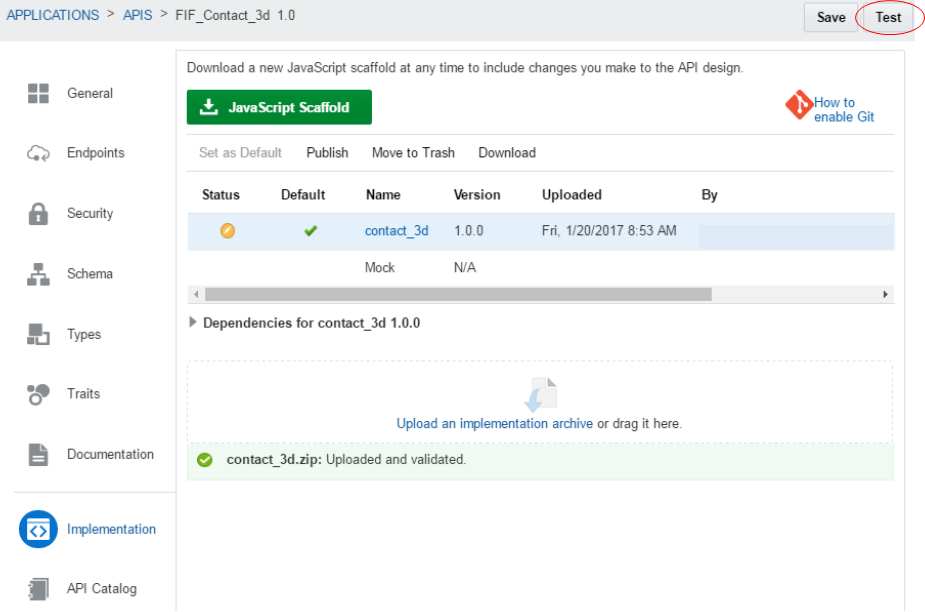

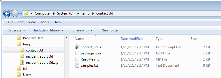

  2. Download a starter set of files.
    In the API Implementation page, click the JavaScript Scaffold button and save the zip file to your hard drive.
    Sample chart

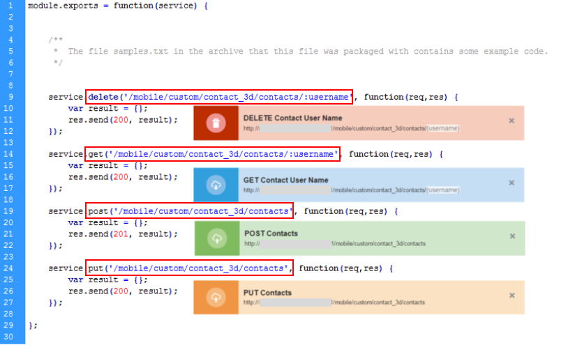

  3. Unzip the file and open your contact_xx.js file in an editor.
    Sample chart

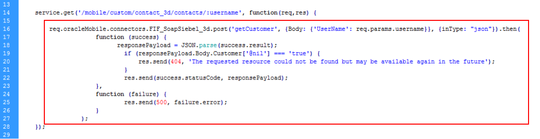

  4. Notice that each method in the contact API is represented in the JavaScript code.
    Sample chart

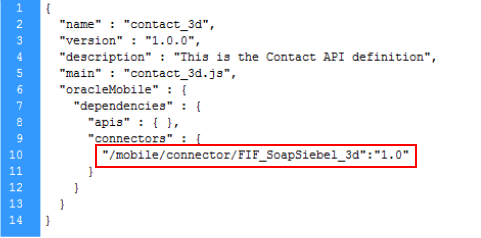

  5. First, add JavaScript code that calls the service to retrieve records. Find the service.get('/mobile/custom/contact_xx/contacts/:username', function(req,res) method.
    Replace the code in the body with the following code. Remember to substitute your unique two-character suffix in the connector name. The code can be found in the labfiles/code/ContactsGETbyUSERNAME.txt file.
    req.oracleMobile.connectors.FIF_SoapSiebel_xx.post('getCustomer', {Body: {'UserName': req.params.username}}, {inType: "json"}).then(
    function (success) {
    var responsePayload = JSON.parse(success.result);
    if (responsePayload.Body.Customer['@nil'] === 'true') {
    res.send(404, 'The requested resource could not be found but may be available again in the future');
    res.send(success.statusCode, responsePayload);
    function (failure) {
    res.send(500, failure.error);
    Sample chart

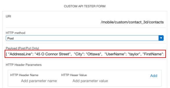

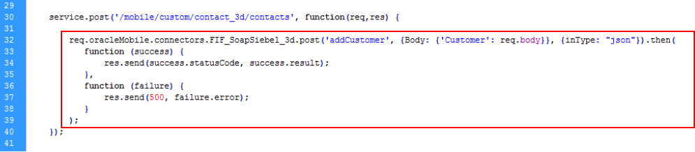

  6. Next, add JavaScript code that calls the service to add records. Find the service.post('/mobile/custom/contact_xx/contacts', function(req,res) method.
    Replace the code in the body with the following code. Remember to substitute your unique two-character suffix in the connector name. The code can be found in the labfiles/code/ContactsPOST.txt file.
    req.oracleMobile.connectors.FIF_SoapSiebel_xx.post('addCustomer', {Body: {'Customer': req.body}}, {inType: "json"}).then(
    res.send(success.statusCode, success.result);
    Sample chart

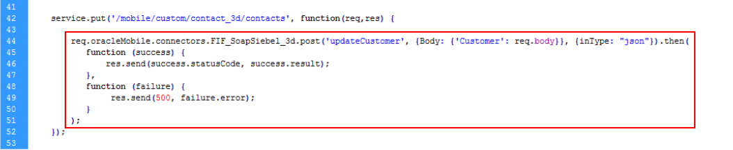

  7. Then, allow records to be updated. Find the service.put('/mobile/custom/contact_xx/contacts', function(req,res) method. Replace the code in the body with the following code. Remember to substitute your unique two-character suffix in the connector name. The code can be found in the labfiles/code/ContactsPUT.txt file.
    req.oracleMobile.connectors.FIF_SoapSiebel_xx.post('updateCustomer', {Body: {'Customer': req.body}}, {inType: "json"}).then(
    Sample chart

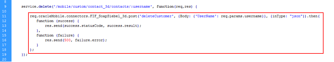

  8. Finally, add JavaScript code that calls the service to delete records. Find the service.delete('/mobile/custom/contact_xx/contacts/:username', function(req,res) method. Replace the code in the body with the following code. Remember to substitute your unique two-character suffix in the connector name. The code can be found in the labfiles/code/ContactsDELETE.txt file.
    req.oracleMobile.connectors.FIF_SoapSiebel_xx.post('deleteCustomer', {Body: {'UserName': req.params.username}}, {inType: "json"}).then(
    Sample chart
  9. Next, set the API to use the SoapSiebel connector. Open the package.json file in an editor and add the following entry for your connector: "/mobile/connector/FIF_SoapSiebel_xx":"1.0"
    Save all your work.
    Sample chart
  10. Zip the new versions of package.json and contact_xx.js to a file.
    Then, back in the API Implementations page, click the Upload an implementation archive button and select the zip file.
    Sample chart
  11. Dismiss the popup message and then click the Test button.
    Sample chart
  12. Test the endpoints. First use the POST/contacts endpoint to create contacts.
    In the left pane, click POST/contacts.
    Populate the request body by clicking the Use Example button.
    Set UserName and FirstName to any name you want (remember it for later).
    Expand the Authentication node and set the following values:
    Mobile Backend: FIF_Technician_xx
    Version: 1.0
    Authentication Method: HTTP Basic
    Username: joe_xx
    Password: Use the password that you received by email when you created the user.
    Sample chart
  13. Then, click the Test Endpoint button and you should see a Response Status of 200, meaning that the record was successfully created.
    Sample chart
  14. Next, use the GET/contacts endpoint to retrieve the record that was created.
    In the left pane, click GET/contacts{username}.
    In the Parameters node, set username to the name that you used when your created the contact.
    Version: 1.0
    Username: joe_xx
    Sample chart
  15. Then, click the Test Endpoint button, and you should see a Response Status of 200, and the record that you just created.
    Sample chart

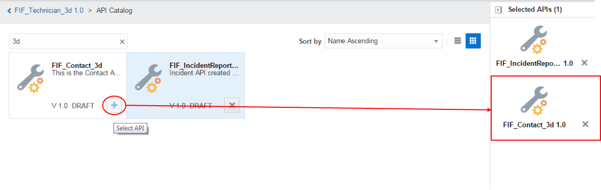

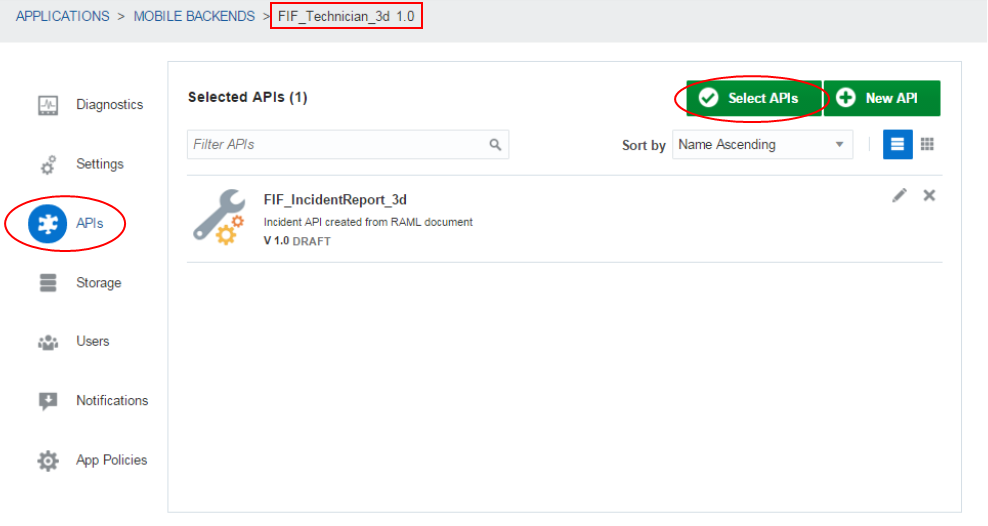

  16. Finally, add the FIF_Contact_xx API to your mobile backend.
    Navigate back to your mobile backend from your DEVELOPMENT menu and then click the APIs icon on the left.
    Click the Select APIs button in the upper right corner to add an API.
    Sample chart
  17. Filter the APIs to find the FIF_Contact_xx API and then click the plus sign icon in the lower right section to add the API to the list.
    Sample chart

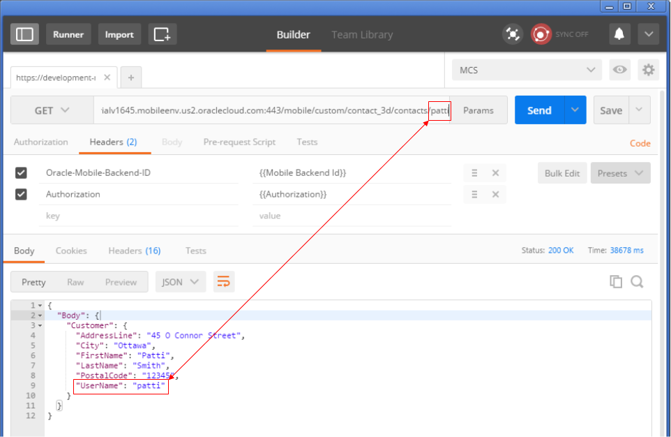

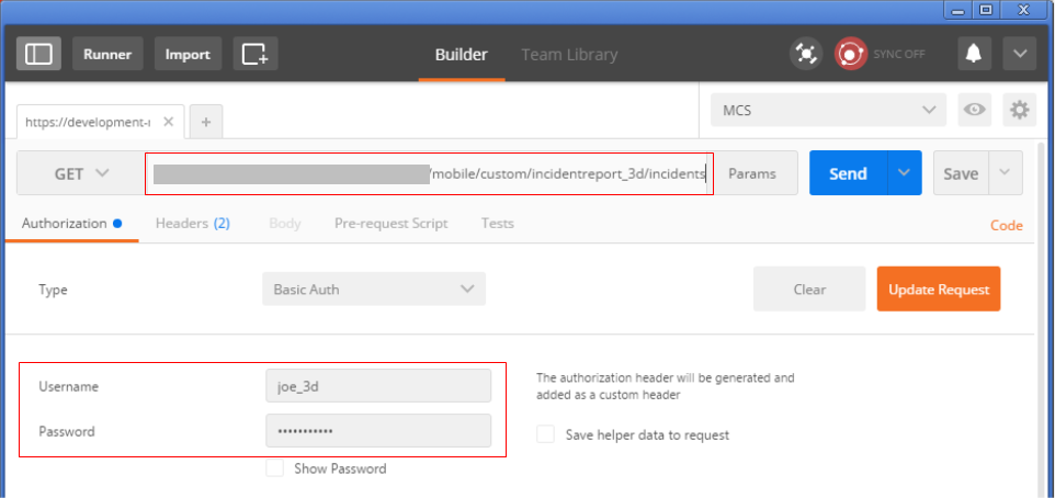

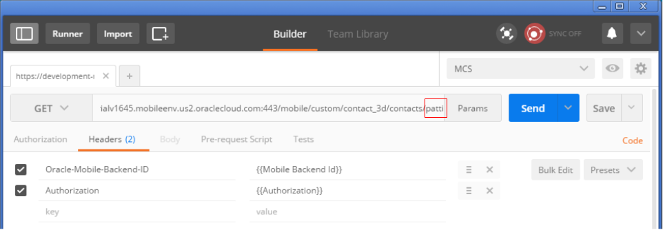

Use Postman
If you are not interested in using the MAF MCS Tester, you can still validate your definitions from outside MCS with Postman. You will be testing with a new URL so the one save earlier in the History section needs to be changed.

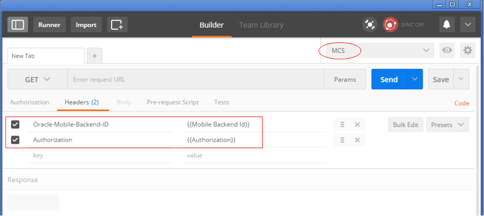

  1. If not already started, start Postman. You can find it in the Chrome App Launcher, either on your desktop or in your tool tray.
    Sample chart
  2. In the upper right of the app, click the down arrow to select an environment. Select the one showing your username, host and identity domain.
    Sample chart
  3. Notice the gray GET label. To the right is where you'll enter the URI used by MCS. If you have tested from Postman before, the History area will show the URL you used earlier. Click it.
    The URL, Authorization and Headers will be populated with the values you used earlier. However, we need to modify the URL to use the contacts API.
    Sample chart
  4. Now, you need to go into MCS to find the correct URL to use.
    First set the URL. You can find this value in MCS.
    Back in MCS, open the FIF_Contact_xx API in the API Designer.
    Then click the Test button.
    Sample chart
  5. Again, like earlier with the incident report, you see all the methods that you can use. Each method has a unique URL that you can use when you test the API.
    Sample chart
  6. Let's work with the URL that we used earlier to find the contact you added.
    Click on the GET /contacts/{username} and copy the full URL.
    Sample chart
  7. Then paste it into the URL property.
    To see the record you created earlier in the MCS Tester, replace the username with the one you used when creating the record. In my case the username was patti.
    Sample chart
  8. Click the Send button and the contact is displayed in the body.
    Sample chart

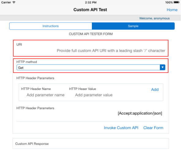

If you want to see how the API works in a mobile application, then continue on and use the MAF MCS Tester.

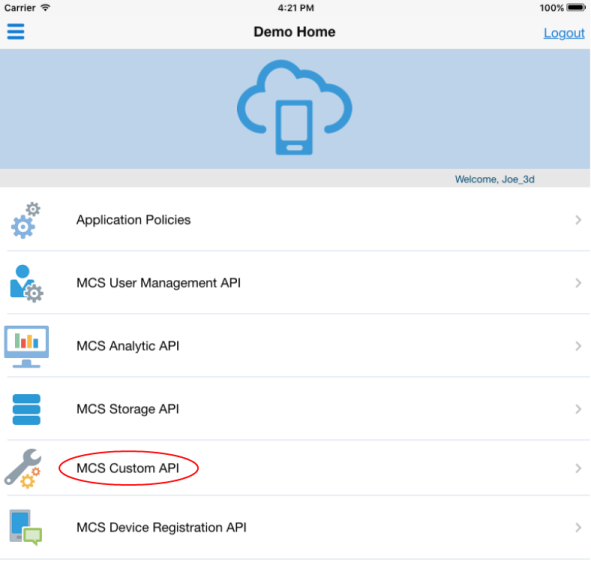

  1. Go back to the MAF MCS Tester Application and navigate to the Home page as shown in the following image.
    You should still be logged in as joe_xx. Then, click the MCS Custom API option.
    Sample chart
  2. Click the Sample tab, and from this page, you can run any API methods that joe_xx is authorized to run.
    Remember, you must set two properties to run the API: URI and HTTP Method.
    Sample chart

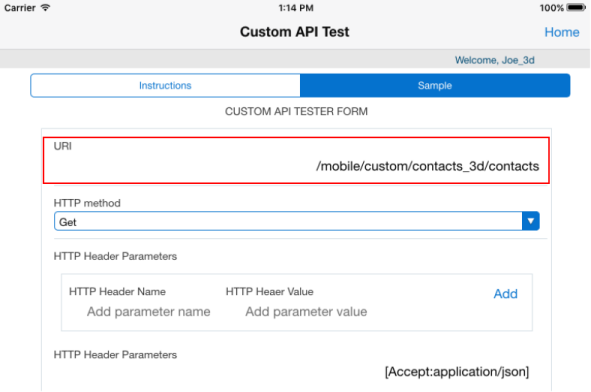

  3. First set the URI. You can find this value in MCS.
    Sample chart
  4. Again, like earlier with the incident report, you see all the methods that you can use. Each method has a unique URL that you can use when you test the API.
    Sample chart
  5. First, you create a new contact and test the POST/contacts method to see the service return a few records from the database.
    Look at the POST/contacts endpoint. The URI that you need to use in the tester consists of everything that follows the port number.
    In the example, the URI is:
    /mobile/custom/contact_3d/contacts
    Sample chart

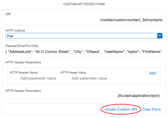

  6. Go back to the MAF MCS Tester Application, and in the CUSTOM API TESTER FORM section, enter that value in the URI field.
    Sample chart

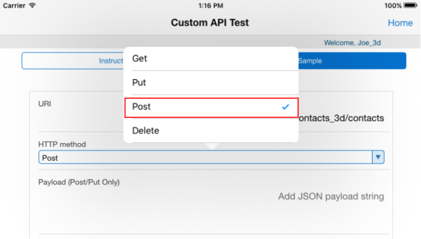

  7. Earlier you set the HTTP Method to retrieve records by using a GET. To create records, you use a POST.
    Set the HTTP Method to POST.
    Sample chart
  8. Finally, you need a contact payload to pass to the API. You have a couple of options for creating the payload. You can follow the procedure that you learned earlier to test the API in MCS and then click the Use Example button to get an example payload (as shown in the following image).
    Sample chart
    Or you can copy the following code: { "AddressLine": "45 O Connor Street", "City": "Ottawa", "UserName": "rachel", "FirstName": "Rachel", "LastName": "Smith", "PostalCode": "12345" }.
  9. Then, in the MAF MCS Tester Application, find the Payload (Post/Put Only) area and click Add JSON payload string.
    Sample chart
    Paste in the example payload that you copied earlier and then change the UserName property in the payload to a value that you will remember.
    Sample chart
  10. Click Invoke Custom API to run the API.
    Sample chart
    There is no confirmation message in the tester, but you should get no error. The only way to know if the record was created is to perform a GET, passing in the username.
  11. Next, you run the GET method to find the record. As you did earlier in the tutorial, you can go back to MCS to get the URI (look at the GET/contacts/{username} endpoint).
    Sample chart
    The URI that you need to use is similar to the one that you used for the POST, except that you need to include the username that you specified in the payload. In the example, the URI is: /mobile/custom/contact_3d/contacts/taylor.
  12. Go back to the MAF MCS Tester Application, and in the CUSTOM API TESTER FORM section, enter that value in the URI property. Make sure that the HTTP method is set to Get.
    Sample chart
  13. Click the Invoke Custom API text to return your record.
    Sample chart
