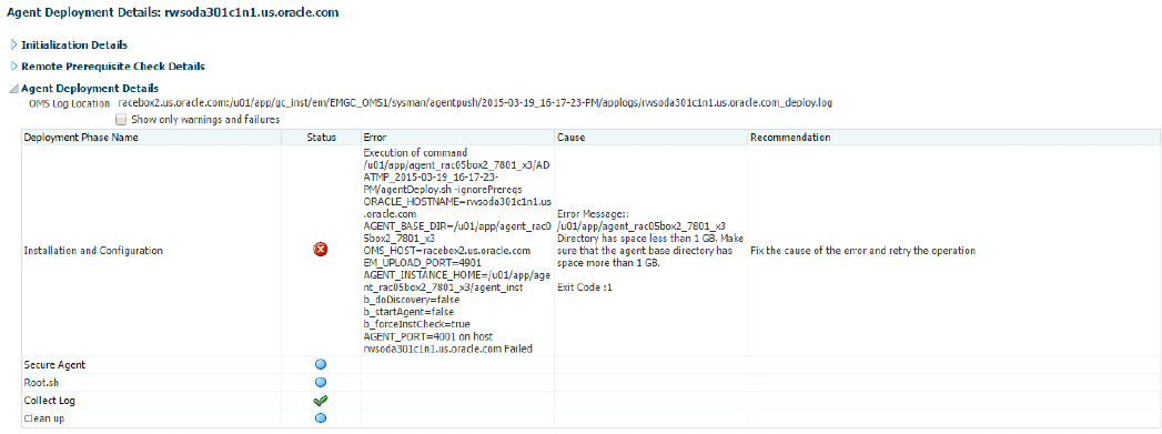

6.1.1 Prerequisite Check Failure

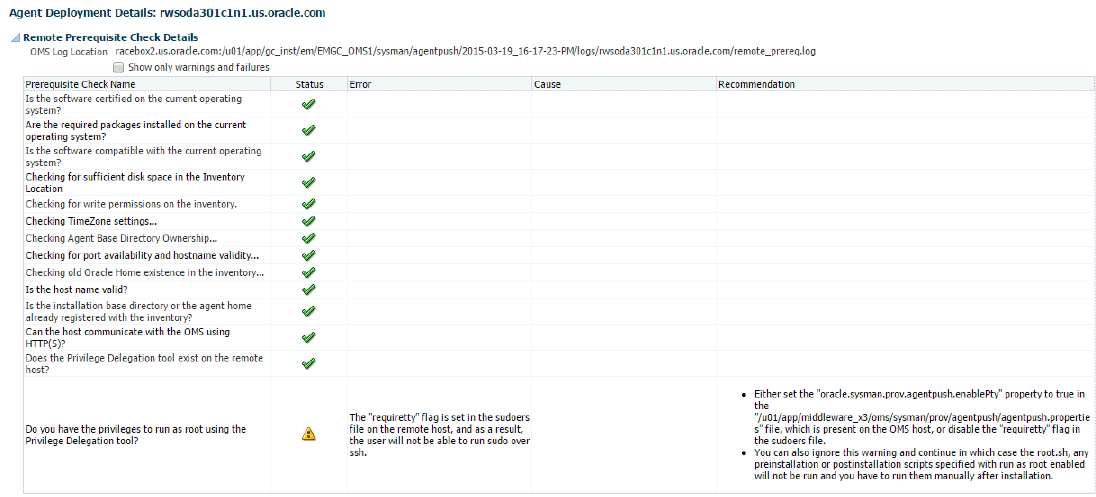

Possible causes for the prerequisite check failure are displayed in the Agent Deployment Details page as shown in the following figure. Recommended solutions are given in the page.
Figure 6-1 Agent Deployment Errors and Solutions
Description of Figure 6-1 follows
Description of ''Figure 6-1 Agent Deployment Errors and Solutions''

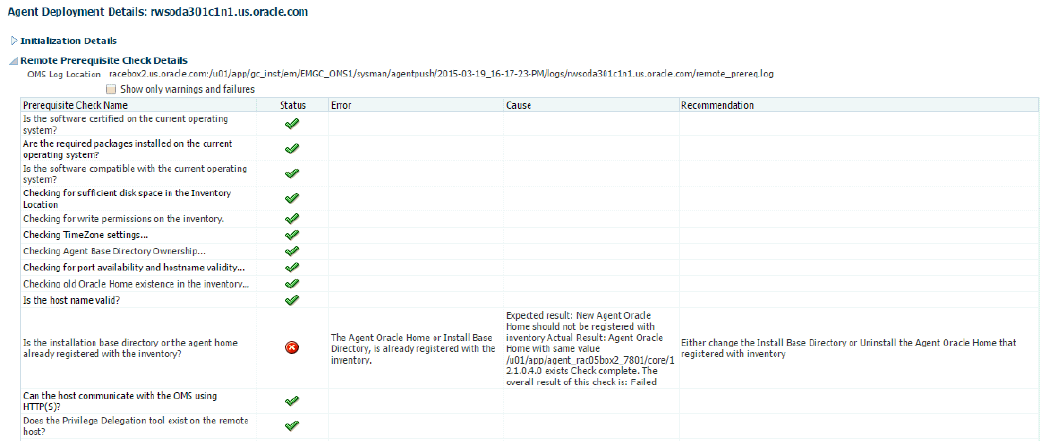

Figure 6-2 Agent Deployment Errors and Solutions
Description of Figure 6-2 follows
Description of ''Figure 6-2 Agent Deployment Errors and Solutions''

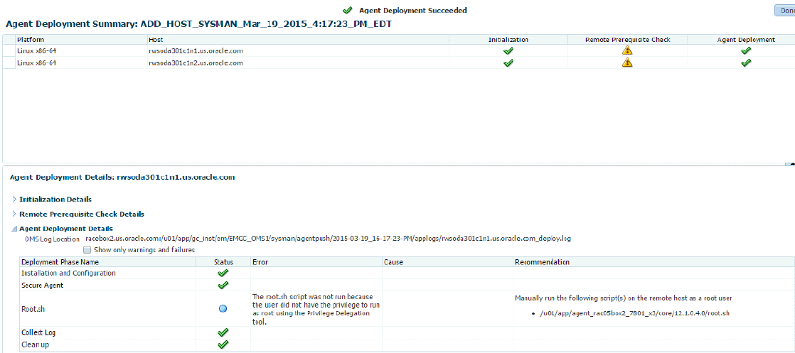

Failure to run root.sh manually results in metric collection failure. The Agent Deployment Details page displays the following:
Figure 6-3 Agent Deployment Errors and Solutions
Description of Figure 6-3 follows
Description of ''Figure 6-3 Agent Deployment Errors and Solutions''
Figure 6-4 Agent Deployment Errors and Solutions
Description of Figure 6-4 follows
Description of ''Figure 6-4 Agent Deployment Errors and Solutions''
If the warning is ignored during the host discovery, the root.sh script that exists on the remote host must be run manually after agent deployment is done.

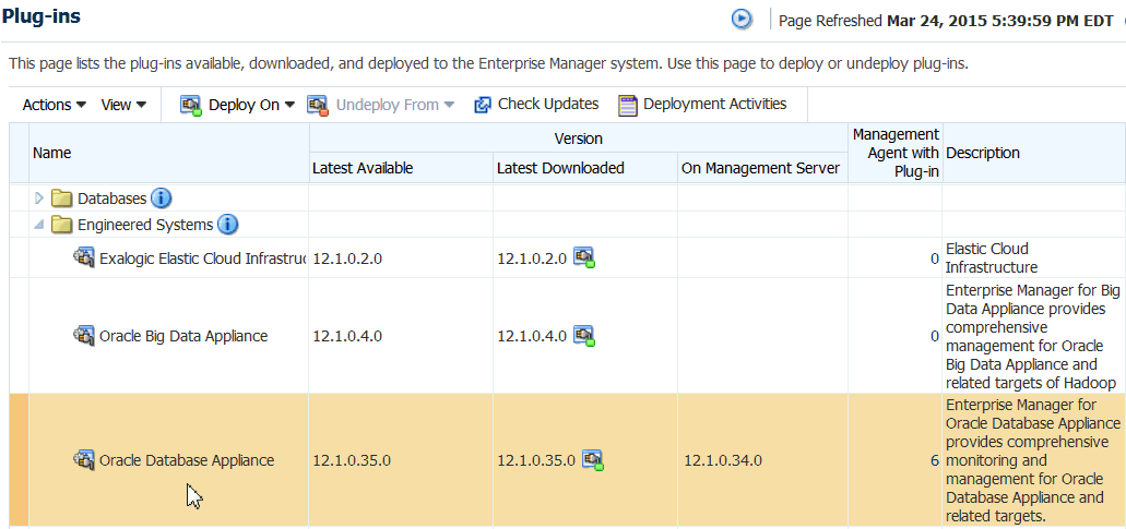

To check the Enterprise Manager Oracle Database Appliance Plug-in versions on the OMS and agents:
  1. Open the Oracle Enterprise Manager Setup menu and select Extensibility, the choose Plug-ins.
  2. On the Plug-ins page expand the Engineered Systems folder and find the Oracle Database Appliance row as shown below.
    Description of trouble_version.gif follows
    Description of the illustration ''trouble_version.gif''
    The Latest Downloaded column shows the version uploaded to Oracle Enterprise Manager repository.
    The On Management Server column shows the plug-in version deployed on the Management Server.
  3. If the value in the Management Agent with Plug-in column is non-zero, click on the number.
    A page opens which lists the agents that have the plug-in, and the Plug-in Version on Management Agent column shows the plug-in version deployed on the agent.

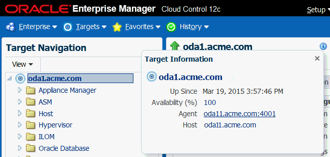

6.5.1 How to Determine Which Node Agent is Monitoring the Oracle Database Appliance Machine
To determine which node agent is monitoring Oracle Database Appliance, click on the information icon next to Oracle Database Appliance machine name in the Oracle Database Appliance Target Navigation page as shown below.
There are many ways to access the page. In this example we start from the Oracle Enterprise Manager Targets menu.
  1. Open the Oracle Enterprise Manager Target menu, and select All Targets.
  2. In the All Targets page, in the navigation tree, find and expand the Engineered Systems category.
  3. Select Oracle Database Appliance System.
  4. Click the information icon next to the Oracle Database Appliance machine name in the target page to display the Agent name.
    Description of trouble_agent.gif follows
    Description of the illustration ''trouble_agent.gif''

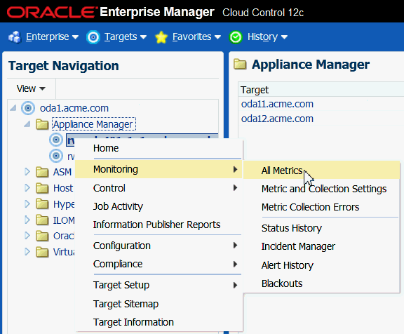

6.5.2 Viewing OAK Metrics
To view OAK metrics:
  1. Right click on an OAK target under Appliance Manager, then select Monitoring, then All Metrics.
    Description of trouble_metrics.gif follows
    Description of the illustration ''trouble_metrics.gif''
  2. Choose a metric to see details.
