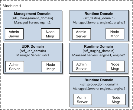

Figure 2-1 shows a simple OCECAS installation topology that consists of one machine with three domains: a management domain, a single runtime domain, and an UDR domain. This topology is useful for demonstration or evaluation purposes, or in cases with limited resources (that is, limited CPU and memory).
Figure 2-1 Simple OCECAS Installation Topology
Description of Figure 2-1 follows
Description of ''Figure 2-1 Simple OCECAS Installation Topology''

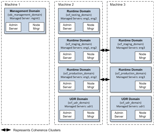

Figure 2-2 shows a fault-tolerant OCECAS installation topology. In this topology, multiple machines are used to host clustered resources.
Figure 2-2 Fault-Tolerant OCECAS Installation Topology
Description of Figure 2-2 follows
Description of ''Figure 2-2 Fault-Tolerant OCECAS Installation Topology''
Table 2-1 describes each element in this topology illustration.
Table 2-1 Description of the Elements in the OCECAS Standard Installation Topology
Element Description and Links to Additional Documentation
OCECAS Domain
A logically related group of Java components (in this case, the Administration Server, managed servers, and other related software components).
For more information, see "Understanding Domains" in Oracle Fusion Middleware Understanding Oracle WebLogic Server.
The central control entity of a domain, which maintains the domain's configuration objects and distributes configuration changes to managed servers.
For more information, see "Administration Server" in Oracle Fusion Middleware Understanding Oracle WebLogic Server.
Cluster
A collection of multiple OCECAS instances running simultaneously and working together.
For more information, see "Managed Servers and Managed Server Clusters" in Oracle Fusion Middleware Understanding Oracle WebLogic Server.
Node Manager
Node Manager is a WebLogic Server utility that enables you to start, shut down, and restart Administration Server and managed server instances from a remote location. Although Node Manager is optional, it is recommended if your WebLogic Server environment hosts applications with high availability requirements.
For more information, see "Running Node Manager as a Startup Service" in Oracle Fusion Middleware Understanding Oracle WebLogic Server.
Machine
A logical representation of the computer that hosts one or more WebLogic Server instances (servers). Machines are also the logical glue between OCECAS managed servers and the Node Manager; to start or stop a managed server with Node Manager, the managed server must be associated with a machine.
Managed Server
The host for your applications, application components, Web services, and their associated resources.
For more information, see "Managed Servers and Managed Server Clusters" in Understanding Oracle WebLogic Server.
