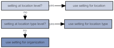

Applying a preference: Set each preference at the lowest level in the hierarchy where it should apply. When determining the preference for an individual location, Order Broker uses the first defined preference it finds, starting at the location level and then working up to the location type level, then finally the organization level. For example, if you set a preference to Not Defined at the location level, the setting at the location type level applies.
Example:
Required result: All US stores should use proximity locator logic except for the Natick store. The US store locations are assigned to the location type of US Store.
Correct preference settings: Set Use Proximity Locator for US Stores to Yes, but set it to No for the Natick store location only.
Important:                            You need to set all preferences at the organization level before integrating any external systems with Order Broker. If you leave any of the preferences at this level set to blank, there will be errors when you attempt to begin processing messages between Order Broker and any system that uses the organization.

•         The Use Proximity Locator, No Offline Response Action, and Fulfillment tab settings at the location type level apply to locations of that type unless they are overridden at the location level. These settings override any settings at the organization level.
•         If a setting is set to Not Defined at the location type level, the organization-level setting applies.

•         The Use Proximity Locator, No Offline Response Action, and Fulfillment tab settings at the location level apply to the selected location and override any settings at the location type or organization level.
•         If a setting is set to Not Defined at the location level, the location type-level setting, if any, applies; otherwise, if the setting is set to Not Defined at the location-type level, the organization-level setting applies.
