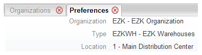

Heading information
The information displayed at the top of the screen varies depending on whether you are working with preferences for a specific location or location type, or for the organization itself.
Organization
When you first advance to this screen, the location hierarchy is collapsed to the level of the organization you selected at the Organizations and Preferences screen. The organization code is separated from the organization description by a hyphen (-).
See review preferences at a specific level for more information on how to work with preferences for an organization.

Type
When you highlight a location type in the left-hand pane, its code and name are displayed at the top of the screen.

Location
When you highlight a location in the left-hand pane, its code and description are displayed at the top of the screen.
