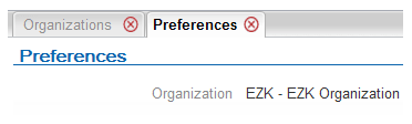

1. When you first advance to this screen, it displays the preferences at the level of the organization you selected at the Organizations and Preferences screen.

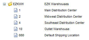

2. Click the plus sign next to the organization in the left-hand pane to display each location type for the organization if they are not already visible.
3. Location-type-level preferences: You can display the preferences for a location type by highlighting the location type name in the left-hand pane. 4. Click the plus sign next to a location type in the left-hand pane to display each location for the type.

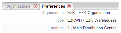

5. Location-level preferences: You can display the preferences for a location by highlighting the location name in the left-hand pane. If you click the name of a location type or an organization in the left-hand pane, the tree-structure collapses to that level. For example, if you click the name of an organization while it is expanded to show location types, it collapses back to the organization level. Note: The hierarchy may not be displayed correctly until you assign a default shipping system to the default admin user. See Assign the default shipping system to the default user for more information. |

Organization |
When you first advance to this screen, the location hierarchy is collapsed to the level of the organization you selected at the Organizations and Preferences screen. The organization code is separated from the organization description by a hyphen (-).
See review preferences at a specific level for more information on how to work with preferences for an organization. Settings at the organization level: • The Use Probability Rules and Order Broker Settings are available at the organization level only. • The remaining preferences are Use Proximity Locator, No Offline Response Action, and tab settings: Fulfillment tab, Standard Brokering tab, and Weighted Brokering tab. These preferences are available at all levels (organization, location type, and location); however, the organization-level settings apply if you do not set these preferences at the location type level or the location level. Important: You should set all preferences at the organization level in order to avoid unpredictable results. |

Location |
When you highlight a location in the left-hand pane, its code and description are displayed at the top of the screen.
Settings at the location level: • The Use Proximity Locator, No Offline Response Action, and Fulfillment tab settings at the location level apply to the selected location and override any settings at the location type or organization level. • If a setting is set to Not Defined at the location level, the location type-level setting, if any, applies; otherwise, if the setting is set to Not Defined at the location-type level, the organization-level setting applies. See review preferences at a specific level for more information on how to work with preferences for a location type. |
