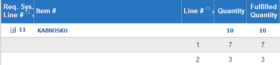

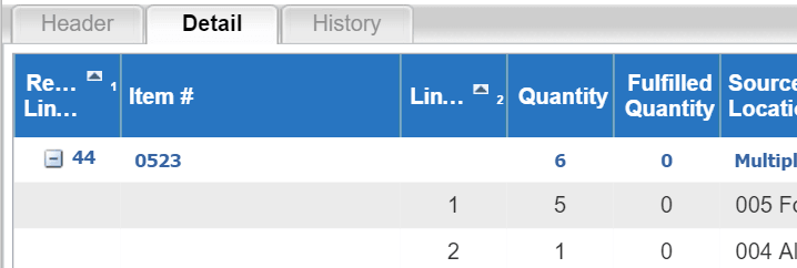

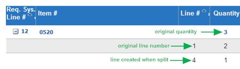

Is line split? Provided the Allow Split Order preference is selected, a line can split if: • the Allow Split Line preference is selected, and the Routing Engine split a line when initially creating a retail pickup or delivery order, or after the line was rejected by an assigned location; or, • the Allow Partial Updates preference is selected, and the Routing Engine received a status update for a quantity lower than the current line quantity. Even if your preferences support splitting lines or partial status update, this does not necessarily mean that the lines on an order will split. Split lines at Details tab: If any line on the order is split, you need to expand the requesting system line number at the Details tab in order to see and work with the details for all lines and see additional options:
Non-split lines at Details tab: If none of the lines on the order are not split, the details and options are displayed when you open the Details tab:

The line number identifying the order line in the requesting location. From the line_item_no passed in the submit order message. A single line from the requesting system can create multiple order lines in Order Broker if the Allow Split Line preference is selected. Also, a line can split as the result of a partial status update if the Allow Partial Updates preference is selected. Even if a line is not split in Order Broker, the requesting system line number can be different from the line number in Order Broker. For example, this situation can occur if the placed (originating) location sends only the third line on a multi-line order to Order Broker; in this case, the line number in Order Broker is #1. If split: If any lines on the order are split, you need to expand the line to see additional details and options. Click the plus sign next to the requesting system line number to expand:
The order line number assigned by Order Broker. May be different from the requesting system’s line number if the system did not send all of the order lines to Order Broker for fulfillment and the version specified in the submit order message was lower than 3.0, or if an order line is split. If split: If any of the lines on the order are split, the Item # is before the Order Broker Line # and is always displayed, even if you have not expanded the line by clicking the plus sign next to the Req. Sys. Line # (Requesting system line number); however, the Line # and other fields are not displayed until you click the plus sign. Examples of line splitting: • Split by the Routing Engine: • The Routing Engine assigns the order to location A, and then Location A rejects the order • The Routing Engine then assigns half the quantity to location B, and half to location C. Result: the quantity in location B is now line #1; the quantity in location C is now line #2 • Partial status update: The entire quantity of 5 was originally assigned to location A, but location A rejected 3 units. Result: the quantity in location A is now line #1; the rejected quantity, now reassigned or unfulfillable, is now line #2 |
Different line numbers even if not split: It is possible for the Order Broker line number and requesting system line number to differ if, for example, the requesting system sends line 3 of a multi-line order to Order Broker (requesting system line number); when the Routing Engine creates the order, it assigns a line number of 1 because it is the only order line received from the requesting system. Line numbers might not be consecutive: If the Routing Engine splits a line or receives a partial status update, the line numbers assigned in Order Broker to the resulting split lines might not be consecutive. For example, a system sends 3 lines, which produce lines 1, 2, and 3. Subsequently, the Routing Engine receives a partial update for line 1 and creates line 4 for the quantity in the updated status. If not split: If none of the lines on the order are split, just a single line number is displayed. |

Quantity |
Original quantity: If the line is split, the quantity displayed on the first line without a current line number is the quantity of the item that was originally assigned to the Fulfilling Location or Sourced Location. This quantity might differ from the quantity originally submitted to Order Broker if the Allow Split Line preference is selected, and the Routing Engine initially split the line across multiple fulfilling or sourcing locations. Also, the original quantity in Order Broker might subsequently be split across multiple order lines in Order Broker if the original fulfilling or sourcing location rejects the assignment and the Routing Engine splits the line when it reassigns it, or if a location submits a partial status update. Current quantity: The quantity that is currently assigned to the fulfilling, sourcing, or pickup location. This quantity might be different from the original quantity if the Allow Split Line preference is selected, and the Routing Engine split the line across multiple fulfilling or sourcing locations after it was initially rejected by the first location, or if a location submits a partial status update. Not split: If the line is not split, the original and current quantities are the same. If none of the lines on the order are split, then just a single quantity is displayed. |
Fulfilled Quantity |
The quantity of the item shipped to the customer (delivery order) or picked up by the customer pickup order, retail pickup order, ship-to-store order, or ship-for-pickup order). Updated when the Routing Engine receives a status update message indicating that the new order, line, or quantity status is fulfilled. If split: The total fulfilled quantity is displayed at the summary level for the line, and the fulfilled quantity for each current line number is listed below with the current line. |
The fulfilling location that was most currently assigned to fulfill the item. Displayed only if the order is not a ship-for-pickup order. If split: If the line is currently split across multiple fulfilling locations, the word Multiple is displayed at the summary level. You can expand the line to review all assigned locations by clicking the plus sign to the left. Update? You can update the fulfilling location for a line if the Order Maintenance flag in your user profile is selected and the Allow Split Order preference is selected. See Edit Order Item for more information. |
The sourcing location that was most currently assigned to source the item for a ship-for-pickup order order. If split: If the line is currently split across multiple sourcing locations, the word Multiple is displayed at the summary level. You can expand the line to review all assigned locations by clicking the plus sign to the left. Update? You can update the sourcing location for a line if the Order Maintenance flag in your user profile is selected and the Allow Split Order preference is selected. See Edit Order Item for more information. |

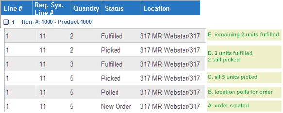

This tab displays the status history for each line on the order, created whenever a line is: • created, or • assigned or reassigned to a fulfilling or sourcing location, or • when its status changes for any other reason, or • when its shipping address is updated, or • when there is an update to the Under Review indicator • when a store associate closes an item on a ship-to-store order (the status changes to canceled) • when the Pickup By Date is assigned, changed, or removed • when the customer data is anonymized through the Completed Order Private Data Purge job or through the ForgetPrivateData web service request • when an order status update request message attempted to change the status of a canceled order line, but the change was rejected because the Restrict Reassignment of Canceled Line preference was selected The History tab lists records for each item in reverse chronological order (newest to oldest). A single transaction can create multiple history records if the transaction splits the line due to a partial status update or reassignment of a rejected order to multiple fulfilling locations. Optionally, you can collapse the history for an item by clicking the box next to the line number.
Note: Status history and changes to the Under Review indicator are tracked at the line level even if the organization does not split orders or order lines. |

The current line number at the time the activity took place. This number might differ from the current line number if the Routing Engine split the line after initial creation in Order Broker because the original fulfilling location rejected it. Which line number? The status history entry always lists the line number referenced in the status update request, even if the status update creates a new line number. Example: Line 10 currently includes 5 units in picked status. A partial status update indicates to change the status of 3 units on the line to fulfilled status. This update changes the quantity of line 10 to 2, and creates a new line, line 11, for 3 units in fulfilled status. However, both status history entries list line number 10, since that was the line number referenced in the status update request. The Routing Engine does not write a separate status history record for the creation of line 11. Under Review update: An update to the Under Review indicator creates a history record for each line on the order. Pickup By Date update: An update to the Pickup By Date creates a history record. For more information: See the Line # for an example of how the Routing Engine might track the same order line using different line numbers. |
Requesting System Line Number |
The line number identifying the order line in the requesting location. From the line_item_no passed in the submit order message. A single line from the requesting system can create multiple order lines in Order Broker if the Allow Split Line preference is selected. |
Quantity |
The order line quantity at the time the activity took place. Might differ from the current quantity if the line was rejected by the original fulfilling or sourcing location and split by the Routing Engine at reassignment, or if the transaction was a partial status update. |
The status as a result of the activity indicated. The status might be unchanged if, for example, the order line was currently in canceled status, and the Restrict Reassignment of Canceled Line preference was selected. See Order and Line Statuses. Note: When an order is rejected and it cannot be reassigned and, as a result, the Routing Engine changes its status to unfulfillable, 2 history records are written: 1 for the rejected status, and 1 for the unfulfillable status. Under Review update: An update to the Under Review indicator creates a history record using the order-level status, even if the status of an individual line is different; however, this update does not affect the actual status of individual lines. Example: An order includes a line in polled status and a line in new order status, so the status of the order is open. You update the Under Review indicator for the order. The history record indicates a status of open on both lines, although the status of the polled and new order lines does not change. |
