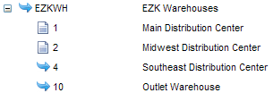

by default. A blue arrow ( ![]() 2. Optionally, click the plus sign next to the organization to display each Location Type for the organization if they are not already displayed. Again, a blue arrow next to the location type name indicates if there are any rules assigned at any level within the location type. ![]() |
3. Optionally, click the plus sign next to a location type to display each Location for the type if they are not already displayed. A blue arrow next to a location indicates if there are any rules assigned to that particular location. ![]() Sort order: This screen sorts all displayed records in alphanumeric order within each organization. In other words, organizations are listed alphanumerically by name, as are location types within an organization, and locations within a location type. Since the sort is alphanumeric, numeric codes are listed before alphabetical codes; for example, location 123 is listed before location ABC. Note: The hierarchy may not be displayed correctly until you assign a default shipping system to the default admin user. See Assign the default shipping system to the default user for more information. |
