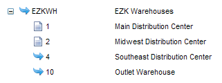

1.      The organization associated with your Default Shipping System is selected by default. A blue arrow (rule_assigned_icon.png) next to the organization name indicates if there are any rules assigned at any level within the organization. Optionally, you can select a different organization.
2.      Optionally, click the plus sign next to the organization to display each Location Type for the organization if they are not already displayed. Again, a blue arrow next to the location type name indicates if there are any rules assigned at any level within the location type.
3.      Optionally, click the plus sign next to a location type to display each Location for the type if they are not already displayed. A blue arrow next to a location indicates if there are any rules assigned to that particular location.

Rule assigned? A blue arrow (rule_assigned_icon.png) next to the organization, location type, or location indicates if there are any probable quantity rules assigned at the location type or location level.
Note:  To refresh the display of the blue arrows based on your activity at this screen, close the Probable Quantity Location screen and re-enter.
