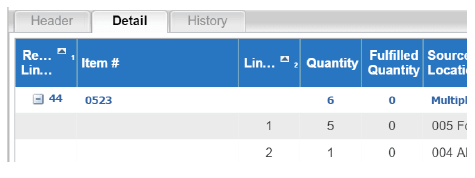

Click the Details tab.

Line split? If the line is split, this icon is available only after you click the plus sign for the requesting system line number to display additional fields and options:

Click the edit/display icon (edit_icon.png) for an item on the Details tab to advance to the Edit Order Item window if you have Order Maintenance authority and the Allow Split Order preference is selected; otherwise, the Browse Order Item window opens. See below for a discussion of maintenance options.

Details tab
Is line split? Provided the Allow Split Order preference is selected, a line can split if:
•         the Allow Split Line preference is selected, and the Routing Engine split a line when initially creating a retail pickup or delivery order, or after the line was rejected by an assigned location; or,
•         the Allow Partial Updates preference is selected, and the Routing Engine received a status update for a quantity lower than the current line quantity.
Even if your preferences support splitting lines or partial status update, this does not necessarily mean that the lines on an order will split.
Split lines at Details tab: If any line on the order is split, you need to expand the requesting system line number at the Details tab in order to see and work with the details for all lines and see additional options:
Non-split lines at Details tab: If none of the lines on the order are not split, the details and options are displayed when you open the Details tab:
For more information: See Selecting a Location for a Delivery or Retail Pickup Order for some of the different scenarios that are possible in creating or updating detail lines on retail pickup or delivery orders if you have Order Broker configured to split orders or order lines. Also, see Updating Order Status at the Line or Unit Level for an overview on processing partial status updates for order lines.
Req. Sys. Line # (Requesting system line number)
The line number identifying the order line in the requesting location. From the line_item_no passed in the submit order message. A single line from the requesting system can create multiple order lines in Order Broker if the Allow Split Line preference is selected. Also, a line can split as the result of a partial status update if the Allow Partial Updates preference is selected.
Even if a line is not split in Order Broker, the requesting system line number can be different from the line number in Order Broker. For example, this situation can occur if the placed (originating) location sends only the third line on a multi-line order to Order Broker; in this case, the line number in Order Broker is #1.
If split: If any lines on the order are split, you need to expand the line to see additional details and options. Click the plus sign next to the requesting system line number to expand:
Line #
The order line number assigned by Order Broker. May be different from the requesting system’s line number if the system did not send all of the order lines to Order Broker for fulfillment and the version specified in the submit order message was lower than 3.0, or if an order line is split.
If split: If any of the lines on the order are split, the Item # is before the Order Broker Line # and is always displayed, even if you have not expanded the line by clicking the plus sign next to the Req. Sys. Line # (Requesting system line number); however, the Line # and other fields are not displayed until you click the plus sign.
Examples of line splitting:
•         Split by the Routing Engine:
•         The Routing Engine assigns the order to location A, and then Location A rejects the order
•         The Routing Engine then assigns half the quantity to location B, and half to location C. Result: the quantity in location B is now line #1; the quantity in location C is now line #2
•         Partial status update: The entire quantity of 5 was originally assigned to location A, but location A rejected 3 units. Result: the quantity in location A is now line #1; the rejected quantity, now reassigned or unfulfillable, is now line #2
Different line numbers even if not split: It is possible for the Order Broker line number and requesting system line number to differ if, for example, the requesting system sends line 3 of a multi-line order to Order Broker (requesting system line number); when the Routing Engine creates the order, it assigns a line number of 1 because it is the only order line received from the requesting system.
Line numbers might not be consecutive: If the Routing Engine splits a line or receives a partial status update, the line numbers assigned in Order Broker to the resulting split lines might not be consecutive. For example, a system sends 3 lines, which produce lines 1, 2, and 3. Subsequently, the Routing Engine receives a partial update for line 1 and creates line 4 for the quantity in the updated status.
If not split: If none of the lines on the order are split, just a single line number is displayed.
Item #
The system product code for the user’s Default Shipping System. If the user’s Default Shipping System is not in the organization associated with the order, the system product code for the fulfilling location is displayed. Up to 26 positions.
If split: If any of the lines on the order are split, the Item # is before the Order Broker Line # and is always displayed, even if you have not expanded the line by clicking the plus sign next to the Req. Sys. Line # (Requesting system line number).
No item #? If your user ID is not assigned a Default Shipping System at the User Profile Configuration screen, the Item # might not be displayed here.
Note:  You can display the item description by moving your cursor over the item code.
Quantity
Original quantity: If the line is split, the quantity displayed on the first line without a current line number is the quantity of the item that was originally assigned to the Fulfilling Location or Sourced Location. This quantity might differ from the quantity originally submitted to Order Broker if the Allow Split Line preference is selected, and the Routing Engine initially split the line across multiple fulfilling or sourcing locations. Also, the original quantity in Order Broker might subsequently be split across multiple order lines in Order Broker if the original fulfilling or sourcing location rejects the assignment and the Routing Engine splits the line when it reassigns it, or if a location submits a partial status update.
Current quantity: The quantity that is currently assigned to the fulfilling, sourcing, or pickup location. This quantity might be different from the original quantity if the Allow Split Line preference is selected, and the Routing Engine split the line across multiple fulfilling or sourcing locations after it was initially rejected by the first location, or if a location submits a partial status update.
Not split: If the line is not split, the original and current quantities are the same. If none of the lines on the order are split, then just a single quantity is displayed.
Fulfilled Quantity
The quantity of the item shipped to the customer (delivery order) or picked up by the customer pickup order, retail pickup order, ship-to-store order, or ship-for-pickup order). Updated when the Routing Engine receives a status update message indicating that the new order, line, or quantity status is fulfilled.
If split: The total fulfilled quantity is displayed at the summary level for the line, and the fulfilled quantity for each current line number is listed below with the current line.
Fulfilling Location
The fulfilling location that was most currently assigned to fulfill the item. Displayed only if the order is not a ship-for-pickup order.
If split: If the line is currently split across multiple fulfilling locations, the word Multiple is displayed at the summary level. You can expand the line to review all assigned locations by clicking the plus sign to the left.
Update? You can update the fulfilling location for a line if the Order Maintenance flag in your user profile is selected and the Allow Split Order preference is selected. See Edit Order Item for more information.
Sourced Location
The sourcing location that was most currently assigned to source the item for a ship-for-pickup order order.
If split: If the line is currently split across multiple sourcing locations, the word Multiple is displayed at the summary level. You can expand the line to review all assigned locations by clicking the plus sign to the left.
Update? You can update the sourcing location for a line if the Order Maintenance flag in your user profile is selected and the Allow Split Order preference is selected. See Edit Order Item for more information.
Pickup Location
The pickup location for a ship-for-pickup order order.
Line Status
See Order and Line Statuses.
Update? You can update the line status if the Order Maintenance flag in your user profile is selected and the Allow Split Order preference for an organization is selected. If the Allow Partial Updates preference is selected, you can also specify a partial quantity to update with the new status. See Edit Order Item for more information.
Status Date
The last date and time when the status of the order changed.
When a ship-to-store order in picked or intransit status is flagged as polled, the Routing Engine does not change the current status of the order, so the Status Date does not change.
System Products
Click the system products icon (systems_icon.png) to open the System Products window, listing the system products for the item.
