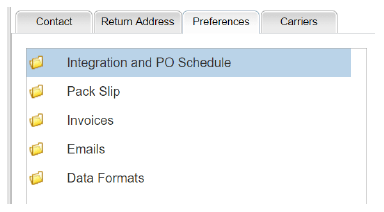

Preferences tab
Each vendor preference category is available by clicking the folder in the left-hand tab.
