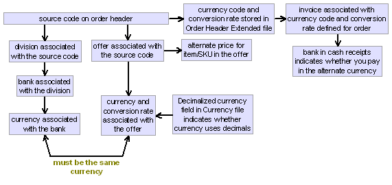

Relationships: This flowchart explains the relationships that exist when you use alternate currency pricing.
Currency of Offer
For each offer, you can define the currency of the offer and the conversion rate. If the offer is for the local currency, you do not need to define the currency code and conversion rate.
Note: When you use alternate currency pricing, the system always uses the conversion rate from the Offer table. The system never uses the conversion rate from the Currency table for alternate currency pricing.
Determining the local currency and the alternate currency: The local currency is from the Local Currency Code (A55) system control value. An offer is associated with an alternate currency only if you define a currency code different from the Local Currency Code system control value, along with a conversion rate, for the offer.
Currency calculations: The system multiplies the amount in the local currency by the conversion rate to determine the amount in the alternate currency. Likewise, the system divides the amount in the alternate currency by the conversion rate to determine the amount in the local currency.
Local currency to alternate currency: The system uses this calculation when converting the local currency to the alternate currency: local amount x conversion rate = alternate (foreign) amount.
Alternate currency to local currency: The system uses this calculation when converting the alternate currency to the local currency: alternate (foreign) amount / conversion rate = local amount.
What if you change the conversion rate defined for the offer? If you change the conversion rate for an offer, the system:
• updates any item/offer prices based on the new conversion rate.
• updates any SKU/offer prices based on the new conversion rate.
• updates any item price breaks based on the new conversion rate.
• updates any SKU price breaks based on the new conversion rate.
• does not update the alternate price for existing orders; new orders entered for the offer use the new conversion rate. Existing orders continue to use the conversion rate in effect for the offer when the order was placed. The conversion rate at the time of order entry is stored in the Conversion rate field in the Order Header Extended table. Additionally, the currency of the order is stored in the Currency field in the Order Header Extended table.

Alternate Currency Pricing Setup
Before you use alternate currency pricing, you must perform the necessary setup. Information requiring creation and setup includes:
System control values:
System Control Value
Description
Use Alternate Currency Pricing (H89)
Select this field to indicate you wish to use alternate currency pricing.
Multi Currency by Offer (E03)
Select this field to indicate you are not using multiple currency by offer functionality. You cannot use both alternate currency pricing and multiple currency by offer. See Comparing Alternate Currency Pricing with Multiple Currency by Offer for a comparison.
Define the currency code that represents the local currency code. Any other currency code represents an alternate (foreign) currency.
Credit Card Credit Acknowledgment Print Program (D22)
Define the print program used to print credit card credit acknowledgments. The base print program is CSR0559.
Refund Check Print Program (D23)
Define the print program used to print refund checks. Only print program CSR0561 prints the alternate currency amount.
Default Price Override Reason (B35)
Define the price override reason code the system uses when the calculated local price on the order detail line differs from the local price from the offer associated with the source code on the order header.
Menu options:
Menu Option
Description
Working with Currency (WCUR)
Define the currency and indicate whether the currency uses decimals.
Working with Banks (WBNK)
Create a bank for the currency.
Working with Divisions (WDIV)
Create a division for the currency, specifying the bank.
Working with Pay Types (WPAY)
Create each foreign pay type. Define the authorization service and deposit service for the pay type.
Working with Offers (WOFR)
Create offers and indicate the currency code and conversion rate for each offer. If the offer is for the local currency, you can leave the currency code and conversion rate blank.
Assigning Items/SKUs to Offers (MITM)
Define the alternate price for each item/offer and SKU/offer. You can also enter an alternate price for item price breaks or SKU price breaks.
You can also use these menu options to define the alternate price for each item/offer and SKU/offer:
• Creating Item/SKU Offers (MISO)
• Updating Item/SKU Offers (MUSO)
• Copying SKU Offer Information (MCSO)
Working with Source Codes (WSRC)
Create source codes for each offer. The offer and division must both point to the same currency.
Setting Up Authorization Services (WASV)
Define a pay type cross reference and currency cross reference for the authorization and settlement service.
