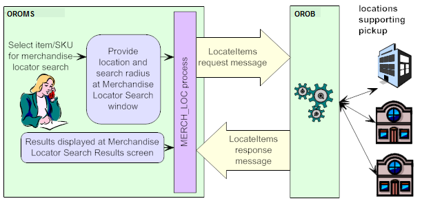

Searching for Pickup Locations Only (Message Version 3.0 or 3.1)
Overview: A typical process of inquiring on locations where an item is available for pickup is described below.
Used when? This process applies when the CW_LOCATE_MESSAGE_VERSION specified in Working with Customer Properties (PROP) is 3.0 or 3.1 for integration with those releases of Oracle Retail Order Broker.
1.
A customer wants to know if an item/SKU is available for pickup at a nearby store. You select the item/SKU for merchandise locator inquiry. This option is available in order entry, order maintenance, and at the Display Item Availability Screen.
2.
You advance to the Merchandise Locator Search Window (Searching for an Item), where you provide or confirm the customer’s geographic location, and the radius to search within (for example, search all stores within 25 miles of the customer’s home).
Note: The Order Broker supports merchandise locator searches only in the U.S. and Canada.
3.
In the background, the MERCH_LOC integration layer process:
• Generates the LocateItems request message and sends it to an external system such as Oracle Retail Order Broker. Oracle Retail Order Broker checks the availability of the item in stores that stock the item/SKU within the search area.
• Receives the LocateItems response returned by Oracle Retail Order Broker. This message lists the item/SKU’s current or estimated availability in each searched location that stocks the item.
4.
You advance to the Merchandise Locator Search Results Screen, displaying the item/SKU’s availability in each of the locations, including information on any open purchase orders.
How does Oracle Retail Order Broker select the locations to include? Only store locations flagged as Pickup available can be included in the search results. Also, Oracle Retail Order Broker uses any probability rules you have set up to determine whether to include locations in the results, and the available quantity to indicate. For example, you might set up a probability rule for certain locations indicating to exclude them if the available quantity falls below 5 units, or to reduce the available quantity returned in the response message by 10%.
What information does Oracle Retail Order Broker return for each location? For each location included in the search results, Oracle Retail Order Broker indicates:
• the available quantity, next purchase order date, and next purchase order quantity
• the name, address, and phone number of the location.
• the distance from the search address:
- locations are sorted in ascending order by distance (closest location listed first)
- locations that are not flagged to Use Proximity Locator are listed without a distance
See the Merchandise Locator Search Results Screen and the Sample LocateItems Messages (Message Version 3.0 or 3.1) for more information.

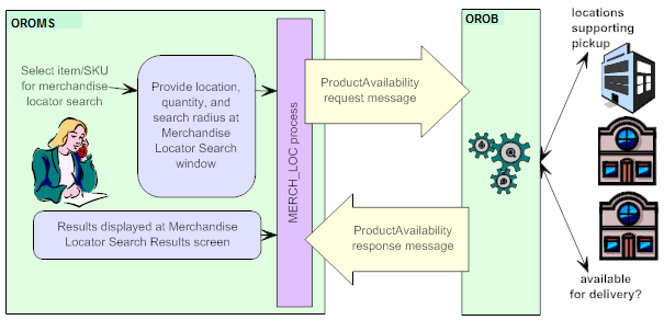

Searching for Pickup Locations and Shipment Availability (Message Version 5.0+)
Overview: A typical process of inquiring on locations where an item is available for pickup, as well as whether the item is available for shipment from a location, is described below.
Used when? This process applies when the CW_LOCATE_MESSAGE_VERSION specified in Working with Customer Properties (PROP) is 5.0 or higher.
1.
A customer wants to know if an item/SKU is available for pickup at a nearby store or available for shipment from a store location. You select the item/SKU for merchandise locator inquiry. This option is available in order entry, order maintenance, and at the Display Item Availability Screen.
2.
You advance to the Merchandise Locator Search Window (Searching for an Item), where you provide or confirm the customer’s geographic location, the requested quantity of the item, and the radius to search within (for example, search all stores within 25 miles of the customer’s home).
3.
In the background, the MERCH_LOC process:
• Generates the ProductAvailability request message and sends it to Oracle Retail Order Broker. Oracle Retail Order Broker checks the availability of the item in stores that stock the item/SKU within the search area, as well as whether the item is available for shipment at any store locations within the same search area.
• Receives the ProductAvailability response returned by Oracle Retail Order Broker. This message lists:
- the item/SKU’s current or estimated availability in each searched location that stocks the item for pickup
- an indicator of whether the requested quantity of the item/SKU is available for shipment within the search area
4.
You advance to the Merchandise Locator Search Results Screen, displaying the item/SKU’s availability for pickup in each of the locations, including information on any open purchase orders. The screen also indicates whether the requested quantity of the item/SKU is available for delivery from a store within the same search area.
• Locations eligible to fulfill pickup orders:
- Only store locations flagged as Pickup available can be included in the search results displayed at the Merchandise Locator Search Results Screen.
- Oracle Retail Order Broker uses any probability rules you have set up to determine whether to include locations in the results, and the available quantity to indicate. For example, you might set up a probability rule for certain locations indicating to exclude them if the available quantity falls below 5 units, or to reduce the available quantity returned in the response message by 10%.
Results displayed: For each location included in the search results as eligible for a pickup order, the Merchandise Locator Search Results Screen indicates:
- the available quantity, next purchase order date, and next purchase order quantity
- the name, address, and phone number of the location
- the distance from the search address:
* locations are sorted in ascending order by distance (closest location listed first)
* locations that are not flagged to Use Proximity Locator are listed without a distance
- Any locations associated in Oracle Retail Order Broker with your Order Management System system are excluded from the results, regardless of whether there is a corresponding warehouse record in Order Management System.
- If a location that stocks the item and is within the search radius is flagged in Oracle Retail Order Broker as Backorder Available, it is returned in the search results even if it does not have the item available. In this case, the Pickup avail qty listed can be blank, or can be a negative quantity.
- If there are locations that stock the item and are within the search radius, but none have the full requested quantity available (and are not flagged as Backorder Available), the Merchandise Locator Search Results Screen displays the locations, but does not indicate the Dist, Pickup avail qty, Open PO qty, or Next PO date. This situation could occur if, for example, the customer requests 5 units, and none of the locations have more than 4 units available. To display the full information for the displayed locations, search again with a lower Search quantity.
• Locations eligible to fulfill delivery orders: Only store locations flagged as Shipping available are eligible to fulfill a delivery order. Also, Oracle Retail Order Broker:
- uses any probability rules you have set up to determine whether to include locations in the results, and the available quantity. For example, you might set up a probability rule for certain locations indicating to exclude them if the available quantity falls below 5 units, or to reduce the available quantity indicated in the response message by 10%.
- does not exclude locations flagged as Backorder available, even if the available quantity in the location is less than the requested quantity.
- restricts eligible locations to a fulfillment zone based on the search address, if configured in Oracle Retail Order Broker.
- excludes locations associated with Order Management System’s system in Oracle Retail Order Broker, if the Disallow shopping within same system option is selected for the Order Management System system in Oracle Retail Order Broker.
- excludes locations that have already been assigned the Maximum Daily Orders, if Use Maximum Order Limits preference is selected in Oracle Retail Order Broker.
Results displayed: If the results indicate that one or more locations could deliver the requested quantity, the Merchandise Locator Search Results Screen indicates Delivery From Store Is Available; otherwise, the screen indicates Delivery From Store Is Not Available.
Note: The delivery evaluation uses the same search radius as the pickup evaluation. To determine whether the item can be shipped without restricting the results to locations within driving distance of the customer, retry the search with a higher search radius.
For more information: See the Merchandise Locator Search Results Screen and the Sample ProductAvailability Messages (Message Version 5.0+) for more information on the search results.
Sample Product Availability request and response messages are provided below, along with notes on the information included in each message. Order Management System generates the Product Availability request for a merchandise locator search if the CW_LOCATE_MESSAGE_VERSION specified in Working with Customer Properties (PROP) is 5.0 or higher.
For complete documentation on these messages, see the Oracle Retail Order Broker Operations Guide.
Logged where? Order Management System does not log these messages; however, they are available for review in Oracle Retail Order Broker’s XML log file. See the Oracle Retail Order Broker Operations Guide for more information.
Not used when creating a pickup order: When you create a pickup order in order entry by selecting the Store Pickup option, Order Management System uses the LocateItems request message to search for store locations where the customer can pick up the order, regardless of the version specified in the Oracle Retail Order Broker Properties.
Sample Product Availability Request Message
The information in this message includes:
• version: from CW_LOCATE_MESSAGE_VERSION in Working with Customer Properties (PROP)
• destination: from the OROB Account (K49) system control value
• location code: from the OROB Default Location (K51) system control value
• system code: from the OROB System (K50) system control value
• type: the request includes both a fulfillment_type with a type of DELIVERY, and a fulfillment_type with a type of PICKUP
• range_distance: from the distance entered in the Search within field at the Merchandise Locator Search Window (Searching for an Item)
• range_unit: from the Merchandise Locator Distance Measurement (I39) system control value
• item ID: always indicates the Order Management System item and SKU code, regardless of the setting of the OROB Product Code ID (K66) system control value
• qty: the Search quantity entered at the Merchandise Locator Search Window (Searching for an Item)
• address information: from the address information entered at the Merchandise Locator Search Window (Searching for an Item)

Sample Product Availability Response Message
The information in the response includes:
• version: the version specified in the request message
• for the fulfillment_type with a type of DELIVERY:
- response_cd: set to 0 if the requested quantity of the item is available for delivery within the search radius; otherwise, set to 1011
- response_description: set to Success if the requested quantity of the item is available for delivery within the search radius; otherwise, set to Product not available within search criteria
- item ID: the item and SKU specified in the request message
If the full requested quantity is available for delivery, the Merchandise Locator Search Results Screen indicates Delivery From Store Is Available; otherwise, the screen indicates Delivery From Store Is Not Available.
• for the fulfillment_type with a type of PICKUP:
- response_cd: set to 0 if the requested quantity of the item is available for pickup within the search radius; otherwise, set to 1011
- response_description: set to Success if the requested quantity of the item is available for pickup within the search radius; otherwise, set to Product not available within search criteria
* location_cd: the code identifying the location, as set up in Oracle Retail Order Broker
* system_cd: the code identifying the location’s system, as set up in Oracle Retail Order Broker
* distance: the total miles or kilometers (depending on the setting of the Merchandise Locator Distance Measurement (I39) system control value) between the address entered at the Merchandise Locator Search Window (Searching for an Item) and the address of the location. See the Dist for more information.
* distance_unit: set to M if the distance unit specified was miles; otherwise, set to K
* available_qty: see the Pickup avail qty field for more information.
* next_po_qty: see the Open PO qty field for more information.
* po_dt: see the Next PO date field for more information.
• location: for each location included in the response, the name and address is included. The Display Merchandise Locator Search Result Screen displays much of the location name and address included in the message.

• Click OK. The system generates the:
- LocateItems request message if the CW_LOCATE_MESSAGE_VERSION in Working with Customer Properties (PROP) specifies version 3.0 or 3.1. See Sample LocateItems Messages (Message Version 3.0 or 3.1) for more information.
- ProductAvailability request message if the CW_LOCATE_MESSAGE_VERSION in Working with Customer Properties (PROP) specifies a version of 5.0 or higher. See Sample ProductAvailability Messages (Message Version 5.0+) for more information.
When the system receives the response message, you advance to the Merchandise Locator Search Results Screen.
