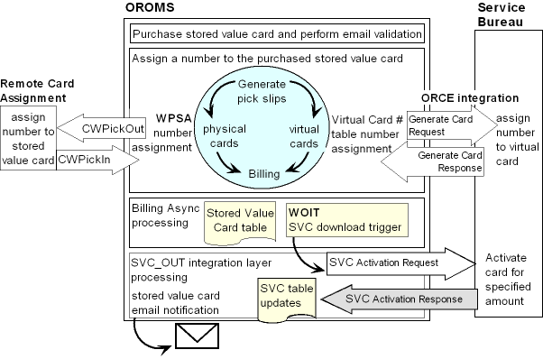

Stored Value Card Purchase and Activation
Purpose: You can purchase a stored value card item on an order to deliver to the recipient card holder by mail or email. However, before the recipient card holder can use the stored value card as a form of payment, the card must be activated by the service bureau.
Activation processing: To activate a stored value card:
1.
A customer purchases a stored value card item on an order. If the stored value card is a virtual card, the system verifies that an email address is defined for the recipient card holder. See Purchasing a Stored Value Card.
2.
During pick slip preparation, the system creates a separate pre-generated pick for each physical stored value card.
• After the picks are printed, you must:
- Use Working with Physical Stored Value Card Assignment (WPSA) to assign a number to physical stored value cards by pick control number, OR
- If you use an external system to assign numbers to physical cards, receive the card number in the CWPickIn XML Message.
See Assigning Numbers to Physical Stored Value Cards for additional details.
• For virtual stored value cards, during pick slip generation the system:
- Assigns a number to the card from the Virtual Card Number Table (FLSVCA), OR
- If you are using the Customer Engagement Stored Value Card Integration, assigns a number to the card by sending a Oracle Retail Customer Engagement Generate Card Request to the Oracle Retail Customer Engagement system.
See Assigning Numbers to Virtual Stored Value Cards.
3.
Once the stored value card is billed (see Billing a Stored Value Card), the system generates an SVC download trigger containing the information required to activate the card.
4.
The system sends a stored value card activation request to the service bureau for activation.
• If the Use Activation / Reversal Batch Processing (I50) system control value is selected, the system does not process the SVC download trigger until you submit the batch process from the Transmitting Activation and Reversal Transactions (SSVC) menu option. In this situation, the SVC Activation integration layer job can remain inactive.
• If the Use Activation / Reversal Batch Processing (I50) system control value is unselected, when active, the SVC Activation integration layer job monitors for SVC download trigger records to process immediately.
See Activating a Stored Value Card.
5.
Once an approved stored value card activation is received from the service bureau, the system updates the stored value card and sends a Stored Value Card Notification Email to the customer, if defined, indicating the stored value card activation information.
Stored Value Card Activation Process:
You purchase a stored value card as you would any item.
Physical stored value cards: When you purchase a physical stored value card (SVC type Physical Card or Physical Card/Early Notify), the system:
• Reserves the item on the order, based on available inventory.
• Does not require an email address, even if the stored value card is eligible for email notification. If you ordered a physical stored value card (with email notification) and an email address is not defined, the system still allows you to accept the order; however, the Stored Value Card Notification Email is not sent.
Note: You can create a custom special handling template to capture stored value card information, such as the gift giver’s name, recipient’ name, and any gift message.
Virtual stored value cards: When you purchase a virtual stored value card (SVC type Virtual Card), the system:
• Automatically reserves the item on the order and express bills the item during pick slip generation.
• Requires an email address to send the Stored Value Card Notification Email to the recipient card holder. An email address is required because the email notification is the only way the recipient of the virtual stored value card will receive the stored value card number associated with the order. If you order a virtual stored value card item and an email address is not defined or the opt in/out value is invalid, the system displays an error and does not allow you to accept the order: Invalid e-mail address/opt in for order containing virtual SVC item. A similar error also displays when you process a web order. See Stored Value Card Email Hierarchy.
For more information: See Assigning a Stored Value Card Number for more information on how to assign a number to a stored value card.
Follow these steps to assign a number to a physical stored value card (SVC type Physical Card or Physical Card/Early Notify):
1. Generate a pick slip for the order containing the physical stored value card.
When you generate a pick slip for an order containing a physical stored value card, the system:
• prints a separate pick slip for each order line containing a physical stored value card. However, if you wish to print a separate pick slip for each unit of the stored value card item, set up the item as ship alone (Ship alone = Ship Alone).
• creates a record in the Pick Stored Value Card Table for each unit of the stored value card item printed.
• includes the stored value card item on the Pick Unit Report.

2. Assign a number to the physical stored value card.
• Use Working with Physical Stored Value Card Assignment (WPSA) to assign a number to a physical stored value card by pick control number, OR
• Use the svc_card_nbr tag in the CWPickIn XML Message to receive a card assignment from an external system.
3. Bill the pick control number containing the stored value card item.
The Use Streamlined Stored Value Card Billing (I23) system control value determines when the physical stored value card is sent to billing.
• If this system control value is selected, the system sends the pick control number assigned to the stored value card to billing immediately after you assign a number to the card.
• If this system control value is unselected, the system sends the pick control number assigned to the stored value card to billing after you wand and bill the card at the manifesting station.
If you use the Manually Confirming Shipments (MCON) menu option to confirm a pick control number containing a stored value card item, the system verifies that the stored value card is assigned a number. If the stored value card is not assigned a number, the system does not allow you to confirm the pick control number or change the status of the pick slip to carryover and instead displays an error message: All stored value card numbers must be entered before accepting.
For more information: See Billing a Stored Value Card for more information on the processing the system performs when you bill a stored value card.
To assign a number to a virtual stored value card (SVC type V), generate a pick slip for the order containing the virtual stored value card.
When you generate a pick slip for an order containing a virtual stored value card, the system:
• automatically assigns a stored value card number to the virtual card, using the next available number from the Virtual Card Number Table (FLSVCA) and deletes the record from the Virtual Card Number table.
Note: Make sure a number is available in the Virtual Card Number table to assign to the virtual stored value card; if a number is not available to assign to the card, the entire order line containing the stored value card item will not be billed and the order will print on the Stored Value Card Assignment Errors Report.
• express bills the item and sends the pick control number containing the virtual stored value card to billing.
• does not include the stored value card item on the Pick Unit Report.
Oracle Retail Customer Engagement Stored Value Card integration: If you are using the Customer Engagement Stored Value Card Integration, the system does not assign a number to a virtual card from the Virtual Card Number table. Instead, the system:
• generates a Oracle Retail Customer Engagement Generate Card Request and sends the message to Oracle Retail Customer Engagement.
• receives the Oracle Retail Customer Engagement Generate Card Response from Oracle Retail Customer Engagement, containing the assigned card number.
When a pick control record containing a stored value card item is billed, the system:
1. Deletes the associated record in the Pick Stored Value Card Table, if the stored value card is a physical card.
2. Determines the issue amount to apply to the stored value card.
The Stored Value Card Activation Pricing Method (I25) system control value determines the price the system uses as the amount to apply to the stored value card.
• If this system control value is set to OFFER, the stored value card amount is the offer price. If the offer price is $0.00, the system uses the order line price.
• If this system control value is set to ORDER or blank, the stored value card amount is the order line price. If the order line price is $0.00, the system uses the offer price.
If both the offer price and order line price are $0.00, the stored value card amount is $0.00.
3. Creates a record in the Stored Value Card Table for each unit of the stored value card item.

4. Creates an SV tickler, if you Use Workflow Management (H96), for each stored value card item that was processed through billing without a number assignment.
A stored value card may be billed without a number assignment if you send the physical stored value card to the manifesting station without first using the Working with Physical Stored Value Card Assignment (WPSA) menu option to assign a number to the card. The system will not create a SVC download trigger for the stored value card until the card is assigned a number.
See SV (SVC Number Assignment) Event Processing for more information on how to resolve this tickler.
5. Creates an SVC download trigger in the Outbound Interface Transaction table for each stored value card that has been billed and is assigned a stored value card number.
You can review download triggers in the Working with Outbound Interface Transactions (WOIT) menu option. See Identifying SVC Download Triggers.
The system creates an SVC download trigger in the IL Outbound Trigger table when a stored value card item is billed (see Billing a Stored Value Card).
You can view all download triggers in the IL Outbound Trigger table at the Work with Outbound Interface Transactions Screen.
Each SVC download trigger in the IL Outbound Trigger table contains a:
• File code: indicating the type of information to download and which IL process job processes the trigger. For SVC download triggers, the File code is SVC.
• Key: indicating the specific record to download. For SVC download triggers, the Key identifies the specific company, order number, ship to number, order detail sequence number, and stored value card sequence number associated with the SVC download trigger. For example, the Key 555000066760010000100004 indicates the stored value card information is located in company 555 for order number 6676, ship to number 1, order detail sequence number 1, and stored value card number 4.
• Capture type: indicating the type of activity performed against the record. SVC download triggers are always capture type A indicating the stored value card was created.
SVC download triggers in a ready status are processed by the SVC_OUT integration layer job.

Generating the Stored Value Card Activation Request
To generate a stored value card activation request, the system:
1.
Creates an SVC download trigger when an order containing a stored value card item assigned a number is billed; see Identifying SVC Download Triggers.
2.
Looks for unprocessed SVC download triggers to process, based on the setting of the Use Activation / Reversal Batch Processing (I50) system control value.
• If this system control value is selected, the system does not process the stored value card trigger records until you submit the batch process using the Transmitting Activation and Reversal Transactions (SSVC) menu option or the SVCACT periodic function (program name PFR0076). In this situation, the SVC Activation integration layer job can remain inactive.
• If this system control value is unselected, when active, the SVC Activation integration layer job monitors for stored value card download trigger records to process at defined intervals, based on the Outbound delay time.
The system:
• looks for SVC download triggers with the File code SVC and a status of ready (R).
• determines which stored value card activation to download, based on the Key field for the activation download trigger.
• looks for a record in the Stored Value Card Table that contains this information.
3.
Looks at the Stored Value Card Activation Authorization Service (I26) system control value to determine the service bureau used to activate stored value cards.
4.
Looks at the Communication type field for the service bureau to determine how transactions are processed between Order Management System and the service bureau.
• Integration Layer = The system sends activation transactions to the service bureau using the queues defined for the activation integration layer job.
• Payment Link = Point-to-point integration. The system sends activation transactions to the service bureau using a point-to-point integration. You must define communication settings in Working with Customer Properties (PROP). The system does not use the activation integration layer job to communicate with the service bureau; however, the system uses the job to process activation triggers. See Process Activations Using Payment Link Communication.

5.
Order Management System processes the activation response accordingly. See:
• What Happens When the Stored Value Card Activation is Approved?
• What Happens When the Stored Value Card Activation is Declined?
