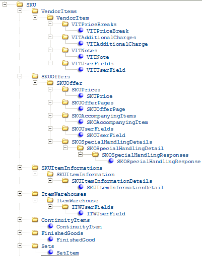

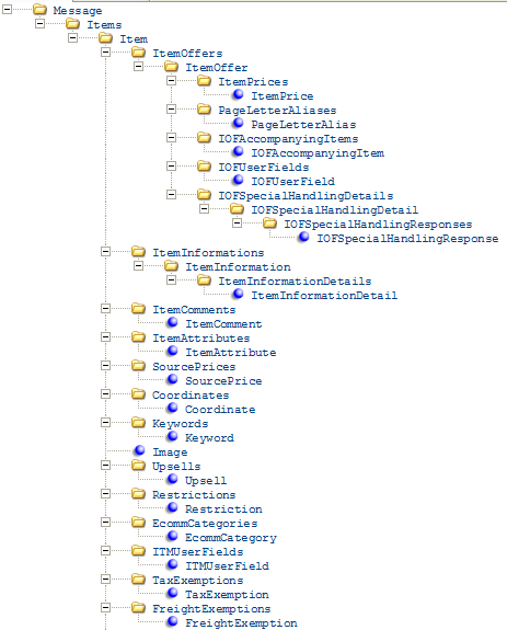

You can define Item Outbound XML inclusion rules at the Outbound Interface XML Inclusion Screen.
XML inclusion defines which elements to include in the item download message.
• If the element is included, that element and its parents are included in the generated item download XML message.
• If the element is excluded, that element and its children are excluded from the generated item download message.
This table indicates which elements in the item download message are included, based on which elements you flag to include or exclude.
Include element in XML message? |
Element |
Selected = Include Item Unselected = Exclude Item and all of its children; the system sends a message with only the Message element and its attributes |
Item |
Selected = Include ItemOffer and its parent Item Unselected = Exclude ItemOffer and its children ItemPrice, PageLetterAlias, IOFAccompanyingItem, IOFUserField, IOFSpecialHandlingDetail and IOFSpecialHandlingResponse |
ItemOffer |
Selected = Include ItemPrice and its parents, ItemOffer and Item Unselected = Exclude ItemPrice |
ItemPrice |
Selected = Include PageLetterAlias and its parents ItemOffer and Item Unselected = Exclude PageLetterAlias |
PageLetterAlias |
Selected = Include IOFAccompanyingItem and its parents ItemOffer and Item Unselected = Exclude IOFAccompanyingItem |
Selected = Include IOFUserField and its parents ItemOffer and Item Unselected = Exclude IOFUserField |
IOFUserField |
Selected = Include IOFSpecialHandlingDetail and its parents ItemOffer and Item Unselected = Exclude IOFSpecialHandlingDetail and its child IOFSpecialHandlingResponse |
IOFSpecialHandlingDetail |
Selected = Include IOFSpecialHandlingResponse and its parents IOFSpecialHandlingDetail, ItemOffer, and Item Unselected = Exclude IOFSpecialHandlingResponse |
Selected = Include ItemComment and its parent Item Unselected = Exclude ItemComment |
ItemComment |
Selected = Include ItemAttribute and its parent Item Unselected = Exclude ItemAttribute |
ItemAttribute |
Selected = Include SourcePrice and its parent Item Unselected = Exclude SourcePrice |
SourcePrice |
Selected = Include Coordinate and its parent Item Unselected = Exclude Coordinate |
Coordinate |
Selected = Include Keyword and its parent Item Unselected = Exclude Keyword |
Keyword |
Selected = Include Image and its parent Item Unselected = Exclude Image |
Image |
Selected = Include Restriction and its parent Item Unselected = Exclude Restriction |
Restriction |
Selected = Include ITMUserField and its parent Item Unselected = Exclude ITMUserField |
ITMUserField |
Selected = Include TaxExemption and its parent Item Unselected = Exclude TaxExemption |
TaxExemption |
Selected = Include FreightExemption and its parent Item Unselected = Exclude FreightExemption |
FreightExemption |
Selected = Include SKU and its parent Item Unselected = Exclude SKU and all of its children VendorItem, SKUItemInformation, ItemWarehouse, FinishedGood, SetItem, VariableSet, SKUComment, SKUAttribute, UPC, SKUUserField |
SKU |
Selected = Include VendorItem and its parents SKU and Item Unselected = Exclude VendorItem and its children VITPriceBreak, VITAdditionalCharge, VITNote, and VITUserField |
VendorItem |
Selected = Include VITPriceBreak and its parents VendorItem, SKU, and Item Unselected = Exclude VITPriceBreak |
VITPriceBreak |
Selected = Include VITAdditionalCharge and its parents VendorItem, SKU, and Item Unselected = Exclude VITAdditionalCharge |
VITAdditionalCharges |
Selected = Include VITNote and its parents VendorItem, SKU, and Item Unselected = Exclude VITNote |
VITNote |
Selected = Include VITUserField and its parents VendorItem, SKU, and Item Unselected = Exclude VITUserField |
VITUserField |
Selected = Include SKUOffer and its parents SKU and Item Unselected = Exclude SKUOffer and its children SKUPrice, SKUOfferPage, SKOAccompanyingItem, SKOUserField, and SKOSpecialHandlingDetail |
SKUOffer |
Selected = Include SKUPrice and its parents SKUOffer, SKU and Item Unselected = Exclude SKUOfferPage |
SKUPrice |
Selected = Include SKUOfferPage and its parents SKUOffer, SKU, and Item Unselected = Exclude SKUOfferPage |
SKUOfferPage |
Selected = Include SKOAccompanyingItem and its parents SKUOffer, SKU, and Item Unselected = Exclude SKOAccompanyingItem |
Selected = Include SKOUserField and its parents SKUOffer, SKU, and Item Unselected = Exclude SKOUserField |
SKOUserField |
Selected = Include SKOSpecialHandlingDetail and its parents SKUOffer, SKU, and Item Unselected = Exclude SKOSpecialHandlingDetail and its child SKOSpecialHandlingResponse |
Selected = Include SKOSpecialHandlingResponse and its parents SKOSpecialHandlingDetail, SKUOffer, SKU, and Item Unselected = Exclude SKOSpecialHandlingResponse |
Selected = Include SKUItemInformation and its parents SKU and Item Unselected = Exclude SKUItemInformation and its child SKUItemInformationDetail |
SKUItemInformation |
Selected = Include SKUItemInformationDetail and its parents SKUItemInformation, SKU, and Item Unselected = Exclude SKUItemInformationDetail |
Selected = Include ItemWarehouse and its parents SKU and Item Unselected = Exclude ItemWarehouse and its child ITWUserField |
ItemWarehouse |
Selected = Include ITWUserField and its parents ItemWarehouse, SKU, and Item Unselected = Exclude ITWUserField |
ITWUserField |
Selected = Include FinishedGood and its parents SKU and Item Unselected = Exclude FinishedGood |
FinishedGood |
Selected = Include SetItem and its parents SKU and Item Unselected = Exclude SetItem |
SetItem |
Selected = Include VariableSet and its parents SKU and Item Unselected = Exclude VariableSet and its children VariableSetGroup and VariableSetItem |
VariableSet |
Selected = Include VariableSetGroup and its parents VariableSet, SKU, and Item Unselected = Exclude VariableSetGroup and its child VariableSetItem |
VariableSetGroup |
Selected = Include VariableSetItem and its parents VariableSetGroup, VariableSet, SKU, and Item Unselected = Exclude VariableSetItem |
VariableSetItem |
Selected = Include SKUComment and its parents SKU and Item Unselected = Exclude SKUComment |
SKUComment |
Selected = Include SKUAttribute and its parents SKU and Item Unselected = Exclude SKUAttribute |
SKUAttribute |
Selected = Include UPC and its parents SKU and Item Unselected = Exclude UPC |
UPC |
Selected = Include SKUUserField and its parents SKU and Item Unselected = Exclude SKUUserField |
SKUUserField |

The ItemPrice element repeats for each item price record defined for the item in the Item Price table. |
Effective_date |
numeric |
7 |
The date the price or quantity break discount becomes valid. From the Effective date field in the Item Price table. |
Qty |
numeric |
7 |
The amount of the item that the customer must order to receive the discounted price. From the Qty field in the Item Price table. |
Associate_price |
numeric |
7.2 |
The price at which the item is sold to associate customers. From the Associate price field in the Item Price table. |
Price |
numeric |
7.2 |
The price at which the item is sold. From the Price field in the Item Price table. |
IPR_Price_column |
alpha |
1 |
A code that indicates the pricing column associated with the price. From the Price column field in the Item Price table. |
IPR_Associate_tax |
numeric |
7.2 |
The price at which the item is sold to associate customers on orders subject to tax-inclusive pricing and VAT. From the Tax inclusive associate price field in the Item Price table. |
IPR_Tax_price |
numeric |
7.2 |
The price at which the item is sold on orders subject to tax-inclusive pricing and VAT. From the Tax incl price field in the Item Price table. |
IPR_No_Charge |
alpha |
1 |
Indicates if the item is sold at no charge. • Y = The item is sold at no charge. • N = The item is sold for a price. From the IPR no charge? field in the Item Price table. |
The PageLetterAlias element repeats for each page letter alias record defined for the item offer in the Page Letter Alias table. |

The IOFAccompanyingItem element repeats for each accompanying item record defined for the item offer in the Accompanying Item table. |
ACI_Qty_required |
numeric |

The IOFUserField element repeats for each item offer user field record defined for the item offer in the Item Offer User Field table. |
IOF_UDF_Sequence_Nbr |

The IOFSpecialHandlingDetail element repeats for each special handling detail record defined for the item offer in the Item Offer User Field table. |
SFD_Seq_Nbr |

The IOFSpecialHandlingResponse element repeats for each item information record defined for the item’s class in the Item Class Template table. |
SFD_Seq_Nbr |

The ItemComment element repeats for each item comment defined for the item in the SKU Comments table. |
Seq_Nbr |

The ItemAttribute element repeats for each item attribute defined for the item in the Item Attribute table. |
IAT_Type |

The SourcePrice element repeats for each source price for the item in the Special Pricing by Source table. |
SRC_Source_code |

The Coordinate element repeats for each coordinate for the item in the Item Coordinate table. |
ICN_Coordinate_item |

The Keyword element repeats for each keyword for the item in the Keyword table. |
KWD_Type |

The Restriction element repeats for each item restriction defined for the item in the Item Restriction by Country/State table. |
RPR_Country |

The ITMUserField element repeats for each item user field defined for the item in the Item User Field table. |
ITM_UDF_Sequence_Nbr |

The TaxExemption element repeats for each tax exemption defined for the item in the Item Tax Exempt table. |
ITE_State |

The FreightExemption element repeats for each freight exemption defined for the item in the Freight Exemption table. |
FEF_Sequence_Number |

Each item download message contains one Item element and one SKU element. For example, if you update a SKU’ed item, the system generates a separate item download message for each SKU. |
SKU_Code |
alpha |
14 |
The SKU code for the item, such as style, color, and/or size. From the SKU code field in the SKU table. |
Collating_sequence_Nbr |
numeric |
5 |
The collating sequence number assigned to the SKU. From the Collating seq # field in the SKU table. |
Compatibility |
alpha |
3 |
compatibility code assigned to the SKU; other SKUs that are compatible to this SKU are assigned the same compatibility code. From the Compatibility field in the SKU table. |
SKU_Cubing_value_override |
numeric |
7.1 |
The cubic volume of the SKU, which overrides the cubic volume defined for the item. From the Cub val field in the SKU table. |
SKU_Description |
alpha |
40 |
A description of the SKU. From the Description field in the SKU table. |
SKU_Subscription |
alpha |
1 |
Indicates whether the SKU is a subscription item. • Y = this is a subscription item. • N = this is not a subscription item. From the Subscription field in the SKU table. |

The VITPriceBreak element repeats for each vendor price break defined for the vendor item in the Vendor Item Price Break table. |

The VITAdditionalCharge element repeats for each vendor additional charge associated with the vendor item in the Vendor Item Addl Charge table. |

The VITNote element repeats for each vendor item note associated with the vendor item in the Vendor Item Notes table. |

The VITUserField element repeats for each vendor item user field associated with the vendor item in the Vendor Item User Field table. |

The SKUOffer element repeats for each SKU offer record defined for the SKU in the SKU Offer table. |

The SKUPrice element repeats for each SKU price record defined for the SKU in the SKU Price table. |

The SKUOfferPage element repeats for each SKU offer page record defined for the SKU in the SKU Offer Page table. |

The SKOAccompanyingItem element repeats for each accompanying item record defined for the SKU in the Accompanying Item table. |

The SKOUserField element repeats for each SKU offer user field record defined for the SKU in the SKU Offer User Field table. |

The SKOSpecialHandlingDetail element repeats for each special format detail record defined for the SKU offer in the Special Format Details table. |

The ItemWarehouse element repeats for each item warehouse defined for the SKU in the Item Warehouse table. |
Warehouse |
numeric |
3 |
A code that represents a warehouse or retail store. From the Whs field in the Item Warehouse table. |
Allocation_freeze |
alpha |
1 |
Indicates whether the SKU in the warehouse is frozen. • Y = The SKU warehouse is frozen. • N = The SKU warehouse is not frozen. From the Allocation freeze field in the Item Warehouse table. |
Economic_order_qty |
numeric |
7 |
The recommended optimum ordering quantity for the SKU. From the Economic order qty field in the Item Warehouse table. |
Max_qty |
numeric |
7 |
The maximum number of units to be kept on hand in the warehouse. From the Max qty field in the Item Warehouse table. |
Min_qty |
numeric |
7 |
The minimum number of units to be kept on hand in the warehouse. From the Min qty field in the Item Warehouse table. |
Protected_qty |
numeric |
7 |
The unit quantity of the SKU protected from reservation. From the Protected qty field in the Item Warehouse table. |
Reorder_qty |
numeric |
7 |
The quantity of the SKU that should be replenished when the SKU reaches the minimum stock level for the warehouse. From the Reorder qty field in the Item Warehouse table. |
ITW_Original_retail_price |
numeric |
7.2 |
The original price of the SKU in the retail store. From the ITW original retail price field in the Item Warehouse table. |
ITW_Current_retail_price |
numeric |
7.2 |
The current price of the SKU in the retail store. From the ITW current retail price field in the Item Warehouse table. |
ITW_Protect_current_price |
alpha |
1 |
Indicates whether the system overrides the Current retail price field when you change the retail price. • Y = The system keeps the existing current retail price defined for the item warehouse. • N = The system updates the current retail price defined for the item warehouse. From the ITW protect current price field in the Item Warehouse table. |
ITW_Protect_MinMax |
alpha |
1 |
Indicates whether the system overrides the minimum or maximum quantity when you change the minimum or maximum quantity in Working with Item Warehouse Values (WIWV). • Y = The system does not update the minimum or maximum quantity defined for the item warehouse. • N = The system updates the minimum or maximum quantity defined for the item warehouse. From the ITW protect min/max field in the Item Warehouse table. |
ITW_User_field_1 |
alpha |
10 |
A user-defined field for the item warehouse. From the ITW user field 1 field in the Item Warehouse table. |
ITW_User_field_2 |
alpha |
10 |
A user-defined field for the item warehouse. From the ITW user field 2 field in the Item Warehouse table. |
The ITWUserField element repeats for each item user field associated with the SKU in the Item Warehouse User Field table. |
ITW_UDF_Sequence_Nbr |
numeric |
3 |
The sequence number assigned to the item warehouse user field. From the Seq# field in the Item Warehouse User Field table. |
ITW_UDF_Text |
alpha |
30 |
The text defined for the item warehouse user field. From the Text field in the Item Warehouse User Field table. |
ITW_UDF_Number |
numeric |
16 |
The number defined for the item warehouse user field. From the Number field in the Item Warehouse User Field table. |
ITW_UDF_Date |
numeric |
7 |
The date defined for the item warehouse user field. From the Date field in the Item Warehouse User Field table. |
ITW_UDF_Display_sequence |
numeric |
3 |
The sequence number assigned to the item warehouse user field, controlling its placement on the screen. From the Display sequence field in the Item Warehouse User Field table. |
ITW_UDF_File_code |
alpha |
3 |
The code representing the table to which the user-defined field is linked. For item warehouse user fields, the file code is ITW. From the ITW UDF file code field in the Item Warehouse User Field table. |
UDD_Field_label |
alpha |
15 |
The field label that appears on a screen for the vendor item user field. From the Field label field in the User Defined Field Detail table. |
UDD_Field_type |
alpha |
1 |
A code that identifies the type of field. • D = Date field. • N = Number field. • T = Text field. From the Field type field in the User Defined Field Detail table. |
UDD_Field_usage |
alpha |
1 |
A code that identifies whether you are collecting the field information for the user-defined field. • I (Input) = you can enter information in this field. • O (output) = you cannot enter information in this field. From the Field usage field in the User Defined Field Detail table. |
The FinishedGood element is included only if the item is defined as a finished good item (the Kit_type attribute is set to F). The FinishedGood element repeats for each finished good component defined for the SKU in the Kit Details table. |
SeqNbr |
numeric |
5 |
The sequence number assigned to the kit detail. From the Seq# field in the Kit Detail table. |
Qty |
numeric |
5 |
The number of items that are used to make up the finished good. From the Qty field in the Kit Detail table. |
Kit_Comp_ITM_Number |
alpha |
12 |
A component item that makes up the finished good. From the Kit comp ITM number field in the Kit Detail table. |
Kit_Comp_SKU_Code |
alpha |
14 |
The SKU of the component item that makes up the finished good. From the Kit comp SKU code field in the Kit Detail table. |
The SetItem element is included only if the item is defined as a set item (the Kit_type attribute is set to S). The SetItem element repeats for each set component defined for the SKU in the Set Details table. |
SeqNbr |
numeric |
3 |
The sequence number assigned to the set detail. From the Seq# field in the Set Details table. |
Coordinate_group |
numeric |
3 |
Group number assigned to set component items to ensure that they ship together. From the Coordinate group field in the Set Details table. |
Pct_of_cost |
numeric |
5.2 |
The percentage of the set’s cost that the item comprises. From the % of cost field in the Set Details table. |
Qty |
numeric |
5 |
The number of units of the item to include in one set. From the Qty field in the Set Details table. |
Set_Comp_ITM_Number |
alpha |
12 |
A component item of the set item. From the Set comp ITM number field in the Set Details table. |
Set_Comp_SKU_Code |
alpha |
14 |
The SKU of the component item. From the Set comp SKU code field in the Set Details table. |
The VariableSet element and its children, VariableSetGroup and VariableSetItem, is included only if the SKU is defined as a variable set (the Kit_type attribute is set to V). |
VSE_Create_coord_group |
alpha |
1 |
From the Create coord group? field in the Variable Set table. |
The VariableSetGroup element repeats for each variable set group defined for the SKU in the Variable Set Group table. |
Group |
numeric |
3 |
A code that represents a group containing items offered in the variable set. From the Group field in the Variable Set Group table. |
Description |
alpha |
30 |
A description of the variable set group. From the Description field in the Variable Set Group table. |
Nbr_of_items |
numeric |
3 |
The number of units the customer must order from the group. From the # of items field in the Variable Set Group table. |
The VariableSetItem element repeats for each variable set component defined for the SKU in the Variable Set Details table. |
SeqNbr |
numeric |
3 |
The sequence number assigned to the variable set detail. From the Seq# field in the Variable Set Details table. |
Var_comp_ITM_Number |
alpha |
12 |
A component item of the variable set item. From the Var comp ITM number field in the Variable Set Details table. |
Var_comp_SKU_Code |
alpha |
14 |
The SKU of the component item. From the Var comp SKU code field in the Variable Set Details table. |
The SKUComment element repeats for each SKU comment defined for the SKU in the SKU Comments table. |
Seq_Nbr |
numeric |
3 |
The sequence number assigned to the SKU comment. From the Seq # field in the SKU Comments table. |
Comment_line |
alpha |
50 |
A line of SKU comments. From the Comment field in the SKU Comments table. |
Print_code |
alpha |
1 |
Indicates where to print or display the SKU comments. • B = Both pick slip and invoice. • I = Invoice • N = Nowhere • P = Pick slip • R or blank = Catalog planning analysis reports (Not currently implemented) • W = pop-up window when you order the item From the Print code field in the SKU Comments table. |
Not implemented. |
IAT_Type |
alpha |
6 |
Not implemented. |
IAT_Description |
alpha |
30 |
Not implemented. |
IAV_Value |
alpha |
6 |
Not implemented. |
IAV_Description |
alpha |
30 |
Not implemented. |
IAA_Affinity_flag |
alpha |
1 |
Not implemented. |
The UPC element repeats for each UPC code defined for the SKU in the Item UPC table. |
UPC_Type |
alpha |
3 |
The type of UPC code. The UPC type determines the type of validation performed against the UPC code. • E13 = EAN-13; 13 position UPC code. • E8 = EAN-8; 8 position UPC code. • UA = UPC-A; 12 position UPC code. • UE = UPC-E; 6 position UPC code. From the UPC type field in the Item UPC table. |
UPC |
alpha |
14 |
The UPC code defined for the SKU. From the UPC field in the Item UPC table. |
UPC_VND_Vendor |
numeric |
7 |
The supplier who sells you merchandise. From the UPC VND vendor nbr field in the Item UPC table. |
The SKUUserField element repeats for each SKU user field defined for the SKU in the SKU User Field table. |
SKU_UDF_Sequence_Nbr |
numeric |
3 |
The sequence number assigned to the SKU user field. From the Seq# field in the SKU User Field table. |
SKU_UDF_Text |
alpha |
30 |
The text defined for the SKU user field. From the Text field in the SKU User Field table. |
SKU_UDF_Number |
numeric |
16 |
The number defined for the SKU user field. From the Number field in the SKU User Field table. |
SKU_UDF_Date |
numeric |
7 |
The date defined for the SKU user field. From the Date field in the SKU User Field table. |
SKU_UDF_Display_sequence |
numeric |
3 |
The sequence number assigned to the SKU user field, controlling its placement on the screen. From the Display sequence field in the SKU User Field table. |
SKU_UDF_File_code |
alpha |
3 |
The code representing the table to which the user-defined field is linked. For SKU user fields, the file code is SKU. From the SKU UDF file code field in the SKU User Field table. |
UDD_Field_label |
alpha |
15 |
The field label that appears on a screen for the SKU user field. From the Field label field in the User Defined Field Detail table. |
UDD_Field_type |
alpha |
1 |
UDD_Field_usage |
alpha |
1 |
Item Download Message: Sample XML
A sample of the Item Download XML Message (CWItemOut) is presented below.
<Message source="RDC" target="IDC" type="CWITEMOUT">
<Items>
<Item Allow_SKUs="Y" Buyer="HEB" Buyer_Name="HANNAH BROWN" Company="6" Drop_ship_item="N" ITM_Allow_Pct_discount="Y" ITM_Create_Date="1081014" ITM_Description="GEL PEN" ITM_Exclude_From_Flex_Pay="N" ITM_Membership="N" ITM_Oversize_flag="N" ITM_Royalty="N" Item_Number="GEL2000" Non-inventory="N" Serial_Nbr_tracking="N" Standard_cost="1.2340" Transaction_type="C" UOM_Description="EACH" UOM_Units="1" Unit_of_measure="EA" VIA_Ship_via_code="0" Vendor_Nbr="12">
<ItemOffers>
<ItemOffer Freight="2.12" Gift_wrap_flag="Y" Gift_wrap_price="1.12" Hidden_freight="2.12" IOF_Coupon_Disc_dlr="1.12" IOF_Coupon_Effective_Date="1100101" IOF_Required_Add_Reason="N" IOF_Volume_Discount_YN="N" IOF_Warranty_Item="N" Offer_Number="OFR" SH_price="2.12" Special_handling="Y">
<ItemPrices>
<ItemPrice Associate_price="9.12" Effective_date="1081001" Price="10.12" Qty="1" />
</ItemPrices>
</ItemOffer>
</ItemOffers>
<SourcePrices>
<SourcePrice SPS_Associate_price="0.11" SPS_Price="0.12" SPS_Qty="100" SRC_Source_code="SOURCE" />
</SourcePrices>
<Keywords>
<Keyword KWD_KeywordExclusion="GEL" KWD_Type="I" />
<Keyword KWD_KeywordExclusion="WRITER" KWD_Type="I" />
</Keywords>
<SKU List_price="2.23" Location="PRIM1" Lowest_price="0.12" Restrict_orders="N" SKU_Average_Cost="1.2345" SKU_Code="BLUE " SKU_Create_Date="1081014" SKU_Cubing_value_override="5.0" SKU_Description="BLUE" SKU_Element_1_Code="BLUE" SKU_Element_1_Desc="BLUE" SKU_Element_1_Name="COLR" SKU_Element_2_Code="" SKU_Element_2_Name="SIZE" SKU_Element_3_Code="" SKU_Element_3_Name="OTHR" SKU_Gift_certificate="N" SKU_Original_Retail_Price="5.12" SKU_Returnable="N" SKU_Subscription="N" SKU_Suppress_BO_Card="N" Sale_credit_flag="N" Selling_weight_override="2.120" Short_SKU="760" Warehouse="1" Warehouse_name="MAIN WAREHOUSE LOCATION" Weight_override="1.120">
<VendorItems>
<VendorItem Cubic_volume="1" Description="BLUE" Item="VGEL2000" Lead_days="1" Minimum_qty="1" Price="1.2345" Ship_weight="1.230" UOM_Description="EACH" UOM_Units="1" Unit_of_measure="EA" VIT_Upload_frt_dlr_limit="100.12" VIT_Upload_hnd_dlr_limit="90.12" VIT_Upload_other_dlr_limit="80.12" VIT_Vend_ord_qty_multiple="1" Vendor_Nbr="12" />
</VendorItems>
<SKUOffers>
<SKUOffer Freight="3.12" Gift_wrap_flag="Y" Gift_wrap_price="4.12" Hidden_freight="2.12" Offer_Number="OFR" Page_Nbr="32" SH_price="5.12" SKO_Coupon_discount_dlr="2.12" SKO_Coupon_effective_date="1121212" SKO_Required_Add_Reason="N" SKO_Volume_discountable="N" SKO_Warranty_Item="N" Special_handling_flag="Y">
<SKUPrices>
<SKUPrice Associate_price="10.12" Effective_date="1081001" Price="11.12" Qty="1" />
</SKUPrices>
</SKUOffer>
</SKUOffers>
<ItemWarehouses>
<ItemWarehouse Allocation_freeze="N" Economic_order_qty="20" ITW_Current_retail_price="2.34" ITW_Original_retail_price="1.23" ITW_Protect_MinMax="N" ITW_Protect_current_price="N" Max_qty="100" Min_qty="5" Reorder_qty="5" Warehouse="1" />
</ItemWarehouses>
<UPCs>
<UPC UPC="1234567890" UPC_Type="E13" UPC_VND_Vendor="12" />
</UPCs>
</SKU>
</Item>
</Items>
</Message>
