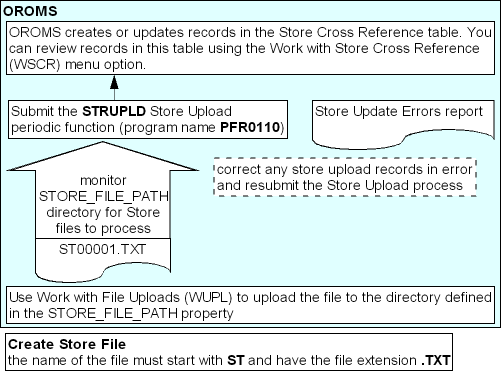

Store upload process flow:
When you submit the STRUPLD Store Upload periodic function, the system performs the following steps.
1. |
Looks in the directory defined for the STORE_FILE_PATH property for new Store Files to process. If a file exists in the STORE_FILE_PATH directory whose file name begins with ST and has a .TXT file extension, the system selects the file for processing. |
2. |
Validates each record in the file. • The system includes records that do not pass validation on the Store Update Errors Report. • The system continues to the next step for records that pass validation. |
3. |
Creates or updates records in the Store Cross Reference table for the company you entered when you submitted the STRUPLD periodic function. The system uses the Store # in the Store File to determine if the record is an add or a change. • If the Store # matches a Store # in the Store Cross Reference table, the system updates the existing record. Note: When updating an existing store cross reference record, the system overlays the existing values for the record with the values that are passed in the upload. For example, if the upload record does not include a Phone, the system updates the Telephone # field in the Store Cross Reference table to blank. • If the Store # does not match a Store # in the Store Cross Reference table, the system creates a new record. You can review the store cross reference records that have been created and updated in the Work with Store Cross Reference (WSCR) menu option. |
4. |
Once all of the records in the Store file are processed, the system changes the file extension of the file from .TXT to .PRC to indicate that the file has been processed. It is your responsibility to delete files with the .PRC file extension. |
