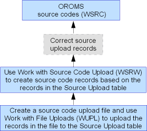

Purpose: You can create a Order Management System source code using information from the Source Upload Table (IXSRCE).
Transferring data into the Source Upload table: Use the Working with File Uploads (WUPL) menu option to upload records to the Source Upload table. Note: The database does not allow an empty (null) value in any field, so in order to populate the Source Upload Table (IXSRCE) without error for fields that you do not want to populate in the created source code records, enter a zero (for a numeric field) or a space (for an alphanumeric field).
You can use the sample data below to create a Source Code upload file.
7|SOURCECD7|C|$O|H|D|K|SOURCECD7 SOURCE CODE DESCRIPT|500.00|.00|.00|CD|5.00|DR|N|12.00|5.00|25.00|5.00|1|10000|1150401|5000|7000|POP UP WINDOW MESSAGE 1 |POP UP WINDOW MESSAGE 2 |POP UP WINDOW MESSAGE 3 |POP UP WINDOW MESSAGE 4 |12345|1234567|12.00|12345|123|Y|N|Y|12.00|12.00|150.00|55.00|ALPHANUMERIC 30 POSITIONSUSER1|ALPHANUMERIC 30 POSITIONSUSER2|ALPHANUMERIC 30 POSITIONSUSER3|ALPHANUMERIC 30 POSITIONSUSER4|ALPHANUMERIC 30 POSITIONSUSER5|ALPHANUMERIC 30 POSITIONSUSER6|N|N|07| |007|01|01|123|RCCD|LSTSOURCE|FPOCD|N|CAT|CL|1150601| | |123.00|N|N|
Note: If you wish to leave any field in the upload file blank, pass a space in the field so that the file can be processed without errors. Leaving a field with no space is interpreted as null in the database and causes errors.
Once you upload records to the Source Upload table, you can use the Work with Source Code Upload File (WSRW) menu option to change, delete, or display source upload records and then transfer the records to the Source Code table.
When you transfer the source code records, the system validates each record in the Source Upload table:
• If a source upload record contains any errors, the system flags the record with a status of E and includes the record on the Source Code Upload File Exception Report. You can correct source upload records that are in an error status by selecting OK on the Change Source Code Upload File Screen (1 of 2).
• If a source upload record does not contain any errors, the system transfers the record to the Source Code table and displays the record on the Source Code Upload File Processed Listing. See Working with Source Codes (WSRC).
Source code upload process: The following flowchart explains how the system creates a Order Management System source code using information defined in the Source Upload table.
