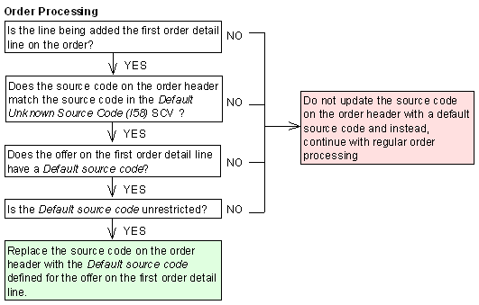

Default Unknown Source Code Logic
During order processing:
1. When you add the first order detail line to the order, the system determines if the source code on the order header matches the source code defined in the Default Unknown Source Code (I58) system control value.
2. If the source code on the order header matches the source code in the Default Unknown Source Code (I58) system control value, the system determines if the offer on the first order detail line has a source code defined in the Default source field. Note: The system does not check the offer’s End date to verify that the offer has not expired.
3. If the offer on the first order detail line has a source code defined in the Default source field, the system looks at the Restricted field to determine if the source code is restricted.
4. If the source code is not restricted, the system replaces the source code on the order header with the Default source defined for the offer on the first order detail line. The pricing method, freight, promotions, and discounts are applied to the order based on the new source code on the order header.
If the above conditions are not met, the system does not update the source code on the order header with the default source code defined for the offer on the first order detail line.
Additionally, if the system updates the source code on the order header to the default source code defined for the offer on the first order detail line and then the source code on the order header is updated (either manually by the order entry operator or by a system update), the system does not reevaluate the source code on the order header to determine if it should be updated again.
