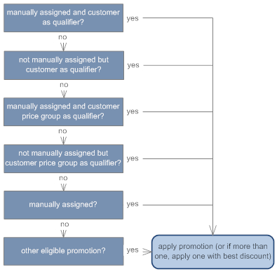

Best way promotion hierarchy: The Best Way Promotions (K44) system control value indicates whether to try to apply the promotion of each type (with the exception of BOGO promotions; see Best Way Promotion Hierarchy for BOGO Promotions) specifically called out for the order or customer, or that provides the highest discount. With this system control value selected, the system uses three basic criteria:
• Manual entry? Manually-entered promotions (entered at the Enter Promotion Code Screen or passed in the inbound order message) are preferred over system-assigned promotions (applied automatically because the order is eligible and the Required entry flag is unselected). However, if the Allow Manual Entry of Promotion Code (I63) system control value is unselected, it is not possible to manually enter a promotion code.
• Customer or customer price group assignment? When you specify a customer price group for a promotion, the system prefers this promotion to those without a customer price group assignment. However, when you specify a particular customer number for a promotion, this gives the promotion higher priority than promotions with just a customer price group promotion.
• Best savings? If a promotion is not differentiated through manual entry, customer assignment, or customer price group assignment, the system selects the promotion of each type that provides the highest total discount dollar value. In the case of a freight promotion, a ship via override is determined to be the best value.
As a result, the system selects among eligible promotions using the hierarchy illustrated below:
If the Allow Manual Entry of Promotion Code (I63) system control value is unselected, manual entry of a promotion is not possible, so the hierarchy is simpler:
1. Customer qualifier? Is the customer specified at the Work with Qualifying Customer/Price Groups Screen?
2. Customer price group qualifier? Is the customer assigned to a customer price group specified at the Work with Qualifying Customer/Price Groups Screen?
3. Best savings? If the customer does not qualify based on customer number or price group, or if the system must select among more than one promotion with the same qualifier, it selects the promotion of each type that provides the highest total discount dollar value.

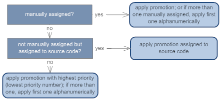

When the Best Way Promotions (K44) system control value is selected, BOGO promotions do not use the same hierarchy as other promotion types; instead, they use a simpler hierarchy:
1. Manually assigned? Manually-entered BOGO promotions (entered at the Enter Promotion Code Screen or passed in the inbound order message) are given higher priority than system-assigned promotions (applied automatically because the order is eligible and the Required entry flag is unselected). However, if the Allow Manual Entry of Promotion Code (I63) system control value is unselected, it is not possible to manually enter a promotion code.
2. Assigned to source code: If there is a BOGO promotion specified for the source code and no other BOGO promotion was manually entered, the promotion from the source code applies. (The promotion must be manually entered or passed in the order API, or have the Required entry flag unselected, as described above.)
3. Priority: If no BOGO promotions are manually applied or assigned to the source code, the system checks for BOGO promotions that are not flagged for Required entry. If there is more than one, the BOGO promotion with the highest priority (lowest priority number) applies. If the eligible BOGO promotions have the same priority number, the system applies the first one alphanumerically.
