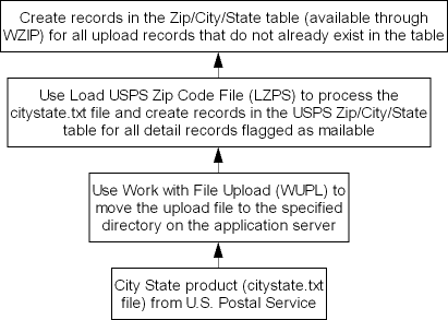

1. Download the City State Product from the USPS web site: https://ribbs.usps.gov/. When you receive the City State product, use the Working with File Uploads (WUPL) menu option to copy the data file to the location on your application server specified in the CWDIRECTCP_ USPS_UPLOAD_ FILE property. An example directory is /domain/conf/CWSerenade/LZIP/ctystate.txt/, where domain is the WebLogic domain directory for Order Management System.
2. Use the Load USPS File Screen to submit the LZPS job, which uses the contents of the ctystate.txt data file to create records in the Zip/City/State table if these records do not already exist. The job performs the following steps:
- Deletes any existing records in the USPS Zip/City/State work table and creates a record in this table for each eligible entry from the ctystate.txt data file. A record in the data file is eligible for upload if it is flagged with a D (detail) and is also flagged as mailable. See the Fields in the USPS Zip/City/State Table for mapping details.
- Compares the data in the USPS Zip/City/State work table with the existing records in the Zip/City/State table. If a record in the work table does not exist in the Zip/City/State table, the job creates it.
- If your current logging level supports it, the job uses the Application Log to track data such as the total number of records found in the data file and the total number of new records created in the.Zip/City/State table.
