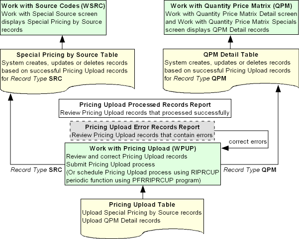

Pricing Upload Interface allows you to upload Special Pricing by Source records and Quantity Price Matrix Detail records from an external system.
Special pricing by source allows you to define special pricing for an item that is ordered for the specified source code. The system applies the item discount automatically when the customer orders the item in the required quantity from the source code. You can define a discount price for regular customers and associate customers; the system updates the order line with *Special Source Price as the pricing method. You can create, review, and update special pricing by source on the Work with Special Source Price Screen in the Working with Source Codes (WSRC) menu option.
Quantity price matrix pricing allows you to define special pricing for a specific item and SKU, item, or item category. You can define additional pricing for a specific sold to customer, customer price group, source code, and item category. The system updates the order line with *Qty Price Matrix as the pricing method. You can create, review, and update quantity price matrix pricing on the Work with Quantity Price Matrix Details Screen and Work with Quantity Price Matrix Specials Screen in the Working with Quantity Price Matrix (WQPM) menu option.
In this chapter:
- Pricing Upload Interface Errors
• Uploading Special Pricing by Source Records
- Special Pricing by Source Table Updates
• Uploading Quantity Price Matrix Detail Records
For more information: See Work with Pricing Upload (WPUP).
Use the following steps to upload Special Pricing by Source records and Quantity Price Matrix Detail records from an external system.
1. |
Populate the Pricing Upload Table with Special Pricing by Source and Quantity Price Matrix Detail records from an external system. |
2. |
Review, and optionally change, the Pricing Upload records in the Work with Pricing Upload (WPUP) menu option. |
3. |
When you are ready to upload the records from the Pricing Upload table, use the Work with Pricing Upload Screen to submit the Pricing Upload process. The Record Type field indicates whether the record is a Special Pricing by Source Upload record or Quantity Price Matrix Detail Upload record. • Record Type SRC indicates the record is a Special Pricing by Source Upload record. See Uploading Special Pricing by Source Records for processing details. • Record Type QPM indicates the record is a QPM Detail Upload record. See Uploading Quantity Price Matrix Detail Records for processing details. Scheduling the Pricing Upload process: You can also schedule the Pricing Upload process to run periodically by setting up the RIPRCUP periodic function using the PFRRIPRCUP program. See Scheduling Jobs for background. |
This table contains Special Pricing by Source Upload records and QPM Detail Upload records. You need to populate this table to create, update, and delete Special Pricing by Source records and QPM Detail records through the Pricing Upload Process.
Note: It is your responsibility to populate this table with pricing information from an external system.
The system performs the following validation when you upload a Special Pricing by Source record (Record Type SRC) through the Pricing Upload Interface.
1. |
Validates that the required fields for the Special Pricing by Source upload record in the Pricing Upload table contain information and the fields that require a valid value contain a valid value. The minimum fields required for a Special Pricing by Source upload record in the Pricing Upload Table are: • Company # (validated against the Company table) • Sequence # (must be unique for each record) • Record Type (must be SRC) • Request Type (must be U (create or update) or D (delete)) • Item (validated against the Item table) • Quantity • Price (cannot be greater than 7 positions with a 2 place decimal) • Source (validated against the Source table) In addition, you can also define: • Associate price (cannot be greater than 7 positions with a 2 place decimal) • Tax Price (cannot be greater than 7 positions with a 2 place decimal) • Associate Tax Price (cannot be greater than 7 positions with a 2 place decimal) See Pricing Upload Interface Errors for more information on the validation the system performs. |
2. |
Determines whether the Special Pricing by Source upload record in the Pricing Upload table creates, updates, or deletes a Special Pricing by Source record in the Order Management System database. The system uses the Company #, Item, Source, and Quantity fields for the Pricing Upload record to determine if a match exists in the Special Pricing by Upload table. • If a match exists and the Request Type is U, the system updates the existing record. • If a match exists and the Request Type is D, the system deletes the existing record. • If a match does not exist and the Request Type is U, the system creates a new record. • If a match does not exist and the Request Type is D, the system places the upload record in an error status: Record does not exist for Dlt. |
3. |
Failed Special Pricing by Source Upload If the Special Pricing by Source Upload record in the Pricing Upload table does not pass validation, the system: • Prints the record on the Pricing Upload Error Records Report. • Retains the record in the Pricing Upload Table in an error status until the record is fixed or deleted. You can work with Pricing Upload records that are in an error status using the Work with Pricing Upload (WPUP) menu option. |
4. |
Successful Special Pricing by Source Upload If the Special Pricing by Source Upload record in the Pricing Upload table passes validation, the system: • Creates, updates, or deletes the Special Pricing by Source record. See Special Pricing by Source Table Updates for more information on how the system creates or updates a Special Pricing by Source record. • Deletes the record from the Pricing Upload Table. • Prints the Special Pricing by Source Upload record on the Pricing Upload Processed Records Report. You can review or maintain Special Pricing by Source records on the Work with Special Source Price Screen in the Working with Source Codes (WSRC) menu option. |
The system uses the information defined in the Pricing Upload table to create, update, or delete a record in the Special Pricing by Source table in the Order Management System database.
You can review Special Pricing by Source records on the Work with Special Source Price Screen in the Working with Source Codes (WSRC) menu option. See this screen for complete field descriptions.
The system performs the following validation when you upload a Quantity Price Matrix Detail record (Record Type QPM) through the Pricing Upload Interface.
1. |
Validates that the required fields for the QPM Detail upload record in the Pricing Upload table contain information and the fields that require a valid value contain a valid value. The minimum fields required for a QPM Detail upload record in the Pricing Upload Table are: • Company # (validated against the Company table) • Sequence # (must be unique for each record) • Record Type (must be QPM) • Request Type (must be U (create or update) or D (delete)) • Item (validated against the Item table) or Item Category (validated against the Item Category table), but not both • Quantity • Price or Discount %, but not both (if you define a discount % you must also specify a Customer Sold To # or Customer Price Group, and/or Source) In addition, you can also define: • Customer Sold To # or Customer Price Group, but not both • Source Note: You cannot create more than one quantity price matrix detail for the same item category and quantity, item and quantity, or item and SKU and quantity. See Pricing Upload Interface Errors for more information on the validation the system performs. |
2. |
Determines whether the QPM Detail upload record in the Pricing Upload table creates, updates, or deletes a QPM Detail record in the Order Management System database. The system uses the Company #, QPM Code, Quantity, Source, either the Item Category or Item and SKU, and either the Customer Sold To # or Customer Price Group, for the Pricing Upload record to determine if a match exists in the Special Pricing by Upload table. See • If a match exists and the Request Type is U, the system updates the existing record. • If a match exists and the Request Type is D, the system deletes the existing record. • If a match does not exist and the Request Type is U, the system creates a new record. • If a match does not exist and the Request Type is D, the system places the upload record in an error status: Record does not exist for Dlt. |
3. |
Failed QPM Detail Upload If the QPM Detail Upload record in the Pricing Upload table does not pass validation, the system: • Updates the Status of the record in the Pricing Upload Table to E (Error). • Prints the Pricing Upload record on the Pricing Upload Error Records Report. • Retains the record in the Pricing Upload Table in an error status until the record is fixed or deleted. You can work with Pricing Upload records that are in an error status using the Work with Pricing Upload (WPUP) menu option. |
4. |
Successful Special Pricing by Source Upload If the QPM Detail Upload record in the Pricing Upload table passes validation, the system: • Updates the Status of the record in the Pricing Upload Table to P (Processed). • Prints the Pricing Upload record on the Pricing Upload Processed Records Report. • Creates, updates, or deletes the QPM Detail record. See QPM Detail Table Updates for more information on how the system creates or updates a QPM Detail record. • Deletes the record from the Pricing Upload Table. You can review or maintain QPM Detail records in the Working with Quantity Price Matrix (WQPM) menu option. • Records without a Discount %, Customer Sold To #, Customer Price Group, and Source can be viewed on the Work with Quantity Price Matrix Details Screen. • Records with a Discount %, Customer Sold To #, Customer Price Group, or Source can be viewed on the Work with Quantity Price Matrix Specials Screen. |
The system uses the information defined in the Pricing Upload table to create, update, or delete a record in the QPM Detail table in the Order Management System database.
You can review QPM Details on the Work with Quantity Price Matrix Details Screen and Work with Quantity Price Matrix Specials Screen in the Working with Quantity Price Matrix (WQPM) menu option. See these screens for complete field descriptions.
