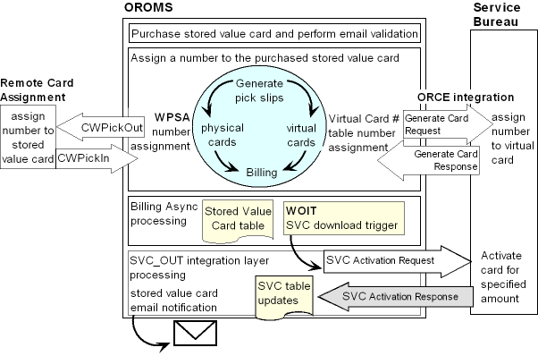

Purpose: You can purchase a stored value card item on an order to deliver to the recipient card holder by mail or email. However, before the recipient card holder can use the stored value card as a form of payment, the card must be activated by the service bureau.
Activation processing: To activate a stored value card:
1. |
A customer purchases a stored value card item on an order. If the stored value card is a virtual card, the system verifies that an email address is defined for the recipient card holder. See Purchasing a Stored Value Card. |
2. |
During pick slip preparation, the system creates a separate pre-generated pick for each physical stored value card. • After the picks are printed, you must: - Use Working with Physical Stored Value Card Assignment (WPSA) to assign a number to physical stored value cards by pick control number, OR - If you use an external system to assign numbers to physical cards, receive the card number in the CWPickIn XML Message. See Assigning Numbers to Physical Stored Value Cards for additional details. • For virtual stored value cards, during pick slip generation the system: - Assigns a number to the card from the Virtual Card Number Table (FLSVCA), OR - If you are using the Customer Engagement Stored Value Card Integration, assigns a number to the card by sending a Oracle Retail Customer Engagement Generate Card Request to the Oracle Retail Customer Engagement system. |
3. |
Once the stored value card is billed (see Billing a Stored Value Card), the system generates an SVC download trigger containing the information required to activate the card. |
4. |
The system sends a stored value card activation request to the service bureau for activation. • If the Use Activation / Reversal Batch Processing (I50) system control value is selected, the system does not process the SVC download trigger until you submit the batch process from the Transmitting Activation and Reversal Transactions (SSVC) menu option. In this situation, the SVC Activation integration layer job can remain inactive. • If the Use Activation / Reversal Batch Processing (I50) system control value is unselected, when active, the SVC Activation integration layer job monitors for SVC download trigger records to process immediately. |
5. |
Once an approved stored value card activation is received from the service bureau, the system updates the stored value card and sends a Stored Value Card Notification Email to the customer, if defined, indicating the stored value card activation information. |
Stored Value Card Activation Process:

1. |
Creates an SVC download trigger when an order containing a stored value card item assigned a number is billed; see Identifying SVC Download Triggers. |
2. |
Looks for unprocessed SVC download triggers to process, based on the setting of the Use Activation / Reversal Batch Processing (I50) system control value. • If this system control value is selected, the system does not process the stored value card trigger records until you submit the batch process using the Transmitting Activation and Reversal Transactions (SSVC) menu option or the SVCACT periodic function (program name PFR0076). In this situation, the SVC Activation integration layer job can remain inactive. • If this system control value is unselected, when active, the SVC Activation integration layer job monitors for stored value card download trigger records to process at defined intervals, based on the Outbound delay time. The system: • looks for SVC download triggers with the File code SVC and a status of ready (R). • determines which stored value card activation to download, based on the Key field for the activation download trigger. • looks for a record in the Stored Value Card Table that contains this information. |
3. |
Looks at the Stored Value Card Activation Authorization Service (I26) system control value to determine the service bureau used to activate stored value cards. |
4. |
Looks at the Communication type field for the service bureau to determine how transactions are processed between Order Management System and the service bureau. • Integration Layer = The system sends activation transactions to the service bureau using the queues defined for the activation integration layer job. • Payment Link = Point-to-point integration. The system sends activation transactions to the service bureau using a point-to-point integration. You must define communication settings in Working with Customer Properties (PROP). The system does not use the activation integration layer job to communicate with the service bureau; however, the system uses the job to process activation triggers. See Process Activations Using Payment Link Communication. |
Process Activations Using Payment Link Communication If the Communication type field for the service bureau is Payment Link: • Order Management System uses the settings in Working with Customer Properties (PROP) to send the activation request directly to the service bureau in the format of the other system. • The service bureau receives the activation request, processes the activation, and sends a response back to Order Management System. See Processing Authorizations and Deposits Using Point-to-Point Communication for a list of integrations that support point-to-point communication. |
5. |
Order Management System processes the activation response accordingly. See: • What Happens When the Stored Value Card Activation is Approved? • What Happens When the Stored Value Card Activation is Declined? |
