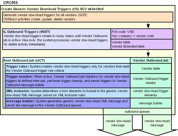

Purpose: Order Management System allows you to capture vendor information to download to another system, such as a retail store or warehouse management system.
Vendor information flow: This flowchart explains how vendor information is downloaded from Order Management System.

Vendor Download Process
The system creates vendor download triggers in the IL Outbound Trigger table when a vendor is created, updated, or deleted. The Vendor Outbound job in the Working with Integration Layer Processes (IJCT) menu option monitors the IL Outbound table for vendor download triggers to process and generates a Vendor Download XML Message (CWVendorOut) to send to the remote system.
Identifying Vendor Download Triggers
You can view all download triggers in the IL Outbound Trigger table at the Work with Outbound Interface Transactions Screen.
Each trigger in the IL Outbound Trigger table contains a:
File code: indicating the type of information to download and which IL process job processes the trigger. For vendor download triggers, the File code is VND.
Key: indicating the specific record to download. For vendor download triggers, the Key identifies the specific company and vendor associated with the vendor download trigger. For example, the Key 5550002006 indicates the vendor information is located in company 555 for vendor 2006.
Capture type: indicating the type of activity performed against the record:
- A = the vendor was created.
- C = the vendor was maintained. Note: The system removes any duplicate change triggers; see Vendor Trigger Cleanup.
- D = The vendor was deleted. Note: The system processes delete triggers immediately; see Processing Vendor Delete Triggers.

To generate a vendor download message, the system:
1. Creates vendor download triggers, based on Order Management System activities that create, update, or delete vendors. See Vendor Outbound Trigger Activities for a list of the activities that create vendor download triggers.
2. Evaluates the trigger rules defined for the Vendor Outbound job to determine if the vendor download trigger is created. Vendor Outbound trigger rules define the criteria the vendor must meet in order for the system to create a vendor download trigger. See Vendor Outbound Trigger Rules.
3. When active, the trigger monitor defined for the Vendor Outbound job looks for unprocessed vendor download triggers to process at defined intervals, based on the Outbound delay time.
The Vendor Outbound trigger monitor:
• looks for vendor download triggers with the File code VND and a status of ready (R).
• removes duplicate vendor download triggers. See Vendor Trigger Cleanup.
• determines which vendor to download, based on the Key field for the vendor download trigger. The Key field for vendor download triggers consists of company + vendor code. For example, the Key 5550002006 indicates the vendor information is located in company 555 for vendor 2006.
• sends each vendor download trigger to the message builder defined for the Vendor Outbound job.
Note: The system creates a vendor download message for vendor outbound triggers with a delete (D) Capture type immediately, regardless if the Vendor Outbound job is active or inactive; see Processing Vendor Delete Triggers.
4. For each vendor download trigger, the message builder defined for the Vendor Outbound job determines which elements to include in the vendor download message, based on XML inclusion rules; see Vendor Outbound XML Inclusion.
5. The Vendor Outbound message builder sends the generated vendor download messages to the queues defined for the Vendor Outbound job whose Enabled field is selected. See Outbound Interface Queues.
