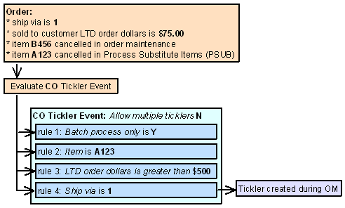

Example 1: Allow multiple ticklers is unselected for the CO event.
The following event rules are defined for the CO event, displayed in processing sequence order.
• Event rule 1: Batch process only is selected
• Event rule 2: Item is A123
• Event rule 3: LTD order dollars is greater than 500
• Event rule 4: Ship via is 1
You enter an order and:
• the ship via on the order header is 1.
• the items on the order are A123 and B456.
• the sold to customer’s life-to-date order dollars is $75.00.
• in order maintenance, you cancel order line 1 for item B456.
• in Processing Item Substitutions (PSUB), you cancel item A123.
In this scenario, the system creates 1 tickler during order maintenance for rule 4: Ship via is 1. The system does not create a tickler for the other rules whose criteria are met. The system does not create a tickler during Process Substitute Items since a CO tickler already exists for the order/order ship to.

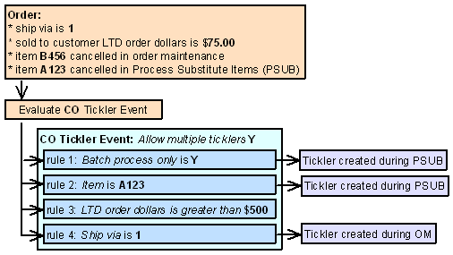

Example 2: Allow multiple ticklers is selected for the CO event.
The system creates 2 ticklers during Process Substitute Items:
• the first tickler is created for rule 1: Batch process only is selected.
• the second tickler is created for rule 2: Item is A123.
A tickler is not created for rule 3 during Process Substitute Items because a tickler already exists for that order using that rule.
