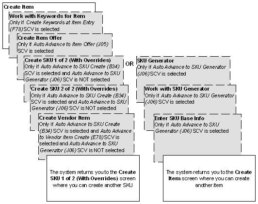

Creating SKUed items screen flow: Select the SKUs field on the Create Item Screen to create a SKUed item. The system automatically advances you through the following screens to create a SKUed item.
1. |
2. |
First Work with Keywords for Item Screen (only if the Create Keywords at Item Entry (F78) system control value is selected) |
3. |
Create Item Offer Screen (only if the Auto Advance to Item Offer (J05) system control value is selected) |
4. |
Depending on whether you are using the SKU Generator: • Create SKU 1 of 2 (With Overrides) Screen (only if the Auto Advance to SKU Create (B34) system control value is selected and the Auto Advance to SKU Generator (J06) system control value is unselected) • SKU Generator Screen (Entering SKU Information) (only if the Auto Advance to SKU Generator (J06) system control value is selected) |
5. |
Depending on whether you are using the SKU Generator: • Create SKU 2 of 2 (With Overrides) Screen (only if the Auto Advance to SKU Create (B34) system control value is selected and the Auto Advance to SKU Generator (J06) system control value is unselected) • Work with SKU Generator Screen (only if the Auto Advance to SKU Generator (J06) system control value is selected) |
6. |
Depending on whether you are using the SKU Generator: • Create Vendor Item Screen (only if the Auto Advance to SKU Create (B34) system control value is selected, the Auto Advance to Vendor Item Create (E78) system control value is set to Yselected and the Auto Advance to SKU Generator (J06) system control value is unselected) • Enter SKU Base Information Pop-Up Window (only if the Auto Advance to SKU Generator (J06) system control value is selected) |
Once you have completed creating the item and SKU, the system returns you to the:
• Create SKU 1 of 2 (With Overrides) Screen if you are not using the SKU Generator, where you can create another SKU.
• Create Item Screen if you are using the SKU Generator, where you can create another item.
