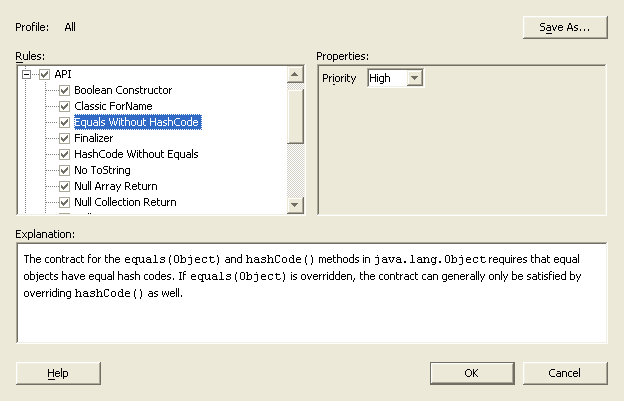

The view of a profile that Audit presents to users is one of rules with properties, with no hint of analyzers:
In this view,
Audit builds this view by iterating through the analyzers in the profile, getting from each analyzer the rules which it analyzes, and organizing them by their categories. The rules are themselves beans with properties, a couple of which are used by Audit. An analyzer can add extra properties to rules it defines, allowing the user to configure its analysis. User changes to property values are saved with the profile.
