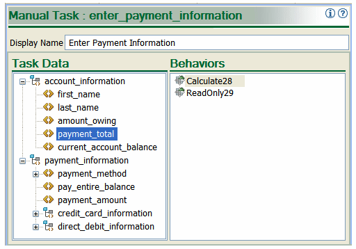

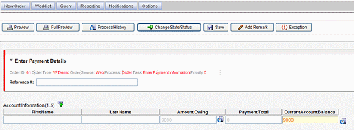

You can model behaviors in tasks and in orders. Figure 9-1 shows how behaviors are modeled in a task that enters payment information. In this figure, the field that shows the payment total uses two behaviors:
  • A Calculation behavior that adds values in multiple other fields to create the total payment value.
  • A Read Only behavior that makes the field read-only in the Task web client.
The examples are for illustrative purposes only; OSM is not typically used for payment handling.
Figure 9-1 Behaviors Used in a Task
Shows how behaviors are modeled in a task

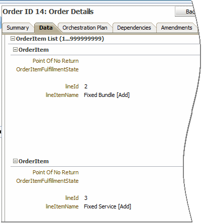

Figure 9-2 shows a behavior modeled in an order. This behavior is used by an order to display a tool tip for the payment information field.
Figure 9-2 Information Behavior Modeled in Oracle Communications Design Studio
Shows a behavior modeled in an order.

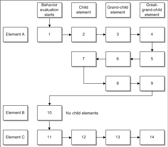

OSM automatically evaluates behaviors whenever you retrieve, save, or transition an order. OSM evaluates the behaviors in a specific nested sequence, as outlined below:
  1. The system evaluates all behaviors for a given node before moving to the next node in the order.
    The next node in the order is based on a depth first, left-to-right traversal.
    Figure 9-3 shows the element selection order.
    Figure 9-3 Element Selection

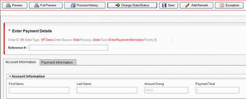

You use the Calculation behavior to calculate a field's value based on a formula that references other field values. You can perform numeric operations and string concatenations.
OSM supports the Calculation behavior in the Task web client and in the Order Management web client Data tab.
For example, you can use the following expression in a Calculation behavior to calculate the current balance for a customer:
../amount_owing - sum(../../payment_information/payment_amount)
In this example, the current balance displays the value from the amount_owing field after subtracting the value from the payment_amount field; the balance = (amount owed) - (amount paid).

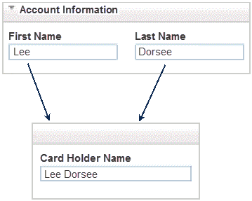

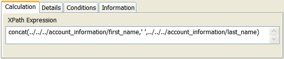

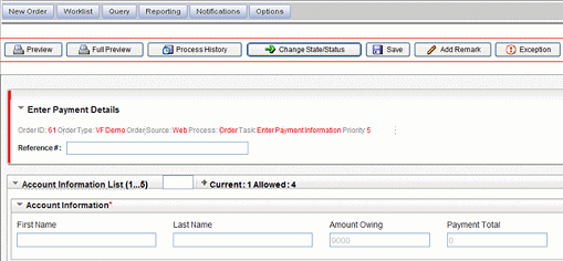

Figure 9-4 shows an XPath expression that combines the first_name field and the last_name field. The Calculation behavior is applied to a field that contains the card-holder name field, where the first and last names are combined into a single field value.
Figure 9-4 Calculate Behavior Formula for Combining String Values
Shows an XPath expression.

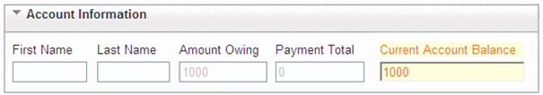

Figure 9-5 shows how the fields appear in the Task web client.
Figure 9-5 Values from Two Fields Combined into One Field
Shows how fields appear in Task Web client.

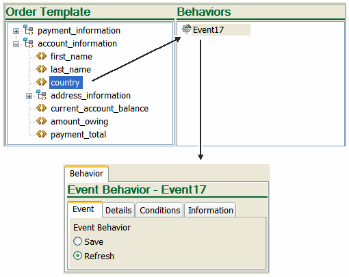

Using the Event Behavior to Re-evaluate Data
You can use the Event behavior to save or refresh data when the data changes. This is useful when a change in a field can cause a behavior to automatically occur in the same field or in another field. For example, you might include an Event behavior in the account_information/country field, that causes the data to refresh. That refreshed data might in turn be used by a Relevant behavior assigned to the address details fields that display address information based on the country.
Refreshing causes OSM to re-evaluate all the behaviors associated with the task but does not save the order. Saving re-evaluates the behaviors and automatically saves the contents of the order.
Figure 9-6 shows an Event behavior defined in Design Studio. In this figure, the Event behavior refreshes the data in the account_information/country field.
Figure 9-6 Event Behavior Defined in Design Studio
Shows an Event behavior defined in Design Studio.
See "Using the Relevant Behavior to Specify if Data Should Be Displayed in the Web Client" for more information on the Relevant behavior, and this scenario in particular.
OSM supports the Event behavior in the Task web client.

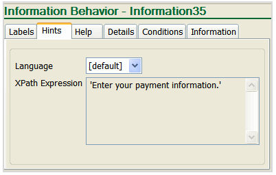

Using the Information Behavior to Display Data and Online Help
You can use the Information behavior to specify how data is displayed in the OSM Task web client. You can do the following:
  • Set an alternative label for the field. For example, instead of the standard label State, the field can be changed to State or Province when processing the type of order that uses this behavior setting.
  • Localize the field label to one or more different languages.
  • Set a tool tip on a field.
  • Provide an online help topic for the field.
In the Order Management web client, any information rule on the first instance of a group node that uses a table layout style is used to determine the text of the table panel header. The first instance of each of this group instance's child field nodes are used to determine the column header text for that field node. Hint text for the group instance row and child field instance cells are displayed as tooltip text. Help defined for the group can be executed with either a menu item in the table's Actions menu or a row-level context menu and displays help in a modal window in the page containing the table. The implementation of this help behavior differs from the Task web client implementation, which uses an icon in each table cell to load the help in a separate browser window.
OSM triggers information rules when the data element or structure contains data, (for example, from the incoming order or derived from other data sources). If the data element or structure is empty, OSM does not display any label, hint, or help topic information behaviors associated with the empty element or structure. For example, if you defined a label for an element, the label does not appear when the element does not contain a value. Instead, the OSM uses the Display Name of the element as defined in the data dictionary.

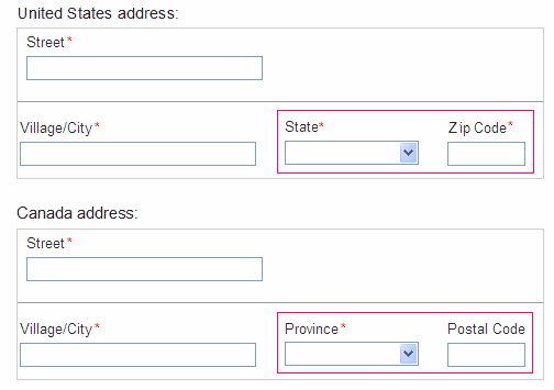

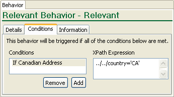

You can use the Relevant behavior to specify if data should be displayed in the Task web client or in the Order Management web Client Data tab, based on specified conditions.
For example, you can use the Relevant behavior to display address-input fields appropriate to the country that the order applies to. In this example, the Relevant behavior can be used as follows:
  • The data for the customer's country is included in the order's account_information/country field. This data is displayed in the Task web client in the Country/Region field.
  • Based on the data in the account_information/country field, the customer address fields (address_information) can include different values, depending on the country, as shown in Figure 9-7.
    The account_information/country field includes an Event behavior, which refreshes the data in the field, making it available to the Relevant behavior.
    Figure 9-7 Address Fields Based on Relevant Behavior
    Shows address fields.

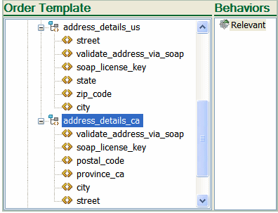

Figure 9-8 shows the address fields for the United States (address_details_us) and Canada (address_details_ca). The Relevant behavior applies to the selected data, address_details_ca.
Figure 9-8 Address Fields in Design Studio
Shows address fields in Design Studio.
Figure 9-9 shows the XPath expression that specifies the condition (country = Canada) under which the Relevant18 behavior is enabled.
Figure 9-9 Relevant Behavior Properties
In the Order Management web client, if a group instance displayed with a table style behavior is not relevant, then the entire associated table row is omitted. If a particular field is not relevant, the associated table cell is rendered empty.

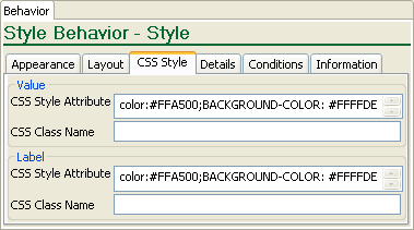

Figure 9-10 shows how the Style behavior changes the appearance of the Current Account Balance field in the Task web client.
Figure 9-10 Style Behavior Used in the Current Account Balance Field
Graphic is described in surrounding text.

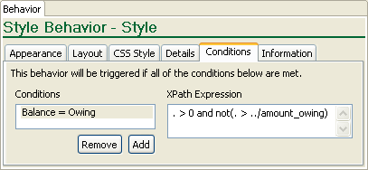

Figure 9-11 shows the condition that determines if the Style behavior should be applied. In this case, the Style behavior is applied if the account balance is the same as the amount owed.
Figure 9-11 Condition Defined in a Style Behavior
Figure 9-12 shows the style definitions to apply to a field.
Figure 9-12 Field Display Colors Defined in a Style Behavior
Figure 9-13 shows how three different conditions can change how the field is displayed. If the balance is zero, the field is green. If the balance is the same as the amount that the customer owes, the field is orange. If the balance is less than zero, or greater than the customer owes, the field is red.
Figure 9-13 How Style Behavior Conditions Are Used for Determining the Display Colors

The following figures illustrate the different types of available layouts for the Order Management web client. Each figure shows the same structure with a different layout type:
  • Figure 9-17 shows the structure with no layout applied.
  • Figure 9-18 shows the structure with the Table Layout option applied.
Figure 9-17 No Layout in the Order Management Web Client
Surrounding text describes Figure 9-17 .
Figure 9-18 Table Layout in the Order Management Web Client
Surrounding text describes Figure 9-18 .
