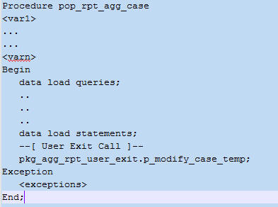

Figure 6-2 displays the structure of an out-of-the-box user exit.
Figure 6-2 Structure of an Out-of-the-box User Exit
An out-of-the-box user exit only has a null statement between the log handlers. You can add logic (as necessary) to insert, update, or delete rows from corresponding or related tables.

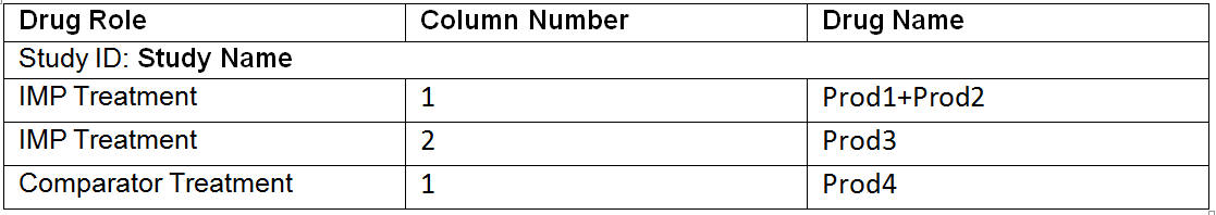

G3_DRUGKEY is the third group which prints Study and Comparator drugs in a table format.
Figure 6-3 Study and Comparator Drugs Format
In the summary tabulation, IMP 1 is printed under IMP Treatment1 and IMP 2 is printed under IMP Treatment2. The titles are configurable (flexible code list: BIP_PROD_CATEGORY).
