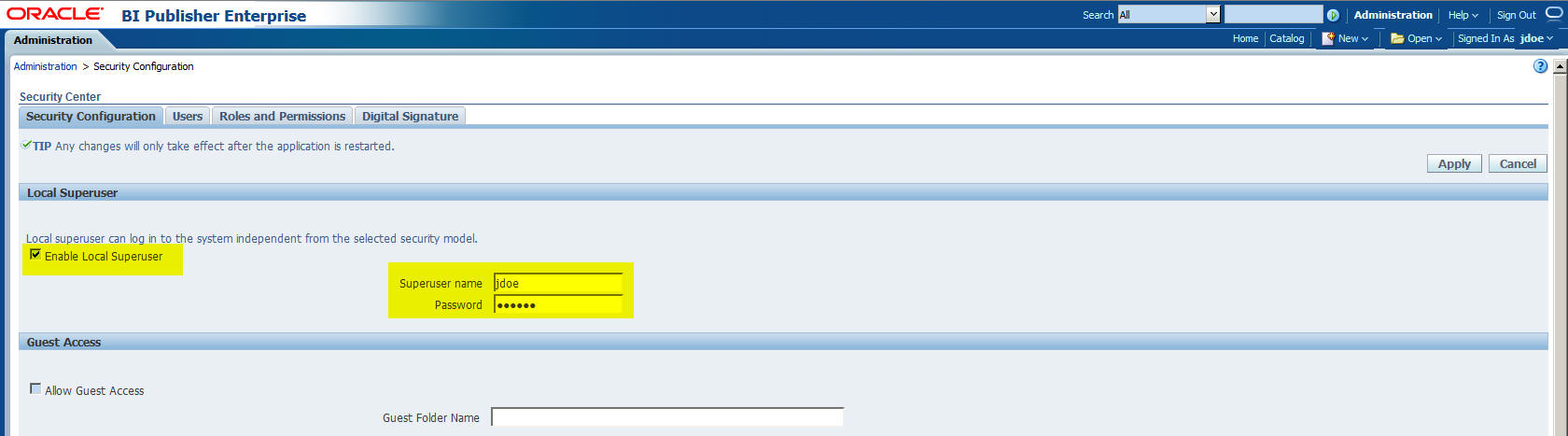

Enabling a Local Superuser
BI Publisher enables you to define an administration Superuser. Using the Superuser credentials you can directly access the BI Publisher administrative functions without logging in through the defined security model. Set up this Superuser to ensure access to all administrative functions in case of failures with the configured security model. It is highly recommended that you set up a Superuser.
To enable a local superuser:
  1. Click Administration.
  2. Under Security Center, click Security Configuration.
  3. Under Local Superuser, select the box and enter the credentials for the Superuser, as shown.
  4. Restart the BI Publisher service.
    Surrounding text describes image1.jpg.

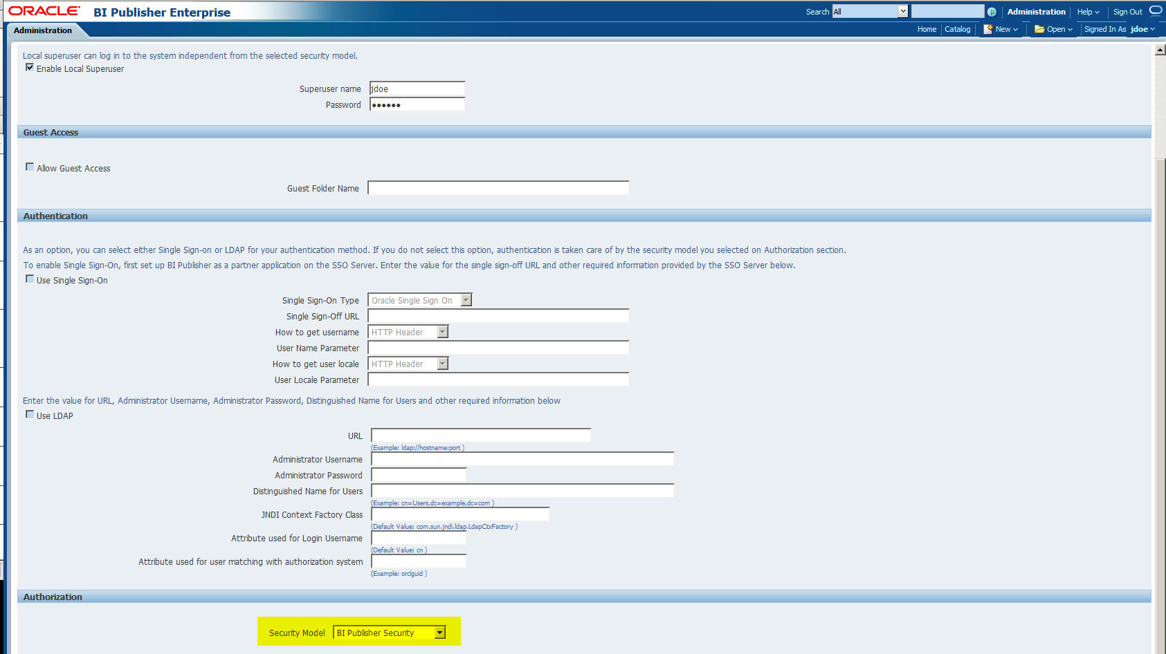

Configuring the Security Model
BI Publisher supports numerous security models. For Argus Safety 8.0, the following security models are supported:
  • BI Publisher Security (default)
  • Oracle Fusion Middleware
After setting up the security model, restart the BI Publisher server.
For more information about configuring BI Publisher over different security authentication and authorization models, refer to the BI Publisher Admin Guide.
The following sections of the BI Publisher setup are based on the default BI Publisher Security model. For more details about configuring the BI Publisher Security Model or Oracle Fusion Middleware Security set up, refer to the Extensibility Guide.
Surrounding text describes use2.jpg.

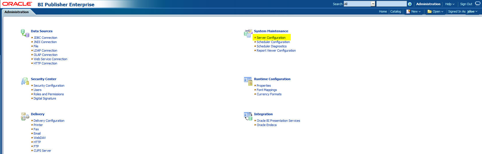

  3. Click Server Configuration in the System Maintenance section as highlighted in the following figure.
    Surrounding text describes image3.jpg.

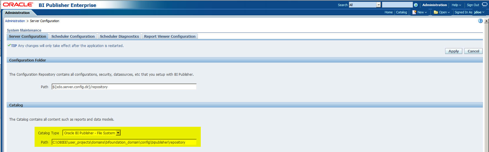

  4. In the Catalog section, select Oracle BI Publisher - File System from the Catalog Type drop-down list. If the Catalog Type is not Oracle BI Publisher - File System, the folder level permission settings cannot be done in BIP. Refer to the Oracle Business Intelligence Developer's Guide for more information.
    Only Oracle BI Publisher - File System is supported in this release.
  5. Enter the path where all BIP folders, data models, and BIP reports will be stored in the BIP server as highlighted in the following figure:
    Surrounding text describes image4.jpg.
  6. Click Apply to save the changes.
  7. Restart your BI Publisher service.

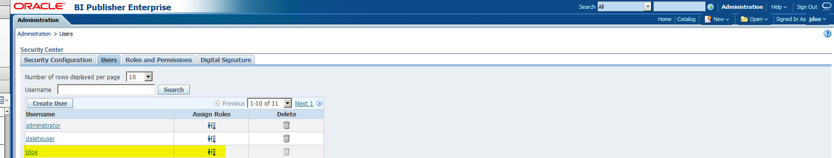

Creating Users and Assigning Roles
To create users and assign them roles in the BI Publisher Security Model, execute the following steps:

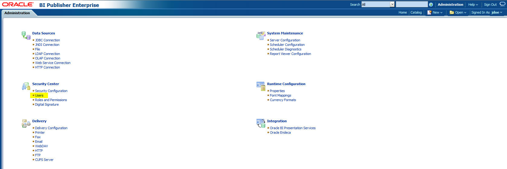

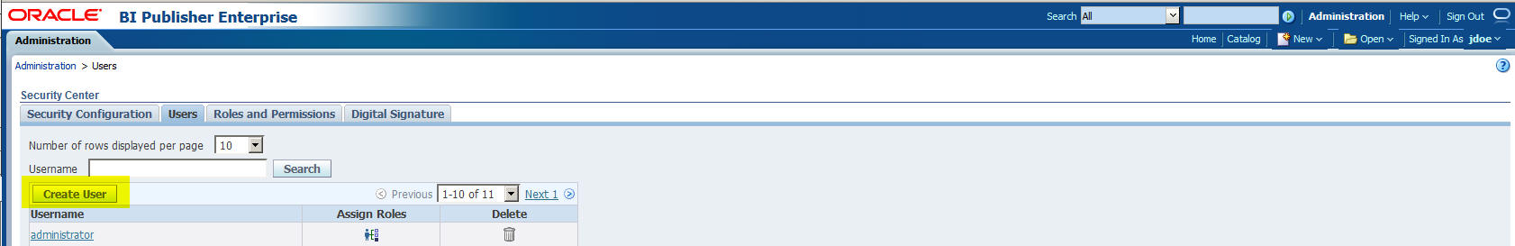

  1. Log in to BIP using administrator credentials. This displays the BIP Home Page.
  2. Click Administration.
  3. Click Users under Security Center.
    Surrounding text describes try1.jpg.
    This displays the Users screen.

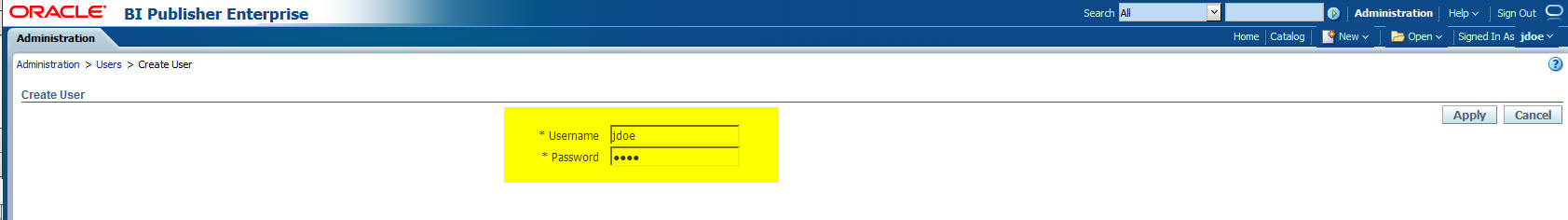

  4. Click Create User.
    Surrounding text describes try2.jpg.
    This displays the Create User screen.
    Surrounding text describes try3.jpg.
  5. Enter the name of the user in the Username field.
  6. Enter the password in the Password field.
  7. Click Apply. The name of the user is displayed in the list of existing users.
    Once you have created the user, you need to assign the required roles to the user.
  8. Click the Assign Roles icon corresponding to the user that you have created as highlighted in the following figure:
    Surrounding text describes try4.jpg.
This displays the Assign Roles Screen for the user. The BIP system roles such as BI Publisher Administrator, BI Publisher Excel Analyzer, BI Publisher Online Analyzer, BI Publisher Developer, BI Publisher Scheduler, and BI Publisher Template Designer are available by default along with the custom roles (if any) that have been created by you.

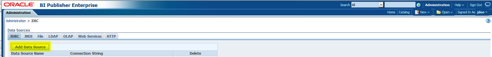

To connect the BIP and the database, execute the following steps:
  1. Log on to BIP using the administrator credentials. This displays the BIP Home Page.
  3. Click JDBC Connection under Data Sources.
    Surrounding text describes try5.jpg.
    This displays the Data Sources screen.
  4. Click Add Data Source.
    Surrounding text describes try6.jpg.

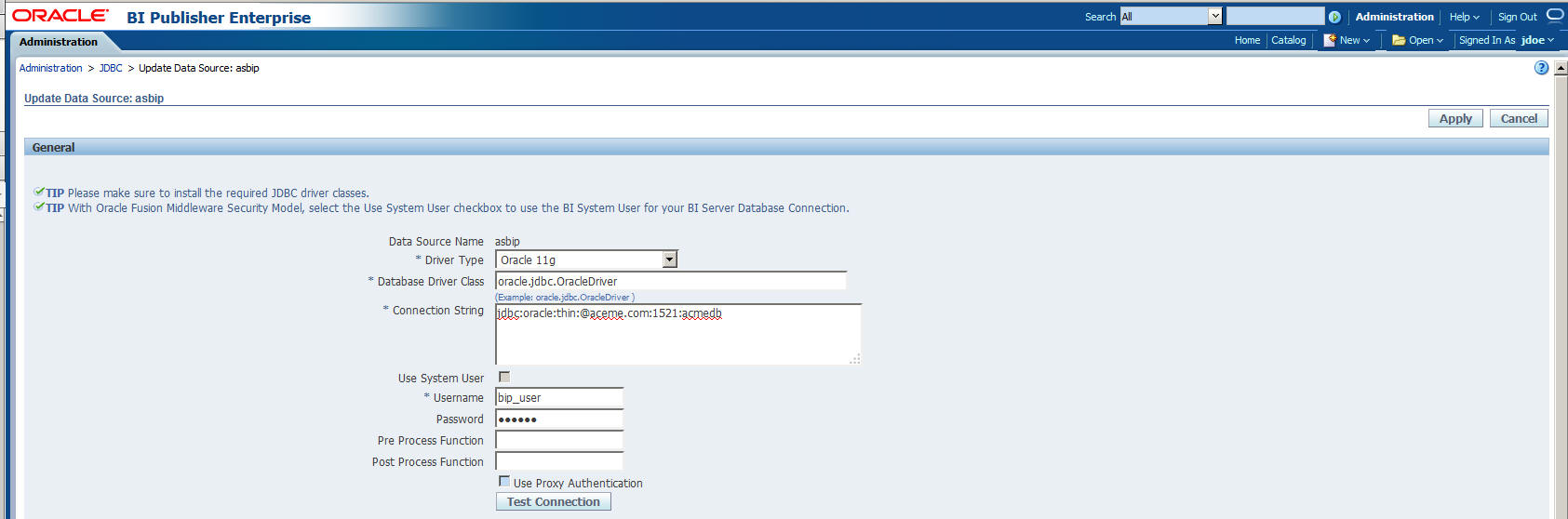

  5. In the Add Data Source section:
    • Enter asbip in the Data Source Name field. Make sure that you enter this data source name in lowercase only.
    • Select the database from the Driver Type drop-down list. This auto-populates the Database Driver Class field.
    • Enter the connection string in the Connection String field. You must enter all the details in lower case in this field.
    • Enter the username (Argus Safety BIP DB Schema user, for example, bip_user, which got created during Argus Safety database installation) to connect to the database in the Username field.
    Click Test Connection.
    Surrounding text describes try7.jpg.
    If successful, this displays a confirmation message.

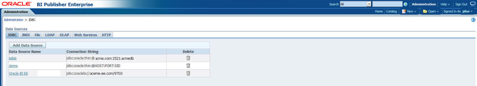

  6. Click Apply. This displays the ASBIP Data Source in the list of already existing data source names.
    Surrounding text describes try8.jpg.
    This successfully creates a connection between BIP and the database.

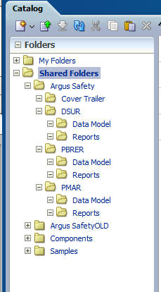

Uploading the Argus Safety.xdrz file to BIP
To upload the Argus Safety.xdrz file to BIP, execute the following steps:
  1. Copy the Argus Safety.xdrz file from the following location on the Argus Safety Web Server to the local file system:
    <Argus Installation Media>\SUPPORT\BIP

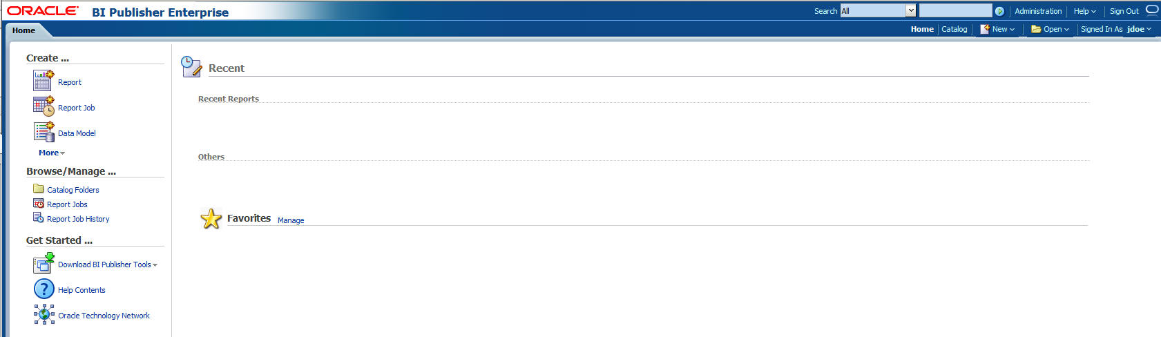

  2. Log in to BIP using BI Admin User credentials. This displays the BIP Home Page as depicted in the following figure:
    Surrounding text describes try9.jpg.

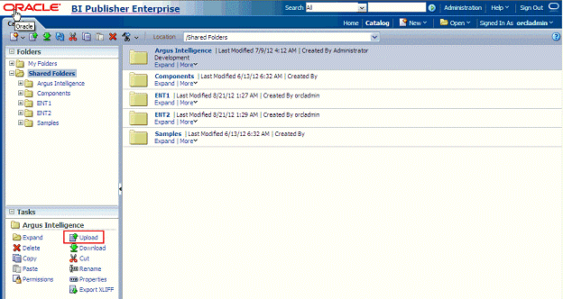

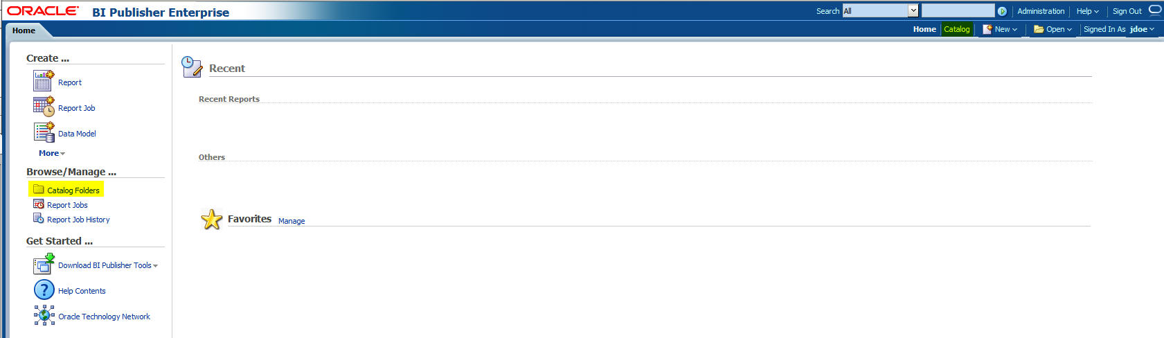

  3. Click Catalog.
    Surrounding text describes try10.jpg.
    This displays the Catalog screen with the Folders and Tasks sections.

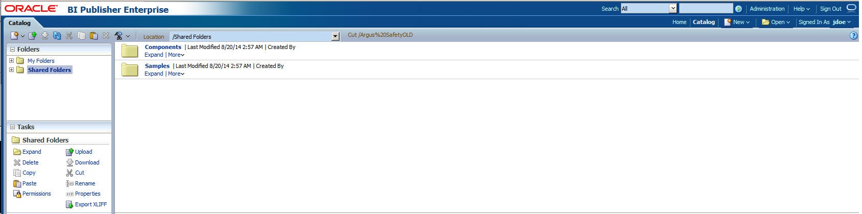

  4. Click Shared Folders under Folders.
    Surrounding text describes try11.jpg.

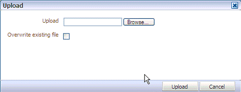

  5. Click Upload under Tasks.
    Surrounding text describes image017.gif.
    This displays the Upload dialog box.
    Surrounding text describes image018.gif.
  6. Click Browse and navigate to the location where you have saved the Argus Safety.xdrz file on the local file system.
  7. Click Upload. Once done, an Argus Safety folder is created in Shared Folders.
  8. Expand the Argus Safety folder to verify whether the following data model and reports are present. It should look as shown below:
    Surrounding text describes try12.jpg.

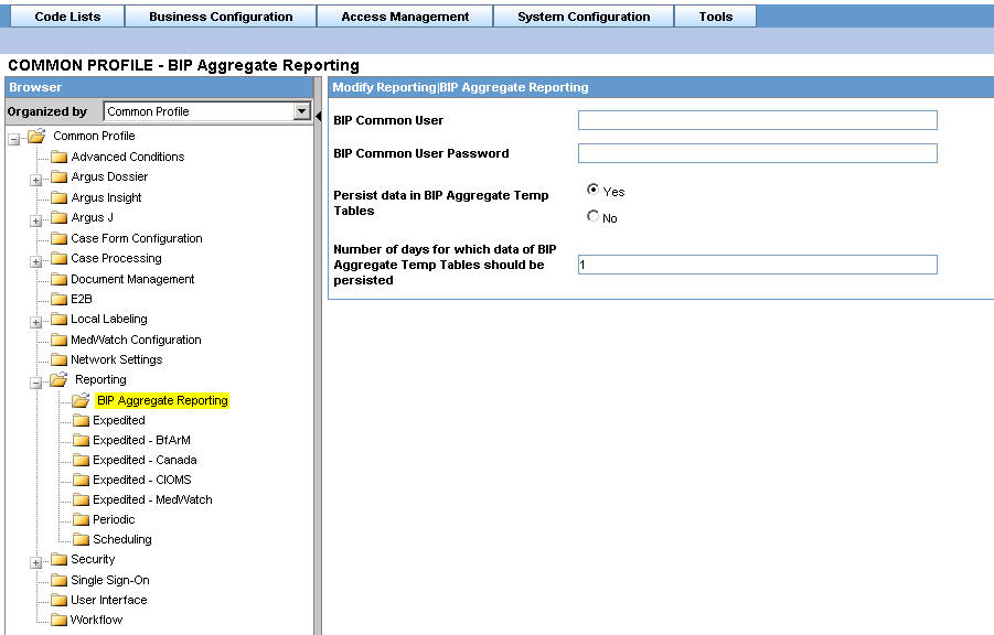

To enable execution of the BIP reports from Argus Safety UI, configure the following console settings:
  1. Navigate to Argus Console > Enabled Modules.
  2. Enable the BIP Aggregate Reports module.
  3. Add iisreset on webserver to ensure that the changes made to enable the BIP Aggregate Reports module are visible.
  4. Navigate to Argus Console > System Configuration > Common Profile Switches.
  5. Expand the Reporting node on the tree that appears on the left pane.
  6. Click BIP Aggregate Reporting.
    Surrounding text describes image5.jpg.
  7. In the BIP Common User and Password fields, enter the username and password of a BIP user having administrative permissions. Save the changes. Make sure that the BIP User added here is not same as that of an actual Argus user. It can be a user which is available only for BIP, with complete administrator privileges.
  8. Set the Persist data in BIP Aggregate Temp tables to Yes or No. The default value is No.
  9. Set the Number of days to persist the BIP Aggregate Temp table data. Defaulted to null.
    The Persist data parameters are used to logically retain the data from the BIP temp tables and purge them after the specified number of days.
Configuring Code Lists
For BIP Reports to be run from Argus Safety, the BIP Report template path in the BIP Server to be configured.
Execute the following steps to configure the report template path in Argus Safety:
  1. Navigate to Argus Console > Code Lists > Flexible Data Re-categorization.
  2. Under the Flexible Data Re-categorization tree, navigate to Flexible Re-categorization.
  3. Select the Code List Name as REPORT_TEMPLATE and click Search.
  4. Update the REPPATH as follows:
    • For PBRER - /Argus Safety/PBRER/Reports/pbrer.xdo
    • For PMAR - /Argus Safety/PMAR/Reports/pmar.xdo
    • For DSUR - /Argus Safety/DSUR/Reports/dsur.xdo
  5. Click Save.
    The REPPATH value may be different based on the uploaded path of the templates in the BIP Server.
