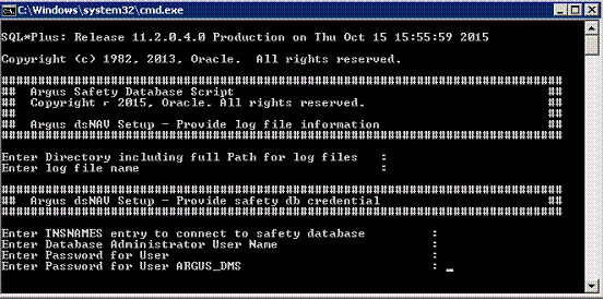

  1. Execute the batch file Setup_dsnav_centralized_coding.bat.
    Description of nav2.gif follows
    1. Provide a log folder name such as C:\DSnavLog.
    2. Provide a log file name.
    3. Provide the Argus Safety DB name.
    4. Provide database administrator name such as system and password.
    5. Provide the password for ARGUS_DMS schema.

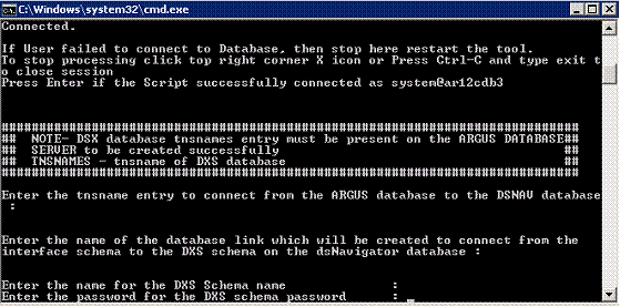

  2. Before proceeding, add the DXS Argus Centralized Coding database TNSNAMES entry on the Argus database server where the Interface schema was created.
    Description of nav3.gif follows
    a. Provide the TNSNAME of the DXS Argus Centralized Coding database.
    b. Provide the database link name that is created to connect from the Argus Interface schema to the DXS Argus Centralized Coding schema.
    c. Provide DSX schema name and password.
  3. If the credentials are successfully verified, a DBlink is created from the Argus Interface schema to the DXS Argus Centralized Coding schema.

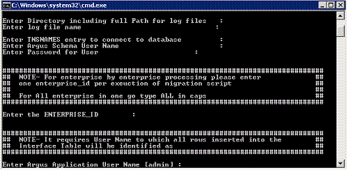

Execute the batch file dms_migration.bat.
Description of nav4.gif follows
  3. Enter the TNSNAMES of the Argus Safety database when the Interface schema was created.
  4. Provide the Argus Safety schema owner name and password.
  5. Depending on whether you want to migrate coded terms for all cases, one enterprise or for multiple enterprises:
    i. Enter the enterprise_id of one enterprise to migrate data for that particular enterprise.
    ii. Enter ALL as Input to migrate data for all enterprises.
    iii. To migrate coded terms of cases for more than one enterprise, execute step (i) multiple times and provide different enterprise_ids.
  6. Provide the application user name; if no input is provided, admin is taken as user input.
  7. Verify the log file to validate successful completion of the script.
