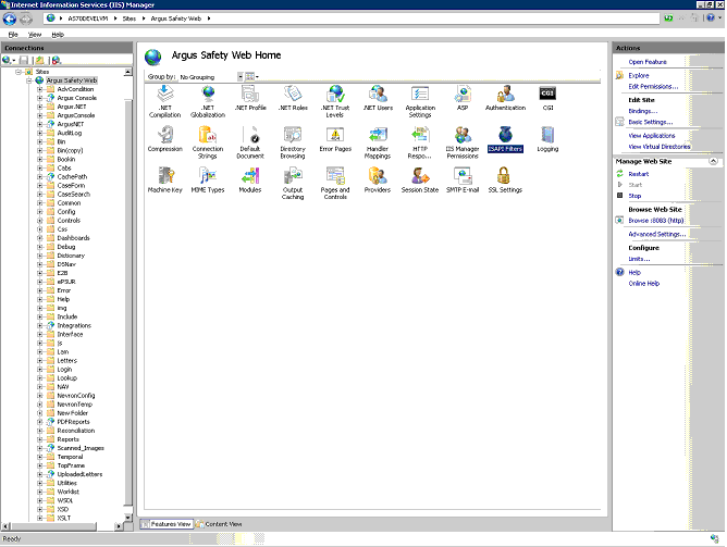

If you update the Argus.xml file, you must restart the Internet Information Services (IIS) on the server for the changes to take effect.

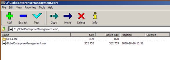

  1. Open the .ear file using a Zip utility. The zip program will open with files as seen below.
    Surrounding text describes image051.jpg.

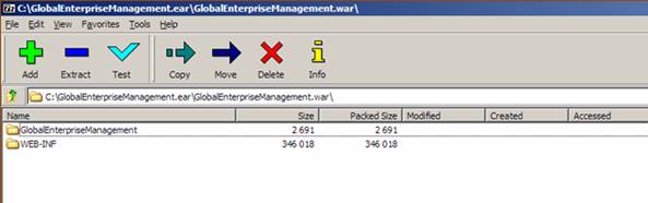

  2. Double click the .war file and you will see the following screen. Double Click the WEB-INF folder.
    Surrounding text describes image003.jpg.

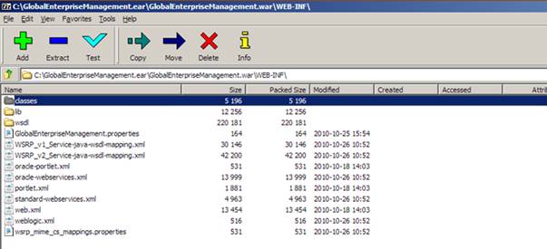

  3. Double click the file portletname.properties where portletname is the name of the portlet ear file under modification.
    Surrounding text describes image053.jpg.
  4. In the editor find the key named ”ArgusURL” and modify the URL value to the value of your Argus Web Server or Argus Web Load Balancer.
    ArgusUrl=http://10.178.91.250:8083. For OAM integration, Oracle recommends that using the FQDN of the machine.
    Surrounding text describes image054.jpg.

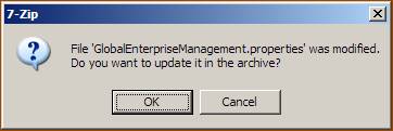

  5. Save the changes to the properties file and close it. Close the 7-zip manager window and press OK to save the changes in the archive. You are now ready to deploy the ear file.
    Surrounding text describes image055.jpg.

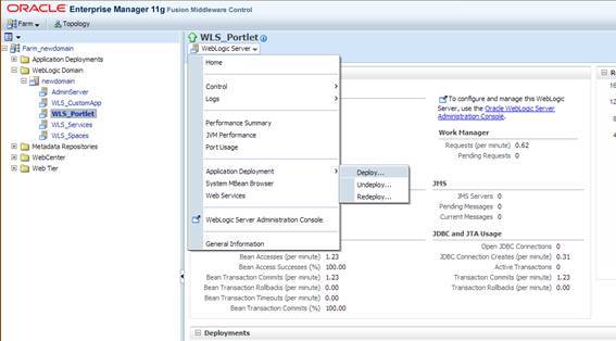

  6. Log in to the Oracle Enterprise Manager Admin Console and navigate to WebLogic Domain>Your Domain>WLS_Portlet. From the top left corner, navigate to Weblogic Server >Application Deployment>Deploy.
    Surrounding text describes image056.jpg.

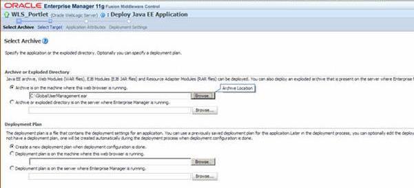

  7. Select Archive is on the machine where this web browser is running and click Browse. Browse to the modified .ear file on your local machine.
    Surrounding text describes image005.jpg.

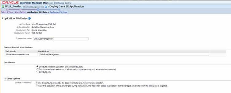

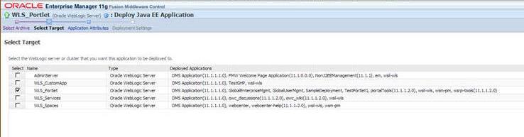

  9. Once the Portlet is uploaded, by default WLS_Portlet will be selected. If not then select and click Next.
    Surrounding text describes image059.jpg.
  10. Do not change the default selection. Click Next.

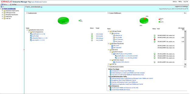

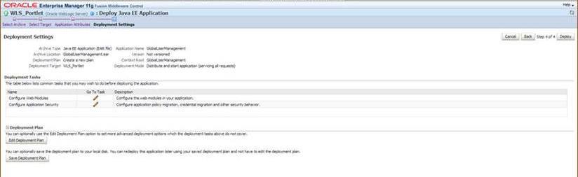

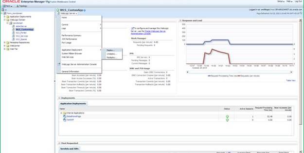

  1. Log in to the Enterprise Manager Admin console. In the left hand tree navigation, select WebLogic Domain>Your Domain>WLS_CustomApp in the left hand tree navigation. The WLS_CustomApp is the name of the server that we have created to deploy Global Home Page. Click the menu just below the name of the server as shown below. Navigate to Application Deployment > Deploy.
    Surrounding text describes image062.jpg.

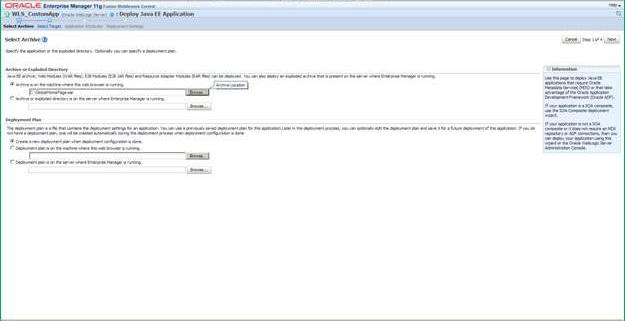

  2. Log in to the Enterprise Manager Admin console. In the left hand tree navigation, select WebLogic Domain>Your Domain>WLS_CustomApp in the left hand tree navigation. The WLS_CustomApp is the name of the server that we have created to deploy Global Home Page. Click the menu just below the name of the server as shown below. Navigate to Application Deployment > Deploy.

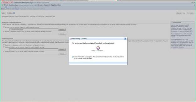

  3. The following screen appears. Browse for the application. ear file and click Next.
    Surrounding text describes image063.jpg.

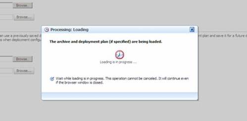

  4. Wait for the progressing dialog to finish.
    Surrounding text describes image064.jpg.

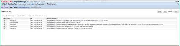

  5. After modal dialogue is completed, you will see a screen for selecting targets. By default WLS_CustomApp will be selected, if not then select and click Next.
    Surrounding text describes image065.jpg.

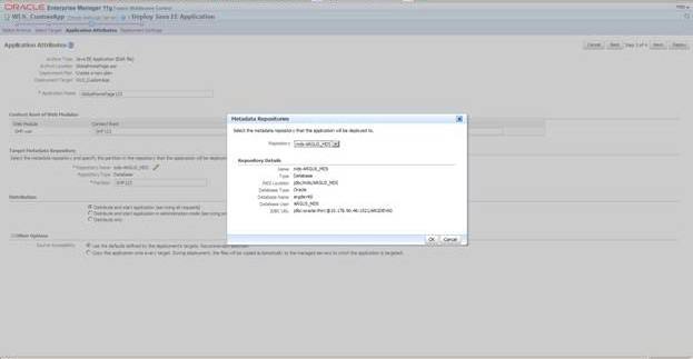

  7. A modal dialog appears that allows you to specify the metadata repository for this application. Choose a metadata repository and click OK.
    Surrounding text describes image067.jpg.

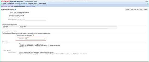

  8. Specify the partition value. You may choose any value but Oracle recommends using the application name itself as the partition value. Click Next.
    Surrounding text describes image068.jpg.

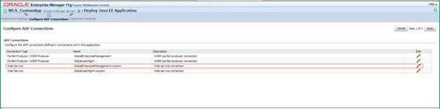

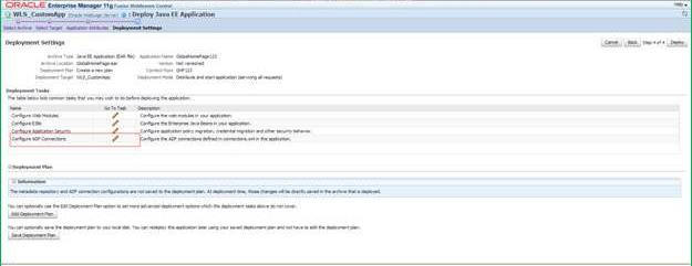

  9. In the Configure ADF connections section, click pencil icon, you will be redirected to the Configure ADF connections screen.
    Surrounding text describes image069.jpg.

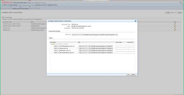

  10. In the Configure ADF connections screen, modify the web service connection. Click the pencil icon to edit the ADF connection settings.
    Surrounding text describes image070.jpg.
  11. A modal dialog comes where you can change ADF connections. You must modify the URL of the following fields to reflect the settings of your deployed portlets.
    • WSDL URL
    • WSRP_v2_PortletManagement_Service
    • WSRP_v2_Markup_Service
    • WSRP_v2_Registration_Service
    • WSRP_v2_ServiceDescription_Service
    Surrounding text describes image071.jpg.

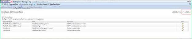

  12. Click OK to close the modal dialogue and you will return to the parent screen. Click Apply in the top right corner. You will return to the deployment wizard screen 4 of 4. Click Deploy. The server will now deploy the ear file and report the success/failure status of the operation.
    Surrounding text describes image074.jpg.

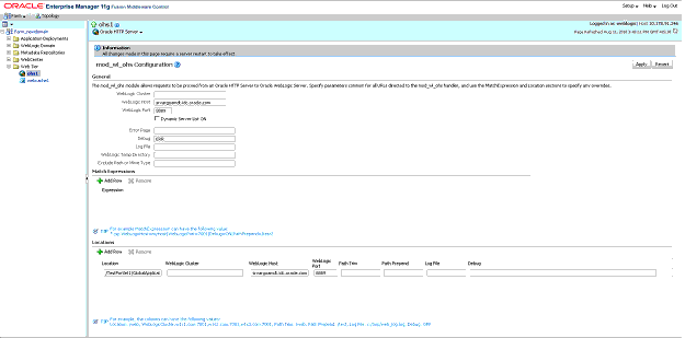

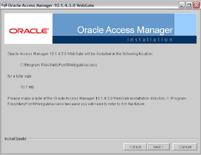

Configuring SSO in Oracle Access Manager 10g
This section describes how to configure SSO in the Oracle Access Manager (OAM) 10g. Following are the pre-requisites to this task:
Perform the following steps to install SSO on the OAM:

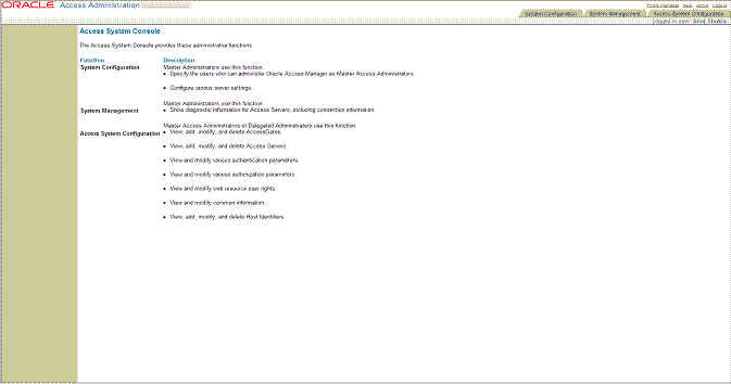

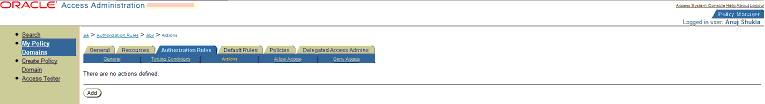

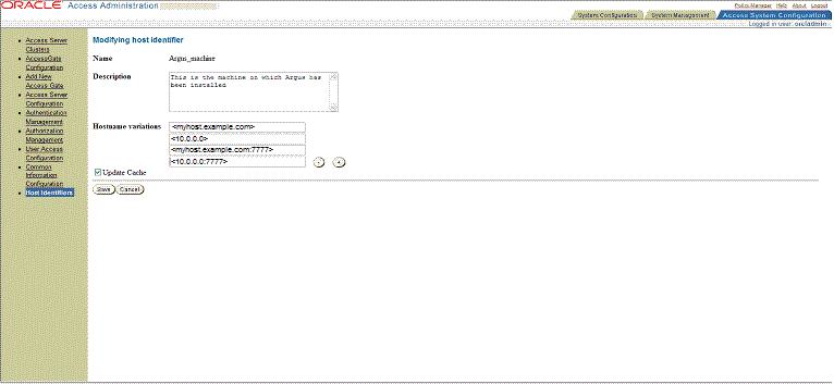

  1. Navigate to the Access System console of OAM and click the Access System Configuration tab. Click Host Identifiers on the left panel. Provide the Fully Qualified Domain Name (FQDN), IP Address and both entries along with port numbers of the Argus Web Server machine. Click Save. For example:
    • <myhost.example.com>
    • <myhost.example.com:7777>
    • <10.0.0.0>
    • <10.0.0.0:7777>
    Surrounding text describes sec13_5fig1.GIF.

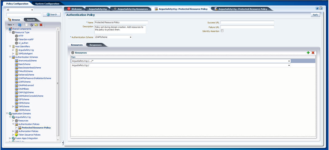

  2. In the Access System console of OAM, click Access System Configuration.
    Surrounding text describes sec13_5fig2.GIF.

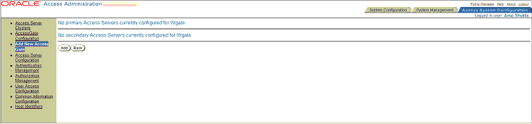

  3. Click Add New Access Gate link on left panel.
    Surrounding text describes sec13_5fig3.GIF.

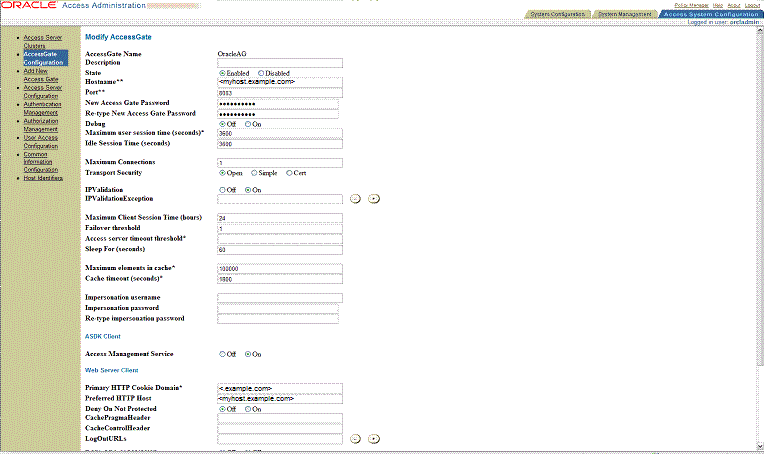

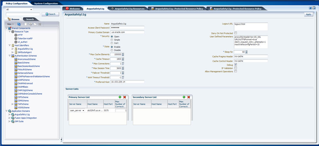

  4. Provide details like access gate name, port, and password. Also, enter the following details:
    • Hostname - provide the FQDN of the Argus Web Server where you will install webgate.
    • Access Management Service - select On. To enable a smooth installation, it is essential that this option is selected as On.
    • Primary HTTP Cookie Domain - provide FQDN of the machine where you will install webgate, prefixed by a period. For example, .idc.<example.com>. Note the . before the FQDN.
    • Preferred HTTP Host - provide the same value as Hostname.
    • CachePragmaHeader - enter value as private
    • CacheControlHeader - enter value as private
    Once you have entered all the above details, click Save to add the webgate.
    Surrounding text describes sec13_5fig4.GIF.
  5. You will see the message Please associate an Access Server or Access Server Cluster with this AccessGate.
  6. Click List Access Servers. The following screen appears:
    Surrounding text describes sec13_5fig5.GIF.
  7. Click Add. Select an access server from the drop-down and click add to associate webgate with access server.
    The access servers in this list will appear based on the access servers installed in the OAM image or installation that you have. Do not attempt adding Access Servers from OAM Console.
    Surrounding text describes sec13_5fig6.GIF.

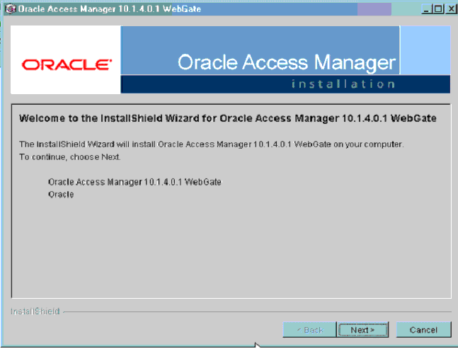

  1. Run the file Oracle_Access_Manager10_1_4_3_0_Win32_ISAPI_WebGate.exe. The following screen appears. Click Next.
    Surrounding text describes sec13_5_1fig1.GIF.

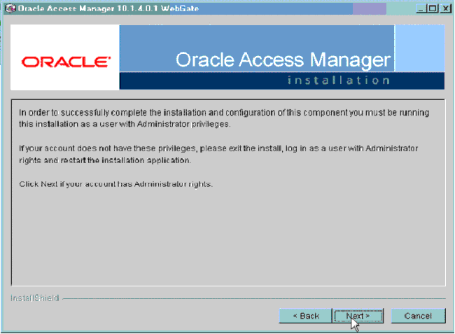

  2. You must have administrative privileges to run the installation. If you are logged in as a different user, you must exit the installation, log in as the Administrator and then restart the installation. When the following screen appears, click Next.
    Surrounding text describes sec13_5_1fig2.GIF.

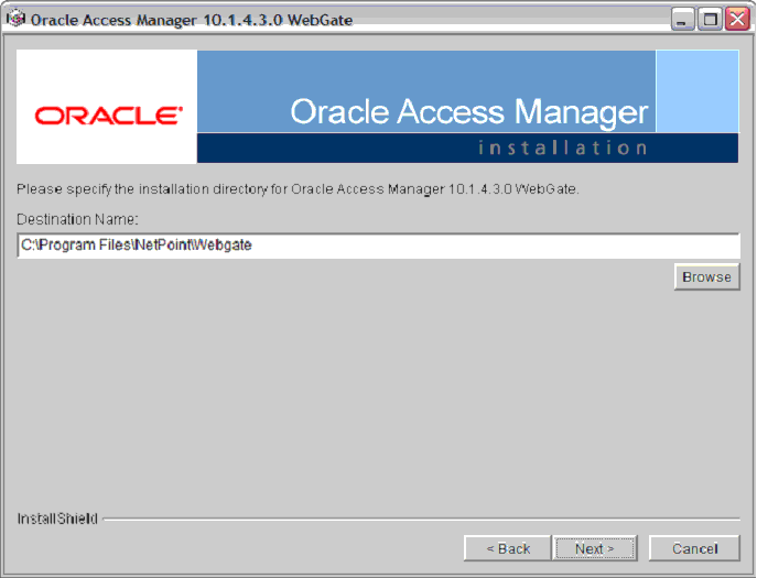

  3. In the Destination Name, set the installation directory and click Next.
    Surrounding text describes sec13_5_1fig3.GIF.
  4. Review the location to which WebGate for IIS is getting installed and the total disk space it will take for the installation. Then click Next.
    Surrounding text describes sec13_5_1fig4.GIF.

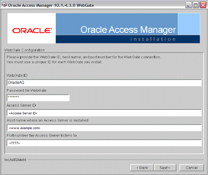

  6. Provide the following details and click Next.
    Table 15-1 Values for WebGate configuration
    Parameter Description
    WebGate ID
    Name of the webgate.
    Password
    Password for the webgate.
    Access Server ID
    Name of the access server that is configured in access server console.
    Host name
    FQDN of the machine where the access server is installed.
    Port number
    Port of the access server
    Surrounding text describes sec13_5_1fig6.GIF.

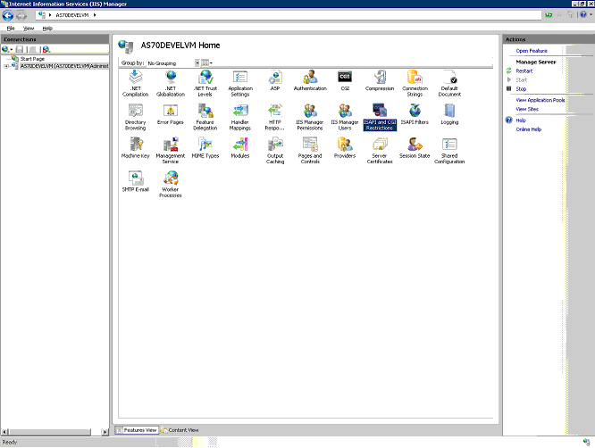

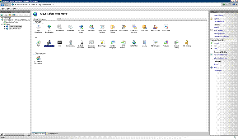

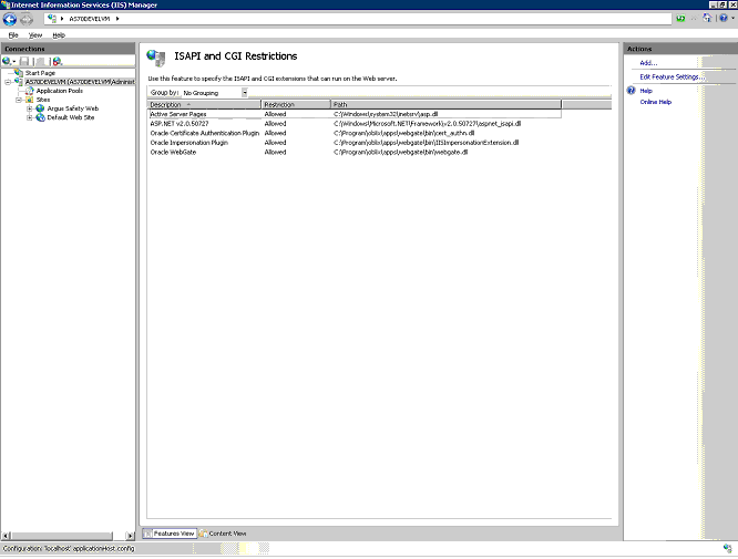

Configuring WebGate on Windows Server 2008 and Windows Server 2012
This section describes the procedure to install WebGate on Windows Server 2008 and Windows Server 2012. Before following this procedure, ensure that you have already installed webgate on Windows 2008 and Windows 2012 servers.
  1. Open IIS manager and navigate to the top level node. On the home page, double click ISAPI and CGI restrictions to open the feature.
    Surrounding text describes sec13_5_2fig1.GIF.
  2. The following screen appears:
    Surrounding text describes sec13_5_2fig2.GIF.

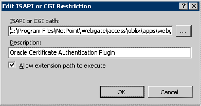

  3. You have to correct the path for the following DLLs to reflect the path where you have installed the WebGate. To do this, double click the DLL entry and you will see the Edit ISAPI or GCI Restrictions dialog box as shown below. In this dialog box, enter the path given in the following table and click OK.
    Table 15-2 Default path for DLL
    DLL Name Default Installation Path
    Oracle Certificate Authentication Plugin
    C:\Program Files\NetPoint\Webgate\access\oblix\apps\webgate\bin\cert_authn.dll
    Oracle Impersonation Plugin
    C:\Program Files\NetPoint\Webgate\access\oblix\apps\webgate\bin\IISImpersonationExtension.dll
    Oracle WebGate
    C:\Program Files\NetPoint\Webgate\access\oblix\apps\webgate\bin\webgate.dll
    For Windows 2008 R2 and Windows 2012 R2, the DLLs must be manually added by clicking on the Add link in the right-most pane.
    Surrounding text describes sec13_5_2fig3.GIF.

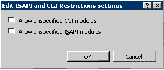

  4. Click Edit Feature Settings in the Actions panel in the right. The following dialog box appears:
    Surrounding text describes sec13_5_2fig4.GIF.
  5. Check both the boxes and click OK.
  6. Click Argus Safety Web node, which will open the home page for the application as shown below.
    Surrounding text describes sec13_5_2fig5.GIF.

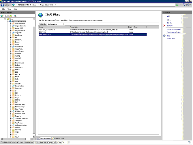

  7. Click ISAPI Filters and the following screen appears:
    Surrounding text describes sec13_5_2fig6.GIF.
  8. Double click OracleWebGate and enter the path to where you have installed WebGate. The default path is C:\Program Files\NetPoint\Webgate\access\oblix\apps\webgate\bin\webgate.dll
  9. You will now have to remove the <add segment="bin"/> entry from applicationhost.config file. Take a backup of the file before you make the following changes:

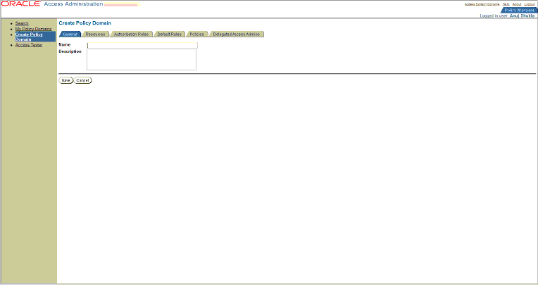

  1. Navigate to the policy manager console and click Create Policy Domain.
    Surrounding text describes sec13_5_3fig1.GIF.
  2. Under the General tab provide a name and description and click Save.
    Surrounding text describes sec13_5_3fig2.GIF.

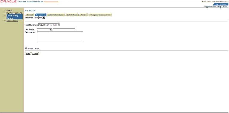

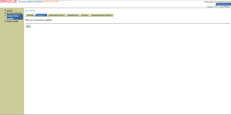

  3. Click the Resource tab and then click Add.
    Surrounding text describes sec13_5_3fig3.GIF.
  4. Select Host Identifier from the drop-down list and select URL Prefix as / and provide a description. Click Save.
    Surrounding text describes sec13_5_3fig4.GIF.

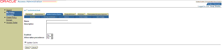

  5. Click the Authorization Rules tab and select the General sub tab.
    Surrounding text describes sec13_5_3fig5.GIF.
  6. Enter the following details in this tab and click Save:
    • Name - Enter an appropriate name for the rule.
    • Description - Enter a description for the rule.
    • Enabled - Select Yes from the drop-down list.
    • Allow takes precedence - Select Yes from the drop-down list.
    Surrounding text describes sec13_5_3fig6.GIF.

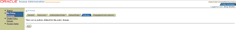

  13. Click Policies and then click Add.
    Surrounding text describes sec13_5_3fig11.GIF.
  14. Provide the following details and click Save:
    • Name - Name of the policy.
    • Description - Description of the policy.
    • Resource type - Select as http.
    • Resource Operation(s) - Select as Get and Post.
  15. Now restart the Identity service and Access service. Also restart the IIS Argus Web Server. This completes the webgate installation and SSO policy configuration.
After you have completed the above steps your policy will appear as shown below:

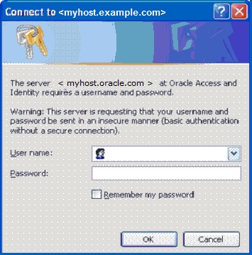

To verify if you have correctly configured the policy check for the following prompt when you open the Argus URL:
Surrounding text describes sec13_5_3fig13.jpg.

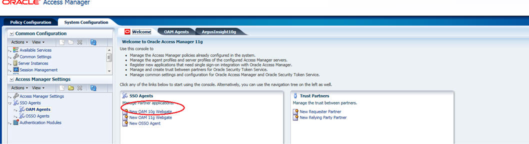

  1. Navigate to the System Configuration tab of OAM and select the New OAM 10g Webgate link.
    Surrounding text describes oam11g1.jpg.

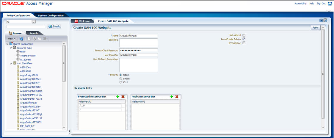

  2. The Create OAM 10g Webgate screen is displayed. Enter the name of the Webgate in the Name field and provide the password for the Webgate in the Access Client Password field. Click Apply.
    Surrounding text describes oam11g2.jpg.
  3. The following screen is displayed:
    Surrounding text describes oam11g3.jpg.
    Refresh the Host Identifier list to view the newly created Webgate within the Policy Configuration tab.
    Provide details such as Primary Cookie Domain and Preferred Host, as shown above and click Apply:
    • Primary Cookie Domain - provide FQDN of the machine where you will install webgate, prefixed by a period. For example, .idc.<example.com>. Note the . before the FQDN.
    • Preferred Host - provide the IP Address of the Argus Web Server where you will install webgate.

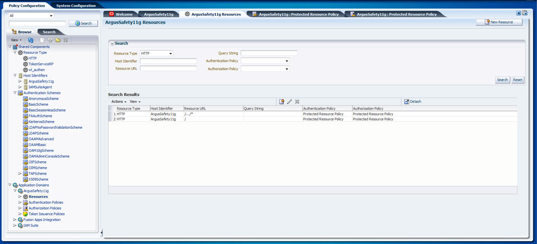

  4. Expand the list of Application Domains and under this, expand the newly created Webgate.
    Double-click on Resources. On the Resources screen, click the Create icon (displayed in the Search Results section, with the + symbol in red).
    Create the resource type with the correct host identifier, as displayed in the following screen:
    Surrounding text describes oam11g4.jpg.

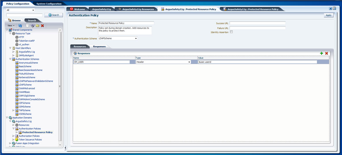

  5. Expand the Authentication Policies under the newly created Webgate.
    Double-click the Protected Resource Policy. The following screen appears:
    Surrounding text describes oam11g5.jpg.
  6. Navigate to the Responses tab and click the + button to add the Name, Type, and Value for the responses, as shown in the following screen:
    Surrounding text describes oam11g6.jpg.

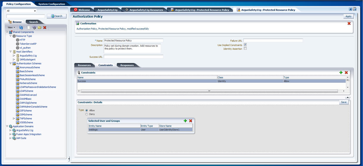

  7. Expand the Authorization Policies under the newly created Webgate and double-click the Protected Resource Policy.
    Select the Constraints tab and click the + button to add the Name, Type, and Class for the constraints, as shown in the following screen:
    Surrounding text describes oam11g7.jpg.
    All the names under the Constraints tab with Type as Allow can access the Argus Safety Server where Webgate has been installed. Select the Type as Deny if a user should be denied access to the Argus Safety Server where Webgate has been installed.
    If no constraint is added, all the users configured on the LDAP Server will have access to the Argus Safety Server where Webgate has been installed.

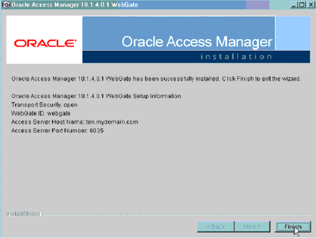

Installing WebGate
Following is the procedure to install WebGate:

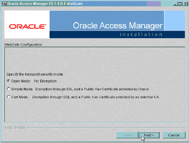

  5. The installer begins copying the WebGate files for IIS. Now select Open Mode: No encryption for the transport security mode and click Next.
    Surrounding text describes sec13_5_1fig5.GIF.
    Table 15-4 Values for WebGate configuration
    WebGate ID
    Password
    Access Server ID
    Host name
    Port number
  7. The following screen appears:
    Surrounding text describes sec13_5_1fig7.GIF.

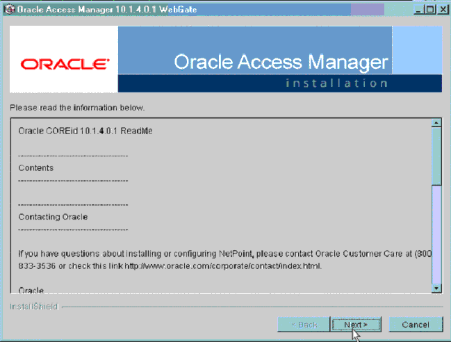

  8. Review the Readme page and click Next.
    Surrounding text describes sec13_5_1fig8.GIF.
  9. You can review the WebGate for IIS configuration settings and click Finish.
    Surrounding text describes sec13_5_1fig9.GIF.
    Table 15-5 Default path for DLL
    Oracle WebGate

  9. Navigate to Default Rules > Authentication Rule. Click Add.
    Surrounding text describes sec13_5_3fig9.GIF.
  10. Enter details for Name and decsription and select Authentication Scheme as Oracle Access and Identity Basic Over LDAP. Click Save.
  11. Click the Authorization Expression sub tab and click Add.
    Surrounding text describes sec13_5_3fig10.GIF.
  12. Select Authorization Rule from the drop-down. Click Add and then click Save.
Surrounding text describes sec13_5_3fig12.GIF.

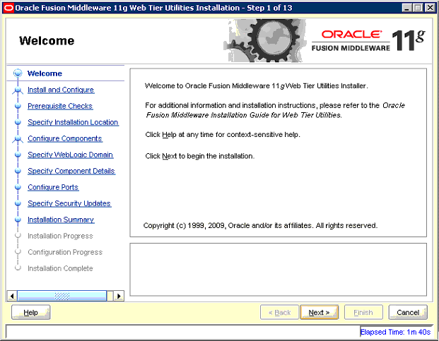

  1. Navigate to folder \ofm_webtier_win_11.1.1.2.0_32_disk1_1of1\Disk1 and double click setup.exe to start the installer. The installer will begin after a check has been made for installer requirements.
  2. Click Next to continue.
    Surrounding text describes sec12_6_1fig2.GIF.

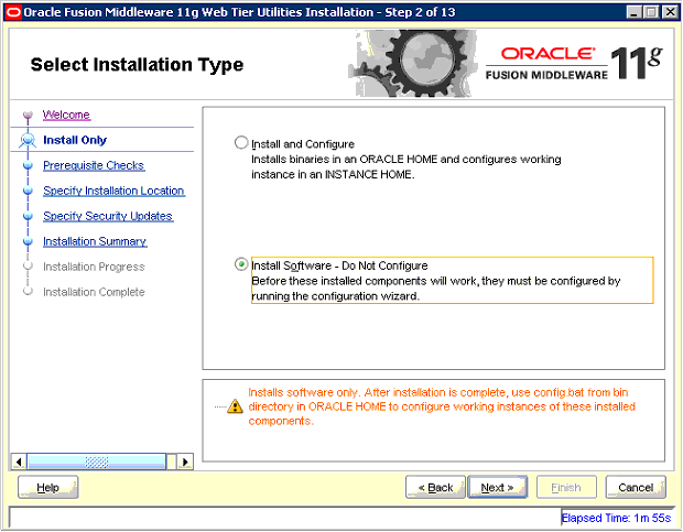

  3. Select Install Software - Do Not Configure and click Next.
    Surrounding text describes sec12_6_1fig3.GIF.

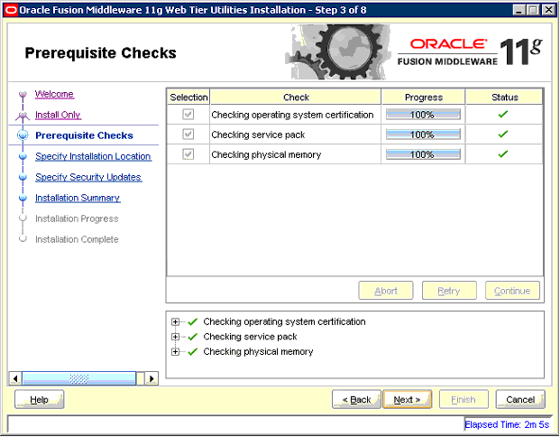

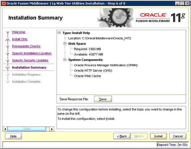

  4. In the next screen, the installer performs Prerequisite Checks. Click Next to continue.
    Surrounding text describes sec12_6_1fig4.GIF.

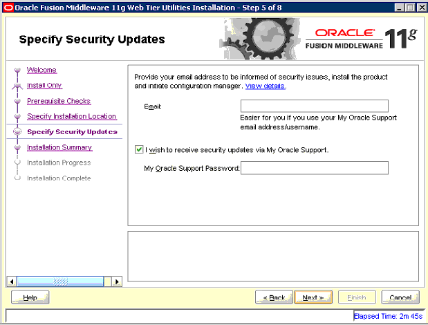

  5. You can skip security updates so uncheck the option to receive security updates via My Oracle Support. The system will give a warning. Click Yes to close the screen and then click Next.
    Surrounding text describes sec12_6_1fig5.GIF.
  6. On the installation summary screen, click Install. This will install Oracle Web Tier.

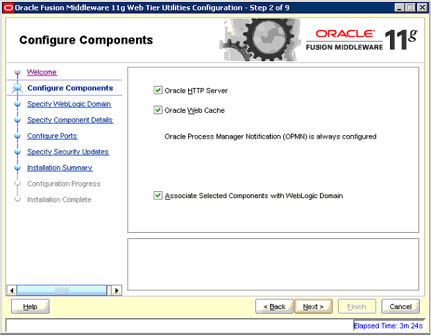

  1. Navigate to the folder Oracle Middleware_Home\Webtier_Instance\bin. For example, C:\OracleNew\Middleware\Oracle_WT1\bin. Here Oracle_WT1 is the name of the webtier instance created during installation. In the folder, run config.bat to start the configuration wizard.
    Surrounding text describes sec12_6_2fig1.GIF.
  2. In the next screen, click Next.
    Surrounding text describes sec12_6_2fig2.GIF.

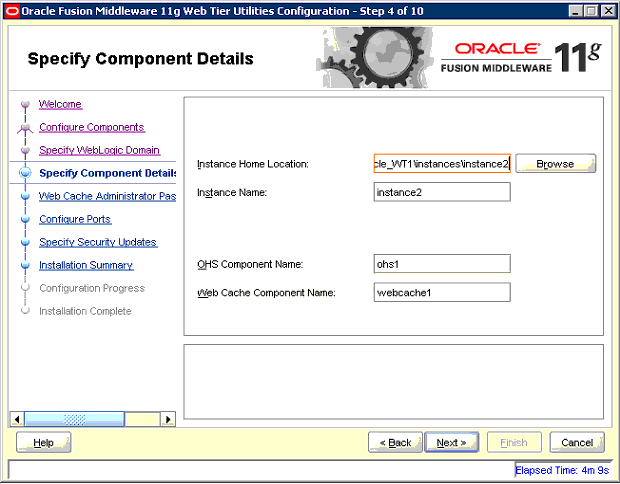

  3. Enter details of the weblogic server and click Next.
    Surrounding text describes sec12_6_2fig3.GIF.

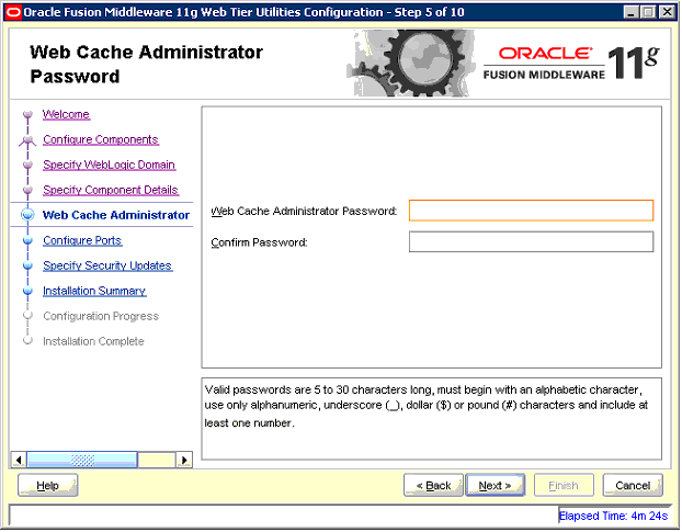

  5. Enter a password for Web Cache and click Next.
    Surrounding text describes sec12_6_2fig5.GIF.

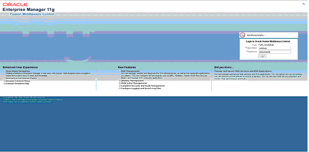

  8. After the configuration, navigate to http://localhost:7001/em. This will open the Enterprise Management console for Fusion Middleware as shown below. Log in using the same credentials as that of the WebLogic server.
    Surrounding text describes sec12_6_2fig8.GIF.

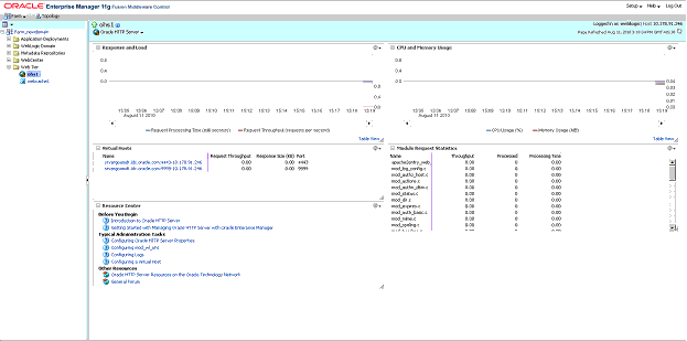

  9. Click the Web Tier node on the left.
    Surrounding text describes sec12_6_2fig9.GIF.
  10. Click the name of the OHS instance that you have created during installation. In the following example, the OHS instance is ohs1.
    Surrounding text describes sec12_6_2fig10.GIF.
  11. You will see all the details related to Oracle Http server on this console.
    Surrounding text describes sec12_6_2fig11.GIF.

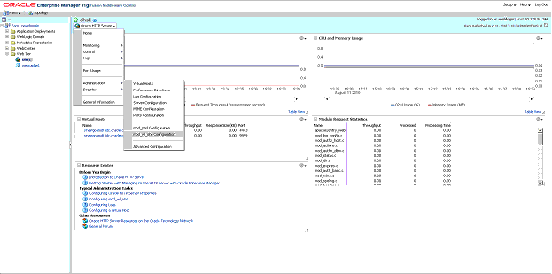

  1. Perform steps 8 to 11 from the section Configuring Oracle Web Tier.
  2. Click Oracle Http Server just below instance name at the top of right pane to access a menu.
    Surrounding text describes sec12_6_3fig1.GIF.
    This menu allows you to perform the following administrative tasks:
    • Control > Start Up - You can start an OHS instance using this option.
    • Control > Shut Down - You can stop and OHS instance using this option.
    • Control > Restart - You can restart an OHS instance using this option.
    • Logs > View Log Messages - You can view logs of the OHS instance using this option.
Configuring Oracle Http Server as Reverse Proxy Server for WebLogic
This section describes the procedure to configure the Oracle Http Server to act as a reverse proxy server for the WebLogic Server. Prior to following this procedure, ensure that you have a running instance of WebLogic Server and Oracle Web Tier. Also, you should have Global Home Page URL.

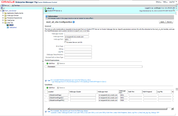

  2. Navigate to Administration > mod_wl_ohs_configuration from the top menu.
    Surrounding text describes sec12_6_4fig1.GIF.
  3. The following screen appears:
    Surrounding text describes sec12_6_4fig2.GIF.
    In the General section enter the following information:
    • Weblogic host: FQDN of the machine where weblogic server and other managed servers are running.
    • Weblogic port: Port of the WebLogic server.
    • Debug: Give ERR.
    • Log File: You can provide a log file here.
    In the Locations Section:
    • Click AddRow and add a new row.
    • In the WebLogic Host and Port field enter the same values as that in the general section of this page.
    • Location field: For entering a value in this field consider an example. If the URL for the Global Home Page deployed on custom server is http://<myhost.idc.example.com:7777>/GlobalHomePage/faces/GlobalHome, then <myhost.idc.example.com> is the FQDN of the machine where WebLogic server is installed and 8001 is the port at which custom server is listening. Now take the path after port /GlobalHomePage/faces/GlobalHome and enter this as the value in the location field.
    • Click Apply on the top right corner.
  4. Restart the Oracle http Server using the Restart option of the top level menu.
  5. After restarting, navigate to http://<myhost.idc.example.com:7777>/ GlobalHomePage/faces/GlobalHome. Here <myhost.idc.example.com> is the FQDN of the machine where the OHS instance is running and <7777> is the port at which the OHS server is listening.
    You should see the same page but this time it is being redirected from OHS to the WebLogic Server.
    Surrounding text describes sec12_6_4fig3.GIF.

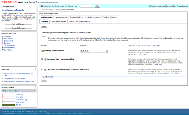

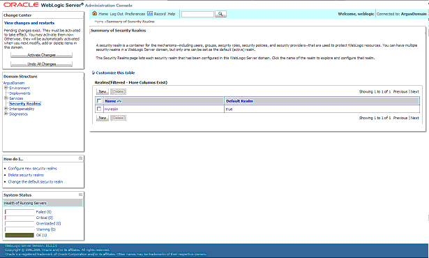

  1. Log in to the WLS Administration Console. From the Domain Structure pane, click Security Realms. Then click myrealm.
    Surrounding text describes sec12_7_1fig1.GIF.

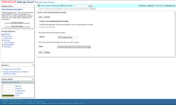

  2. Navigate to Providers > Authentication. Click New to create a new provider.
    Surrounding text describes sec12_7_1fig2.GIF.
  3. Enter Name as OID Authenticator and select type from the drop-down as OracleInternetDirectoryAuthenticator. Click OK.
    Surrounding text describes sec12_7_1fig3.GIF.

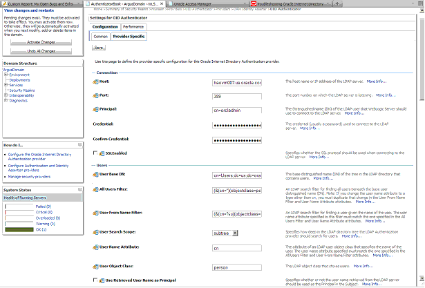

  4. Go back to the Providers tab and click OID Authenticator, which appears as link.
  5. In the Common sub tab modify the Control Flag field to Sufficient and click Save.
  6. Click the Providers Specific tab and provide values for the fields described in the table below:
    Table 15-7 Values for the Providers Specific tab
    Parameter Name Description Sample Value
    Host
    LDAP Hostname
    i<myhost.vm.example.com>
    Port
    LDAP Port
    389
    Principal
    LDAP admin principal
    cn=orcladmin
    Credential
    Password for admin principal (password of cn=orcladmin)
    User Base DN
    User Search Base - This value can be obtained by checking the Users realm DN from OID
    For example, cn=Users,dc=idc,dc=oracle,dc=com
    All Users Filter
    Set as (&(uid=*)(objectclass=person))
    User Name Attribute
    Set to "uid" from "cn"
    uid
    Group Base DN - Group search base - Same as User Base DN
    Group Search Base - The DN used to search the Group, can be checked by Groups DN in OID
    For example, cn=Groups,dc=idc,dc=oracle,dc=com
    Retain the default values for the remaining attributes. Click Save.
    Surrounding text describes sec12_7_1fig6.GIF.

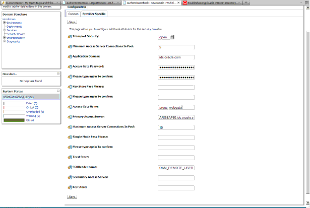

  4. Click OK to save the details. Now click the newly added OAMIdentityAsserter, which appears as link to view its details.
  5. In the Common sub tab select control flag as REQUIRED and click Save.
  6. Navigate to the Providers sub tab and provide the details in the table below:
    Table 15-8 Values for Provider sub tab
    Transport Security
    Encryption type for Access Gate communication
    Open
    Primary Access Server
    Provide OAM server endpoint information in HOST:PORT format
    Access Gate Name
    Copy the Access Gate name from the AG created from Step 3.
    <myhost.example.com>_AG
    Access Gate Password
    Type the Access Gate Password configured in access system console
    Surrounding text describes sec12_7_2fig6.GIF.
