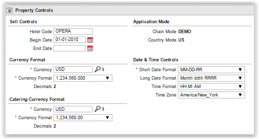

Edit Properties - also enables the I Want To...Change Chain Mode link
Property Controls settings originate when the property is first configured. These settings can be edited afterward, depending on your role/task permissions.
Note that the Chain Mode and Country Mode values within the Application Mode section are read-only.
To edit the Property Controls, select Edit, make your adjustments, and then select Save.

View the Country Mode that my property is in?
Within the Application Mode section of the Property Controls jump, the Country Mode field is read-only.
To view the Country Mode setting,
1. In the Property Configuration screen, select the Property Controls jump.
2. In the Application Mode section, find the Country Mode field.
View the Chain Mode that my property is in?
Within the Application Mode section of the Property Controls jump, the Chain Mode field is read-only.
To view the Chain Mode setting,
2. In the Application Mode section, find the Chain Mode field.

Can I change my property's currency format?
You can only change the Currency format prior to running End of Day for the property. The Catering Currency format remains editable after running End of Day.
To change your property's currency format,
- Navigate to the Chain and Property Management screen > Properties.
- Select the Property from the list, and then select Edit.
- In the Property Configuration screen, select Property Controls.
- Select Edit.
- You can change both the Currency and the Currency's format by choosing from the single-select or drop-down list of values.
- Select Save.
