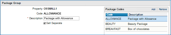

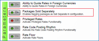

Packages Sold Separately [PACKAGES_SOLD_SEPARATELY] Enables flagging packages as Sell Separate in configuration
The Packages Sold Separately parameter in Rate Management controls the Sell Separate check box displayed in Rate Packages, Package Codes, and Package Groups.
Packages Sold Separately controls the Sell Separate check box.
Parameter Group:
Level:
Rate Management
Property
How it works:
If Packages Sold Separately is ON, selecting the Sell Separate check box allows you to sell packages separately from a package rate and attach them directly to a reservation. For example, if a rate code includes a breakfast package, selecting Sell Separate allows you to sell the breakfast package apart from the rate code.
Selecting Packages Sold Separately displays the following pop-up for toggling the parameter ON of OFF.
Select Packages Sold Separately to turn the parameter ON or OFF.
Affected Screens
With the Packages Sold Separately parameter ON, the following screens display the Sell Separate check box:
Administration > Financial > Rates and Packages > Rate codes > Package Codes > Posting Attributes
Administration > Financial > Rates and Packages > Package Groups
Administration > Financial > Rates and Packages > Rate Codes
Note: The sell separate checkbox on the rate code screen is view only and is based on the package code or package group configuration.

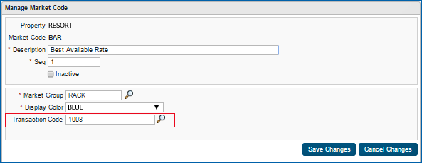

Revenue Posting by Market Code Choose if revenue should be posted based on Rate Code Configuration or Market Code Mappings
Setting the parameter "Revenue Posting by Market Code" to ON displays a Transaction Code field on the Manage Market Code screen. This field allows you to assign a Transaction Code to a Market Code. By doing so, the Market Code attached to the Rate Code determines which transaction code is used when the rate code is posted.
The "Revenue Posting by Market Code" parameter adds a Transaction Code field on the Manage Market Code screen.
Parameter / Function Options
- If the "Revenue Posting by Market Code" parameter is ON and the transaction code is mapped, room revenue is posted based on Market Code Mappings.
- If the "Revenue Posting by Market Code" parameter is OFF (or ON, but a transaction code is not mapped) and the "Revenue Posting by Room Type/Room Class" function is ACTIVE, then room revenue is posted based on Room Type/Room Class mapping.
- If the "Revenue Posting by Market Code" parameter is OFF (or ON, but a transaction code is not mapped) and the "Revenue Posting by Room Type/Room Class" function is INACTIVE, then room revenue is posted based on the rate code transaction code.
