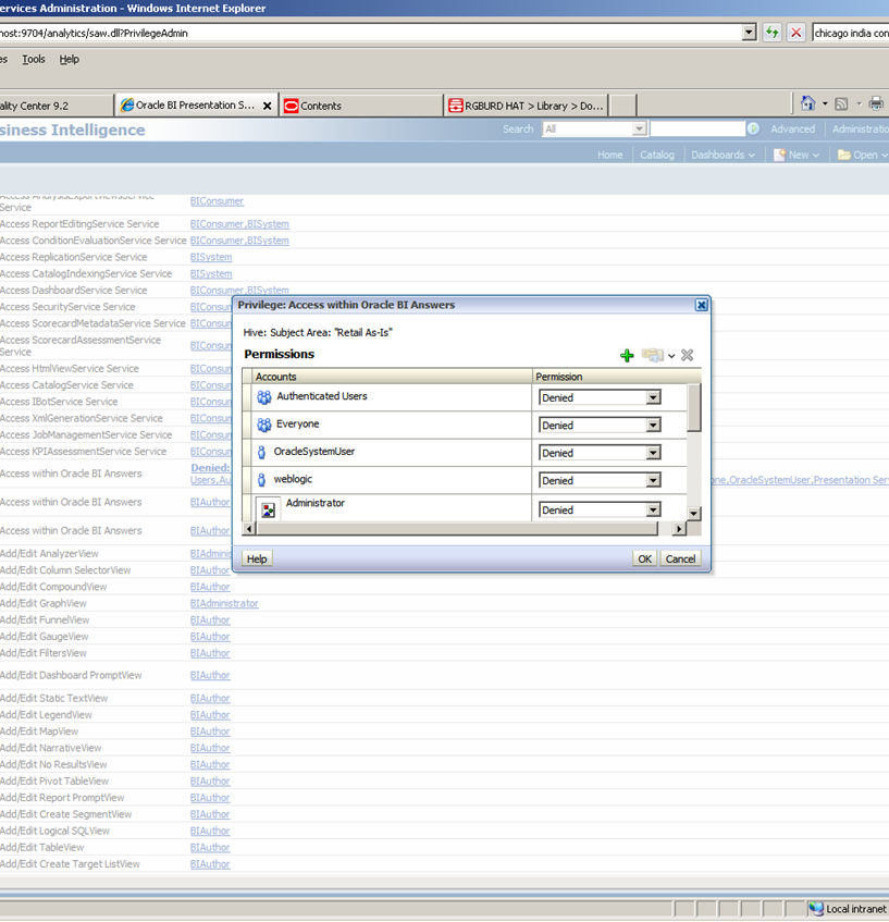

In the "Fact - Retail Inventory Receipts" logical table, disable the following sources:
Fact_W_RTL_INVRC_SC_DY_CUR_AFact_W_RTL_INVRC_SC_LC_WK_CUR_AFact_W_RTL_INVRC_SC_WK_CUR_A
With this change, these tables can never be accessed and As-Is reporting cannot be done for inventory receipts. The same changes must be done for all the other fact areas as well. Since Retail Insights has three subject areas (Retail As-Was, Retail As-Is and Retail Point in Time), all three are available to the user. Since As-Is components should be disabled, go to the Administration -> Manage Privileges on Oracle BI EE web and, for all the users/roles, change the permission setting to "Denied" for the As-Is subject area. This way, the As-Is subject area will not be available for reporting. The following figure displays the Administration screen.
Figure 2-1 Administration Screen
Surrounding text describes Figure 2-1 .
