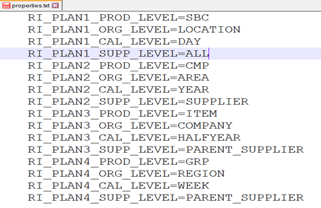

In File Mode, the user has to first set Planning levels in the properties.txt file in the RETAIL_HOME/OBIEE_DEP path then run PlanningConfigurationScript.sh script with MODE argument f.
Note: While running in filemode, planning levels to be set in properties.txt should match the C_ODI_PARAM table planning level entries. |
The following values are valid for the properties.txt file:
