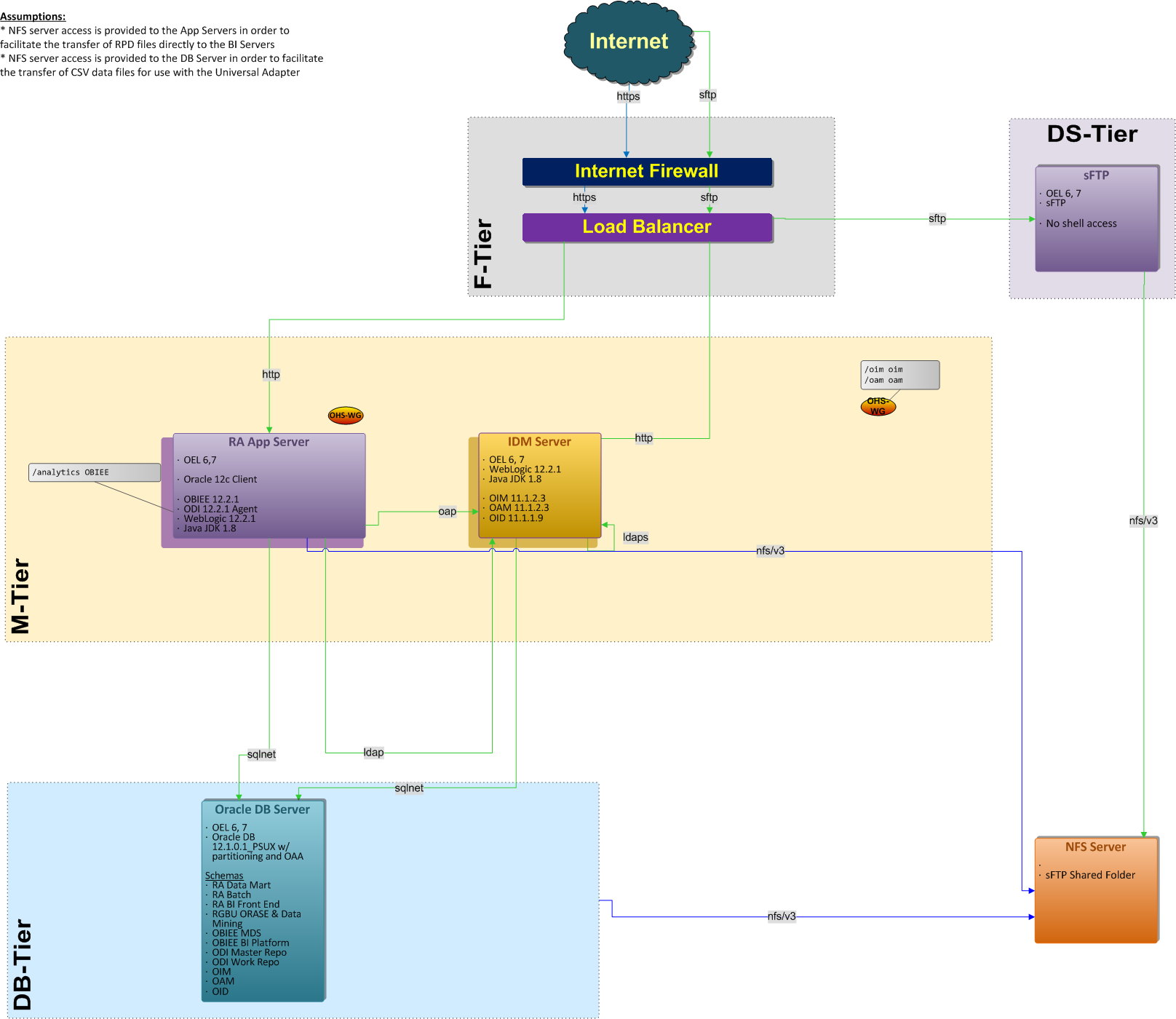

The following diagram provides a high-level overview of the physical deployment of Retail Insights.
The PC user interface for the Oracle Retail Insights application is web-based, normally accessed through Internet Explorer directly.
The minimal configuration of the Oracle Retail Insights application runs on three types of servers: one for the reporting user interface via Oracle Business Intelligence Enterprise Edition (BI EE), one for the batch execution via Oracle Data Integrator (ODI), and one for the Oracle database. The batch execution and ODI metadata can be on the same server with Oracle database. Using same Oracle database server for ODI metadata and RA data mart can improve batch performance due to less network traffic. The storage of executables, scripts, configurations and data for each can reside on a central mirrored disk array cabinet unit or can be segregated by server type, with the file system configured as a shared mount point for relevant servers. All the servers and disk storage units are inter-connected by one or more high speed optical fiber channels where appropriate to insure quickest data communication relative to time critical processes occurring on each server. For connectivity to Retail Insights data source systems and Retail Insights hosted in the corporate data center, a LAN is sufficient. And for systems external to the data center, a WAN is usually sufficient. The connectivity needed between Retail Insights and core Merchandising Operations Management (MOM) applications, is performed via a LAN connection.
The data aggregation logic is found on the batch server while the reporting logic for the application is customized by users and stored on the application server.
The U.I. server setup involves Oracle BI EE, which support horizontal scaling to provide some higher availability, load balancing and fail-over. To fully enable clustering requires a Web Load Balancer servicing HTTP requests from PC clients, and the cohabitation of Oracle BI EE on the multiple servers.
The database server hosts the Oracle database instance for the application. The database server can optionally be RAC enabled, using Oracle Clusterware, to provide high availability and fail-over, without which a fail-over backup server (potentially idle) would be required.
The Retail Insights application has numerous ODI batch jobs. The scheduling can be performed by the same scheduler installed for the core MOM applications. The processing architectures of most batch jobs do not naturally lend themselves to horizontal scaling across multiple servers. However in the event of a batch server hardware failure, a backup server connected to the same file system may be needed to facilitate quicker restart of aborted jobs. Alternatively, batch jobs could be executed on the database server and/or ODI batch server if ODI is installed on the different server with Retail Insights database server, but with a RAC setup the load balancing of multiple jobs, across multiple servers is not straightforward. In addition, jobs run on RAC database servers, will cause uneven contention for resources with the Oracle database instances that would partially defeat the load balancing efforts of RAC for Oracle database instances.
All of the batch jobs except data mining related batch jobs should run daily during a nightly batch window with no user access availability for the application. Data mining batch jobs should run weekly. The batch window for data mining process could be longer than one day; however user can still access mining reports for history mining data during mining batch window.

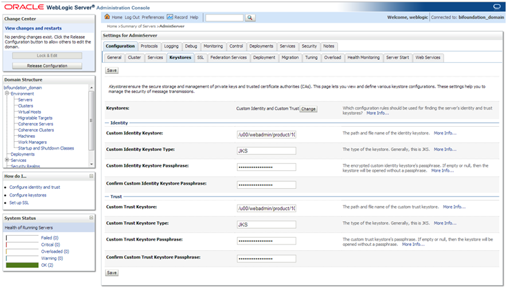

Configure the identity and trust keystores for WebLogic Server in the WebLogic Server Administration Console.
In the Change Center of the Administration Console, click Lock & Edit.
In the left pane of the Console, expand Environment and select Servers.
Click the name of the server for which you want to configure the identity and trust keystores. For Forms server, it would be typically WLS_FORMS.
Select Configuration > Keystores.
In the Keystores field, select Custom Identity and Custom Trust.
In the Identity section, define attributes for the identity keystore.
Custom Identity Keystore: The fully qualified path to the identity keystore created above.
Custom Identity Keystore Type: The type of the keystore. Generally, this attribute is Java KeyStore (JKS); if left blank, it defaults to JKS.
Custom Identity Keystore Passphrase: The password you will enter when reading or writing to the keystore. This attribute is optional or required depending on the type of keystore. All keystores require the passphrase in order to write to the keystore. However, some keystores do not require the passphrase to read from the keystore. WebLogic Server only reads from the keystore so whether or not you define this property depends on the requirements of the keystore.
In the Trust section, define properties for the trust keystore.
Custom Trust Keystore: The fully qualified path to the trust keystore.
Custom Trust Keystore Type: The type of the keystore. Generally, this attribute is JKS; if left blank, it defaults to JKS.
Custom Trust Keystore Passphrase: The password you will enter when reading or writing to the keystore. This attribute is optional or required depending on the type of keystore. All keystores require the passphrase in order to write to the keystore. However, some keystores do not require the passphrase to read from the keystore. WebLogic Server only reads from the keystore so whether or not you define this property depends on the requirements of the keystore.
Click Save.
To activate these changes, in the Change Center of the Administration Console, click Activate Changes.

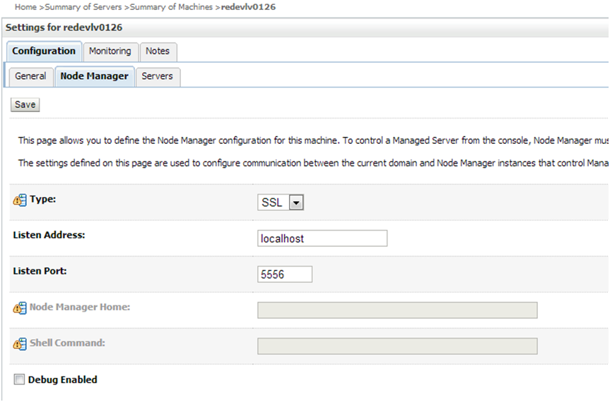

Login to WebLogic console, navigate to Environment > Machines. Select the nodemanager created already and navigate to Node Manager tab. In the Change Center, click Lock and Edit.
For Type, select SSL and save and activate (this may already be set to SSL).
"Listen Address" must be set to the server name used for the certificate request.
After activating the changes, you need to bounce entire Weblogic Domain for changes to take effect. Verify the nodemanager is reachable in Monitoring tab after restart.

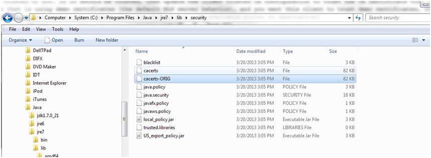

The most probable cause of this issue could be unavailability of root certificates of the CA within the local jre being used. In order to import the root certificates, follow the steps similar to below.
Backup cacert at <JRE_HOME>/lib/security/cacert.
Import the certificate using the keytool utility.
C:\Program Files\Java\jre7\lib\security>..\..\bin\keytool.exe -import -trustcacerts -file D:\ADMINISTRATION\SSL\[SERVERNAME]\Selfsigned\[SERVERNAME].root.cer -alias [SERVERNAME] -keystore "C:\Program Files\Java\jre7\lib\security\cacerts" Enter keystore password: [default is changeit] Owner: CN=[SERVERNAME].us.oracle.com, OU=RGBU, O=Oracle Corporation, L=Minneapolis, ST=Minnesota, C=US Issuer: CN=[SERVERNAME].us.oracle.com, OU=RGBU, O=Oracle Corporation, L=Minneapolis, ST=Minnesota, C=US Serial number: 515d4bfb Valid from: Thu Apr 04 15:16:35 IST 2013 until: Fri Apr 04 15:16:35 IST 2014 Certificate fingerprints: MD5: AB:FA:18:2B:BC:FF:1B:67:E7:69:07:2B:DB:E4:C6:D9 SHA1: 2E:98:D4:4B:E0:E7:B6:73:55:4E:5A:BE:C1:9F:EA:9B:71:18:60:BB SHA256: F3:54:FB:67:80:10:BA:9C:3F:AB:48:0B:27:83:58:BB:3D:22:C5:27:7D: F4:D1:85:C4:4E:87:57:72:2B:6F:27 Signature algorithm name: SHA1withRSA Version: 3 Trust this certificate? [no]: yes Certificate was added to keystore C:\Program Files\Java\jre7\lib\security>

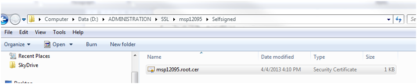

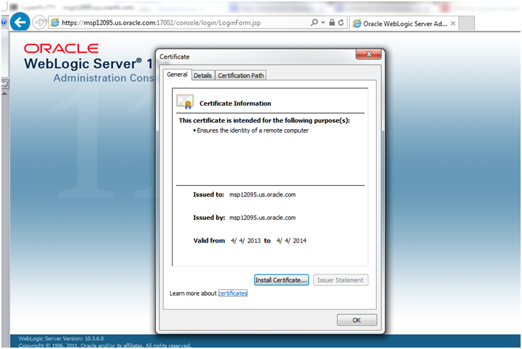

If the Root Certificate that signed WebLogic server certificate is not in that list of trusted CAs, you need to add it in the browser to avoid certificate verification error.
For Internet Explorer, that requires the following steps:
Copy the Root Certificate file to the workstation.
Rename the file to fa_root_cert.cer (this is a quick and easy way to associate the file with the Windows certificate import utility).
Double-click on the file.
Click Install Certificate and click Next.
Select Place all certificates in the following store and click Browse.
Select Trusted Root Certification Authorities and click OK.
Click Next.
Click Finish and then Yes at the Security Warning prompt.
Click OK to close the remaining open dialog boxes.

Keystores are repository of the certificates. In situations when we are facing issues related to SSL Certificates, once can check the certificates which are available in the keystore. In case the certificates are not missing, they should be imported. keytool command provides the list of the certificates available.
Example:
$ keytool -v -list -keystore /u00/webadmin/product/jdk/jre/lib/security/cacerts $ keytool -v -list -keystore /u00/webadmin/product/10.3.X_APPS/WLS/wlserver_10.3/server/lib/[SERVERNAME].keystore
Retail applications can be deployed across different hosts and even behind network behind firewalls. Ensure that firewalls are configured to allow tcps connections to enable secure communications among integrated application.
Secured applications using signed certificates need to use same secured protocols for communication. Ensure that all the communicating applications use the same protocol. Refer to Enforcing stronger encryption in WebLogic section in Pre-install steps for Secured setup of Retail Infrastructure in WebLogic chapter on steps to specify secured protocol.
Communicating applications using signed certificates may need to verify the incoming connections. Root certificates should be available in the keystores of the applications to verify the requests from different host. It is important to import all the root certificates in the keystores of all communicating applications. Refer to Import the root certificate in local client JRE section in Troubleshooting chapter for steps to import root certificates.
