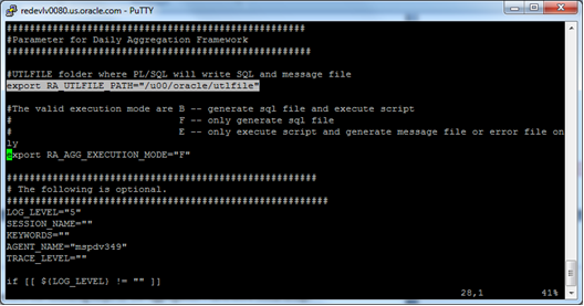

  5. Configure database UTLFILE folder and execution mode in the ra.env file. The UTLFILE folder location will be setup on the application server.
    Figure 6-1 Configuring the UTLFILE Folder
    Surrounding text describes Figure 6-1 .

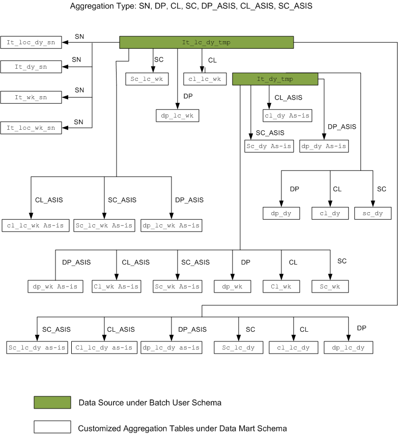

Figure 6-2 SN, DP, CL, SC, DP_ASIS, CL_ASIS, SC_ASIS Framework Data Flow Diagram
Surrounding text describes Figure 6-2 .

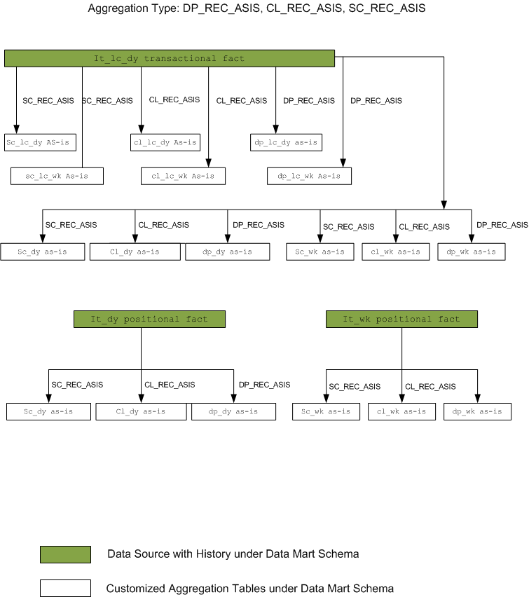

Figure 6-3 DP_REC_ASIS, CL_REC_ASIS, SC_REC_ASIS Framework Data Flow Diagram
Surrounding text describes Figure 6-3 .

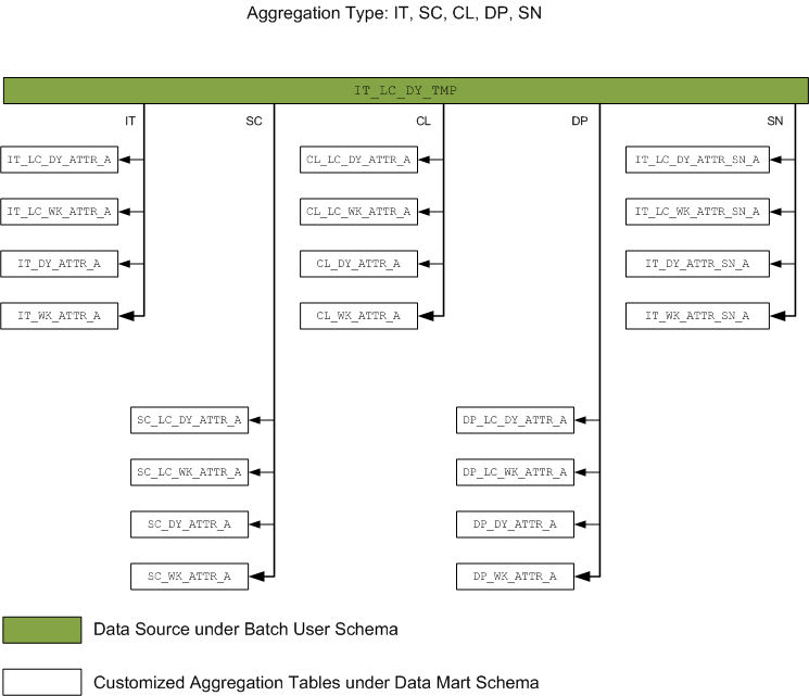

Figure 6-4 IT, SC, CL, DP, SN Attribute Aggregation Framework Data Flow Diagram
Surrounding text describes Figure 6-4 .
