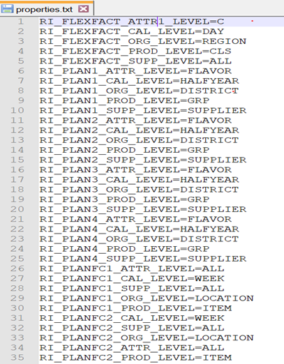

In File Mode user has to first set Planning levels in the file properties.txt in the path where OBIEE_BAR_FILE_DEP.zip is unzipped, then run PlanningConfigurationScript.sh script with MODE argument f.
FLEX_FACT Configuration requires setting of only FLEX_FACT levels in properties.txt and for planning only planning levels should be set. Similarly Planning RDF Forecast Integration requires setting only Planning RDF Forecast Integration levels in properties.txt.
Figure 9-1 Properties.txt File
Properties.txt file
While running in filemode, planning levels to be set in properties.txt should match the C_ODI_PARAM table planning level entries.
The following values are valid for the properties.txt file:
