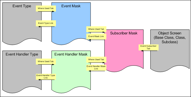

29.2.2 Event Subscription Components are Interconnected
This schematic depicts the connections between individual objects that are created in Event Management nodes.
For example, when you open an event type from the Event Types node, it has a Where Used tab that lists all event masks that use that event type. In the other direction, when you open an event mask from Events node, the field "Event Type" is a live link to the named event type object.
The right-most element "Object Screen" represents any object type—each row in Classes node—and each and every object type has an Event Subscribers tab that lists all event subscribers that are associated to this object type (because a given subscriber names an event mask that names the object type).
For Event-based Notifications, a Notification mask is the Handler. The distinction between Handler mask and Notification mask is simply because they are created in different nodes in Administrator, namely, Events Handlers node and Notifications node.
Figure 29-2 Connections between individual objects in Event Management nodes
Connections between individual objects in nodes

29.5 Working in Events Node
The Events node is where you create and manage Event masks.
29.5.1 Attributes of Event Masks
The table below lists attributes found on the General Information tab in Event masks.
All Event masks must name an Event Type. Most Event masks must name an Object Type (excepting those that name one of the "Global" event types).
System-generated names are a helpful feature when creating Event masks and Subscriber masks. The Name Helper button can be used: it concatenates Event Type and Object Type (if you select them before you manually enter a Name) to generate a Name and API Name.
Additional attributes may appear in the Create dialog as certain event types and object types are selected; these are given general mention in this table. "Additional attributes" are also noted by event type in "More about Selected Event Types."
The Where Used tab lists all Subscriber masks that use the Event mask.
Table 29-8 Attributes of Events Masks
Attribute Description
Event Type
Event type categorizes what user action will trigger the event.

29.5.2 Checklist for Creating an Event Mask
This is a checklist of questions to ask (of, perhaps, a company Change Analyst or Product Analyst) and have answered when you begin to create Event Subscriptions and, more specifically, when you create any Event mask.
  • For my company's installed PLM solutions—and routine tasks performed by Agile users—what are all the PLM Actions that I want to automate the system? Are there any automations needed to supplement actions such as Create, Save As, Update Title Block, Update Table, or by other object behaviors (that are represented by the event types)?
  • From a given event type being triggered, what is the result that we want to automatically happen?
  • What is the proper object type that this Event mask will apply to? You may need to ask: will the Handler or Notification (the outcome of this automation) apply to a specific subclass or subclasses? Can the handler apply to all the subclasses for a class and/or base class?
  • If the event involves a Change, which Workflow(s) does it apply to? Does it apply to all workflows or a specific workflow?
  • Are there any Event Type-specific parameters to consider? For example, for the event type Delete Object Action, is the Handler mask going to handle soft deletes or hard deletes?
29.5.3 Creating an Event Mask
To create an Event mask:
  1. Open the Events node and click the New button. The new Event mask object appears.
  2. In the Event Type field, use the drop-down arrow to select an event type.
  3. In the Object Type field, use the drop-down arrow to select an object type.
    It is possible to select a disabled object type, so you must be clear about the status of all object types in your PLM system (the Classes node).

29.7 Working in Event Subscribers Node
The Event Subscribers node is where you create and manage Subscriber masks.
The Subscriber binds (by naming) an Event mask and a Handler mask, and provides concrete "How" and "When" information about the automated outcome with such fields as Trigger Type (Pre- or Post), Execution Mode (Synchronous or Asynchronous), Order and Error Handling Rule; all of these are defined later in this section.
You can create more than one Subscriber mask that names a given Event mask. A second Subscriber mask naming the same Event mask would name a different Handler mask. In this case, when this Event fires, more than one Handler will be executed. The Subscriber can specify the order for the system to run the Handlers (Order), and how to handle error cases (Error Handler Rule).

29.7.2 Attributes of Subscriber Masks

This discussion only defines these terms; you may consult the schematic called "Triggering and Processing an Agile PLM Event" in Chapter 24 of Agile PLM SDK Developer's Guide.

Again, you may consult the schematic called "Triggering and Processing an Agile PLM Event" in Chapter 24 of Agile PLM SDK Developer's Guide.
