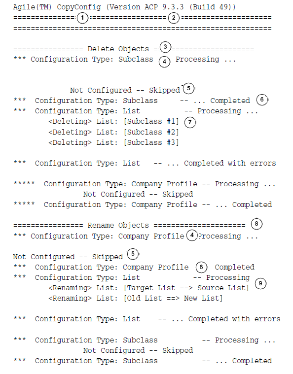

The ACP log files are intended to tell the propagation story.
The purpose of the verbose log is to provide information about specific changes made by ACP. The verbose log is produced only when the target data source is an Agile PLM instance. It logs the objects that are processed and reports the fields whose value has changed.
The purpose of the console output is to let you monitor the progress of ACP as it is running. ACP announces when it is starting and ending a configuration type. It also lets you know the status of processing for a single configuration type.
As each object of a configuration type is processed, ACP logs the name of the object to the console. Objects are processed in alphabetical order. The name of the object being processed provides a rough sense of the progress ACP has made on a single configuration type.
| Item # | Description |
| 1 | Name of the ACP module running. |
| 2 | Version of ACP running. |
| 3 | Delete Objects Banner. This is the start of the Delete action processing. |
| 4 | Configuration Type. This is the name of the configuration type being processed within a program action (Delete, Rename, or Copy). |
| 5 | Not Configured. If the configuration type is not configured for the action being processed, the program reports that it is not configured. |
| 6 | Configuration Type Status: This is the action processing status for the configuration type. It will indicate if the processing "Completed" (no errors or warnings), ”Completed with warnings” (had warnings), or ”Completed with errors” had errors. |
| 7 | Delete Objects. Shows which object is currently being deleted. |
| 8 | Rename Objects Banner. This is the start of the Rename action processing. |
| 9 | Rename Objects. Shows which object is currently being renamed. It is also showing the name transformation. |
| 10 | Copy Objects Banner. This is the start of the Copy action processing. |
| 11 | Copy Objects. Shows which object is currently being copied. If it indicates "<Skipping>" before the name, this indicates that the object was not matched using the include/exclude patterns. |
| 12 | Program Completion Message. This is a human-readable message indicating if the program succeeded, failed, or completed with warnings. |
| 13 | Program Completion Code. This is the computer-readable equivalent to the Program Completion Message. Zero indicates the program completed with no errors or warnings. A positive number indicates the program completed with errors (and possibly warnings). A negative number indicates the program completed with warnings (and no errors). |

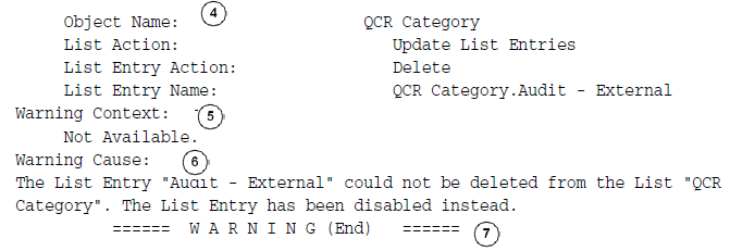

| 1 | Start of Error or Warning Message. Signifies the start of a single error or warning. |
| 2 | Process Context. The process context section provides clues about what object ACP was processing at the time of the error or warning. |
| 3 | Propagation Action, Configuration Type, Configuration Object Context. These three lines of process context provide all of the information you need to know exactly which object was being processed and which action was being performed. |
| 4 | Additional Context. Additional context will vary with each error or warning. It attempts to describe within an object what information ACP was working with. |
| 5 | Error or Warning Context. The error or warning context provides information about what ACP was doing at the time the error or warning occurred. |
| 6 | Error or Warning Cause. The error or warning cause is the specific message issued by the application at the point where the error or warning was detected. |
| 7 | End of Error or Warning Message. Signifies the end of a single error or warning. |

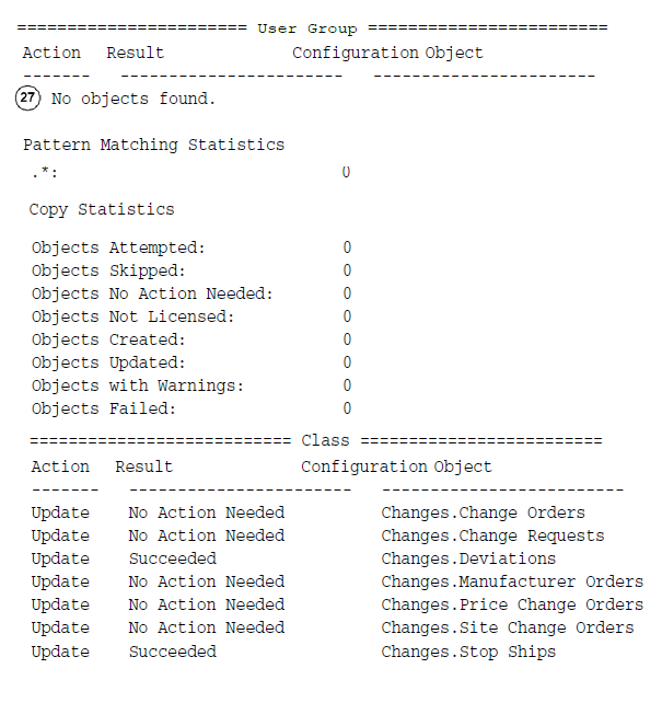

The purpose of the process log is to capture all of the information pertaining to processing.
All command-line parameters, program properties, and control file settings are written to the process log. This helps to validate the correctness of the settings in place.
As objects are processed, an entry is logged for the object along with the action taken by ACP and the result of the action.
Finally, the process log summarizes the processing in a set of statistics providing counts and also the amount of time it took to process.

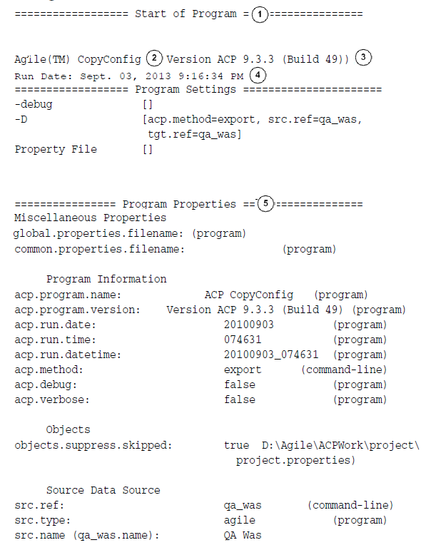

| 1 | Start of Program banner. Signifies the start of a single run of ACP. |
| 2 | Name of the ACP module running. |
| 3 | Version of ACP running. |
| 4 | The date and time that the current run of ACP was started. |
| 5 | Program Properties Section. The properties are a means to influence the business logic that ACP uses regarding configuration types. The amount of influence on business logic varies by configuration type. |
| 6 | Control Setting Section. The configuration values specified in the control file. |

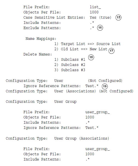

| 15 | Configuration Type Attributes. Some configuration types may have attributes in addition to the common attributes (file_prefix and objects_per_file). For example, lists have the case_sensitive_list_entries. |
| 16 | Exclude Patterns. The list of exclude patterns configured for the configuration type. These are the regular expressions used to match the object names of the current configuration type. If the object name matches an exclude pattern, ACP will skip the object. |
| 17 | Name Maps. The list of name mappings for the configuration type that ACP will use to rename objects in the target instance. |
| 18 | Delete Names. The list of objects for the configuration type to delete from the target instance. |
| 19 | Ignore Reference Patterns. Some configuration types allow ignore reference patterns to be specified. These patterns are used to quash error messages when an object with a name matching one of the patterns cannot be resolved. |

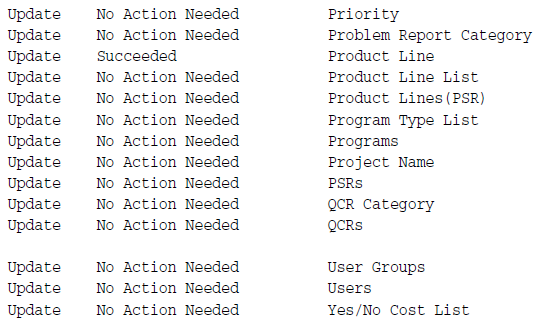

| 20 | Program Actions. The program actions section simply indicates which program actions are configured. The available actions are Copy, Rename, and Delete. |
| 21 | Configuration Type Detail. Each configuration type that is propagated has a detailed section showing the action taken for each object of that configuration type. The name of the configuration type is listed at the beginning of the section. Configuration types that have not been configured will not have a detail section. A separate configuration type detail section exists for each program action (Copy, Rename, and Delete) if configured. |

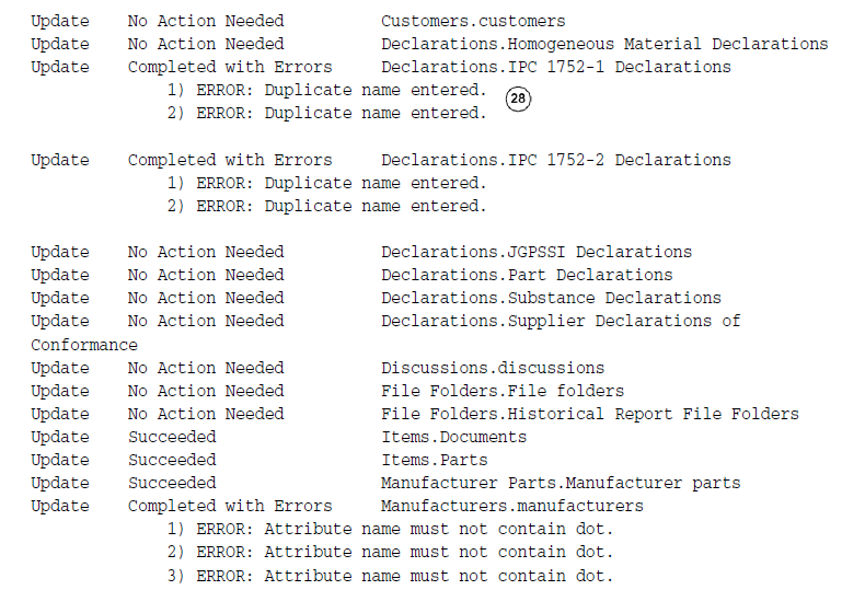

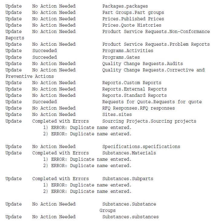

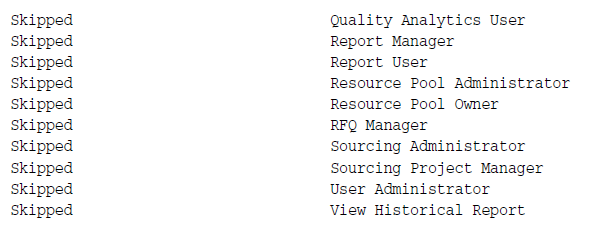

| 22 | Action. The actual action taken by ACP.
Skipped - Was excluded by the include/exclude patterns specified. Created - The object is new in the target. Updated - The object already existed in the target. Renamed - The object's name has changed in the target. Deleted - The object has been deleted from the target. |
| 23 | Result. Indicates how the action performed.
No Action Taken - The target object remains unchanged. Succeeded - The target object has been changed successfully. Warning - The target object has been changed successfully, but there were notes to be aware of. Failed - An error has occurred while processing the object. The object may or may not have been updated. |
| 24 | Configuration Object. The name of the configuration object being processed. |

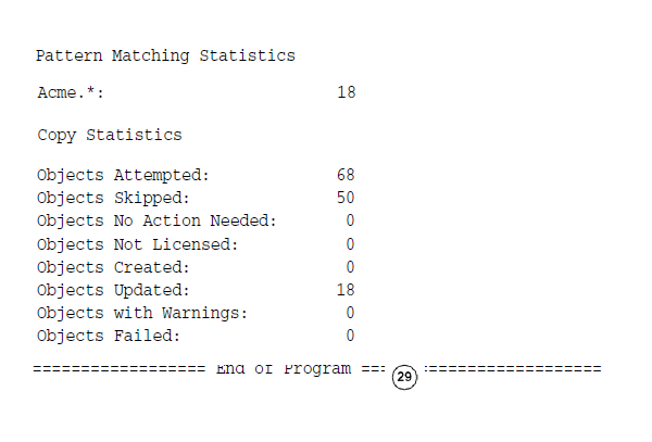

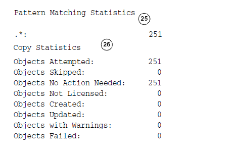

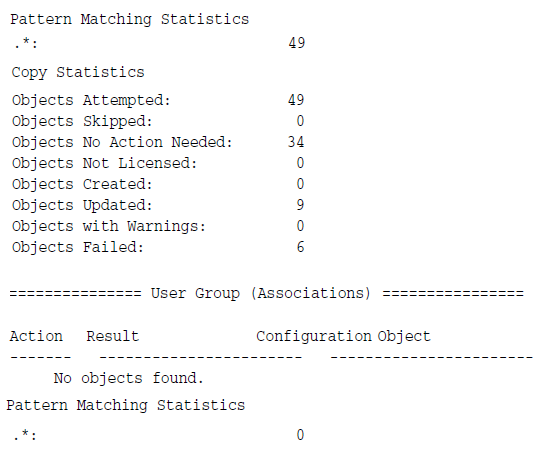

| 25 | Pattern Matching Statistics. The pattern matching statistics help you understand how well your patterns (regular expressions) match the objects in the source instance. |
| 26 | Copy Statistics (also Rename Statistics and Delete Statistics). The copy statistics section summarizes the object processing for the configuration type. It is an easy way to find out how many objects were propagated and also the number of objects that are available to propagate. |
| 27 | No objects found. Indicates that no objects were found for the configuration type. This provides a clear statement to this effect rather than not having anything listed at all. |
| 28 | Error Messages. A brief description of error messages appear in the Process Log. Refer to the Error Log for more detailed information about errors. |
| 29 | End of Program banner. Signifies the end of a single run of ACP. |
