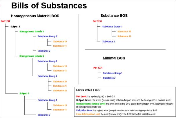

Depending on the type of specification with which you need to be compliant, you will need more or less information from your suppliers. For example, the RoHS legislation wants parts to be compliant at the homogeneous material level. This means that you might require your component manufacturer to specify how much lead it contains per homogeneous material within the component.
Unfortunately the sub-units (subparts) of a component (say, the packaging around a chip) are not always homogeneous, but they may consist of a coated material. For the RoHS legislation, this means that such a subpart consists of two homogeneous materials, each of which must be compliant.
This creates a tree structure called the Bill of Substances. Suppliers need to provide information at each of the levels of the BOS.
Depending on the type of specification involved, levels in the above list may be omitted.
Figure 6-1 Schematics of Bill of Substances
Schematics of BOS
