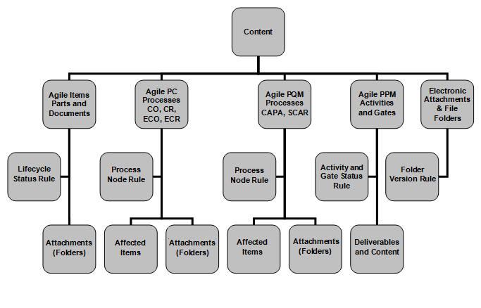

In PPM, 'content' refers to deliverables associated with the project. A deliverable can be any project or project object that has a lifecycle phase or a workflow assigned to it, or any file added as an attachment in the Content tab. Examples of content are programs, projects, phases, templates, files or URLs, or objects referenced from other applications.
The Content tab is not simply a list of deliverables, but a rule-based control system for project management. Any content can have a rule associated with it. Rules can be set to prevent tasks from starting or completing unless certain deliverables have reached specific states or status. The template will allow you to build out complex control mechanisms that alert users, automate many project processes, and prevent inappropriate tasks from starting or completing out of sequence or without the right information. The following picture outlines what the content tab can contain, what rules can be applied and if the content itself can have attachments or content:
Important: As a best practice, it is recommended that the attachments tab in Agile PPM activities and gates be disabled. Agile PPM provides a unique tab, the Content Tab, that must be used for all project content, including attachments, for projects. |
Discussions, Users, and User groups are the only objects that cannot be added as deliverables.
This section describes content objects and key functions such as adding new content, marking content as 'Mandatory', and working with the Content tab.
You can add activities and gates as deliverables on other activities and gates. You can also set rules to ensure the completion of one activity before another. For example, to ensure the completion of an activity before a gate is opened, you can add that activity as a deliverable for the gate to open. You can even restrict one gate from opening before another gate is opened, by adding the prior gate as a deliverable to the subsequent gate.
