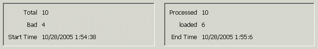

This section describes how to evaluate FileLoad results in the Java Client and Web Client.
In Agile Java Client, the FileLoad summary appears in an expanded portion of the FileLoad window.
FileLoad log files are stored in the specified Log File Directory. You can open the log files in a text editor to view them. For each session, FileLoad creates the following log files:
indexfile.date.time_BAD - Contains the rows from the Index file that are rejected during the FileLoad process.
indexfile.date.time_LOADED - Contains the rows rejected from the Index file that are successfully loaded during the FileLoad process.
indexfile.date.time_LOG - Contains each row from the Index file that was rejected during the FileLoad process, along with an error message.
indexfile.date.time_SUMMARY - Contains the FileLoad summary information.
Note: If you rename the log files and give them a.TXT extension, they are automatically associated with a text editor. |
In Agile Web Client, the FileLoad Summary appears after FileLoad has finished processing the Index file attachments.
Attachment loading results are shown in FileLoad Summary.
Click View Bad File to open or save the log of bad records (LogFile.BAD). It contains rows from the Index file that are rejected during the FileLoad process.
Click View Log File to open or save the log file (LogFile.LOG), which contains each row from the Index file that was rejected during the FileLoad process, along with an error message.
Note: Agile recommends that you save log files to disk first and then view them. When you save a log file, add.TXT as the extension so the file is automatically associated with a text editor. |
To close the FileLoad page, click Done.
