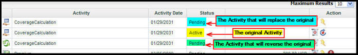

Selecting the Recycle button associated with an activity creates two additional activities to be processed. The first is a reversal activity that has green reversal arrows for its Activity Detail icon. The second activity replaces the original activity. The reversal activity must be processed prior to the new activity that will replace the original.
Step 1: Select the recycle button for an activity.
Two pending activities are generated in OIPA for the reversal and new activity.
Two Pending Activities Generated For Recycle

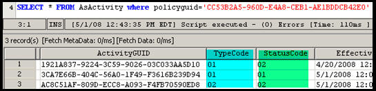

Two additional records are written to the database to track the reversal and new activity.
Reversal Records Written to Database

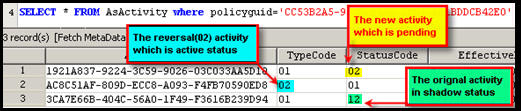

Step 2: Select the Process button for the reversal activity.
The status of the original activity is updated to shadow and the reversal activity status is updated to active.
Active Reversal Activity
The status of the original activity’s record changes from 01(active) to 12(shadowed). The reversal activity changes from 02(pending) to 01(active).
Reversal Activity in the Database

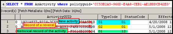

Step 3: Select the pending activity that has the correct information.
The activity’s status changes from pending to active. The new activity’s status changed from 02(pending) to 01(active).
Explanation of Reversal Records in Database

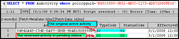

There are now two records, one for the original activity and one for the reversal activity.
Two Reversal Activities in Database
