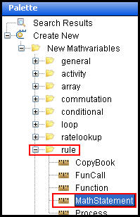

MathStatement Math Variable in Palette Window

Drag and drop the MathStatement function from the Palette window onto the Math Pane. Enter the following information for the MathStatement.
Select a variable type from the Variable Type drop down list. field.
Click the Functions field for a list of the supported types of functions. Select one of the supported functions.
Enter the Input or Output values in the Values column for each parameter as needed. Input parameters are required. Output parameters are optional.
Check-in the transaction to save the information to the database.
