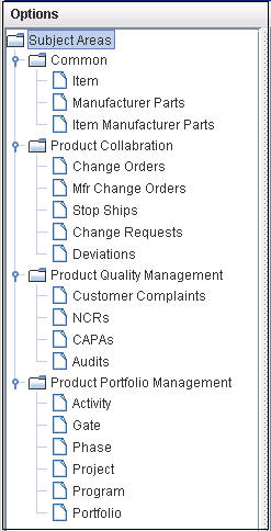

Subject Area pane - Displays the Agile PLM module and its subject areas. It is located on the left-hand-side of the OPLA Configurator.
Mapping Table pane - Displays the target and source destinations for all the PLM attributes that can be configured. It is located on the right-hand-side of the OPLA Configurator.
You can customize the default values for the Subject Area pane and the Mapping Table pane as per your requirements.
For more information on how to customize the default values, see Customizing the Interface on page 19.
A Subject Area is a group of configurable fact tables in the MDS schema. These configurable fact tables correspond to subject areas of PLM Analytics modules within OPLA.
The Subject Area pane has a hierarchical tree structure. The first level shows the Agile PLM module name, and the second level shows the supported subject areas for that module.
Each subject area can be associated with one or more Fact types. Each fact type appears as a tab on the right pane, where its corresponding attributes are displayed.
In Product Portfolio Management, for the Program, Phase and Portfolio subject areas, the Cover page, Page Two, and Page Three attributes specific to the corresponding domains appear on the right pane. For example, the Phase subject area displays only the Phase-specific P3 attributes. For Gate, Activity and Project subject areas, the P3 attributes of all the subclasses are displayed.

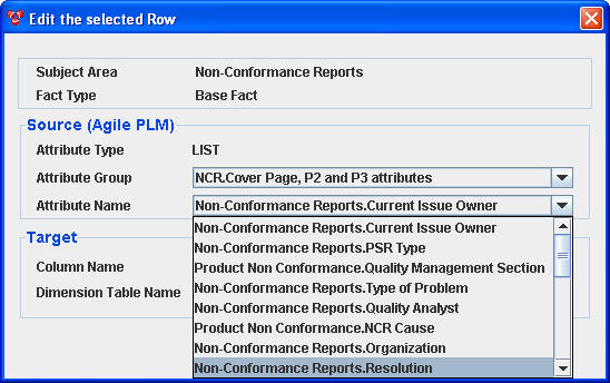

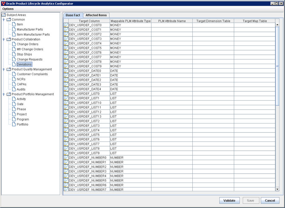

In the OPLA Configurator the right side shows the Mapping Table pane. It is a fact table where the target and source information is displayed. Some tips on the Mapping Table pane:
Some target values are auto-populated.
Source data for each row needs to be selected manually from the options provided.
Target columns show the target field name and dimension table where applicable.
User-defined fields are prefixed with 'USR_DEF'.
| Column | Description |
| Target Column | Column name within the Fact table in MDS schema to which the PLM Attribute is mapped. |
| Mappable PLM Attribute Type | Type of PLM Attribute (or Field) that can be mapped to the corresponding column in the Fact table. Possible Values: Number, Date, List, Multi-list, and Money. |
| PLM Attribute Name | Name of the PLM Attribute (or Field) that is mapped to the corresponding column in the Fact table. |
| Target Dimension Table | Name of the dimension table in the target MDS schema. It is used only if the PLM Attribute Type is "List" or "Multi-List".
Note The user cannot change the Target Dimension Tables for the user-defined "List" attributes of PPM, as all the user-defined columns for PPM are maintained in a single dimension table. Refer Oracle Product Lifecycle Analytics Data Reference Manual for the database tables. |
| Target Map Table | Name of the bridge table in the target MDS schema. It is used only if the PLM Attribute Type is "Multi-List". |

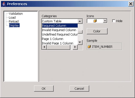

To display the Preferences dialog box, select Tools > Preferences. The Preferences dialog box controls how table and column categories appear based on their status (valid, invalid, undefined, or nonresistant).
For each category and its status, you can select the icon that is associated with the category, the color of the font, and determine if the category should be hidden. The preferences are saved to the Settings.xml file and will appear the next time you start DataLoad. You can copy the Settings.xml file to other computers so that DataLoad uses the same preferences.
To set the display preferences:
Click Options > Preferences.
Select the attribute types you want displayed in the right pane.
Click Save.
To view the Source columns corresponding to the displayed Target columns in the right pane, select Run in Debug mode.

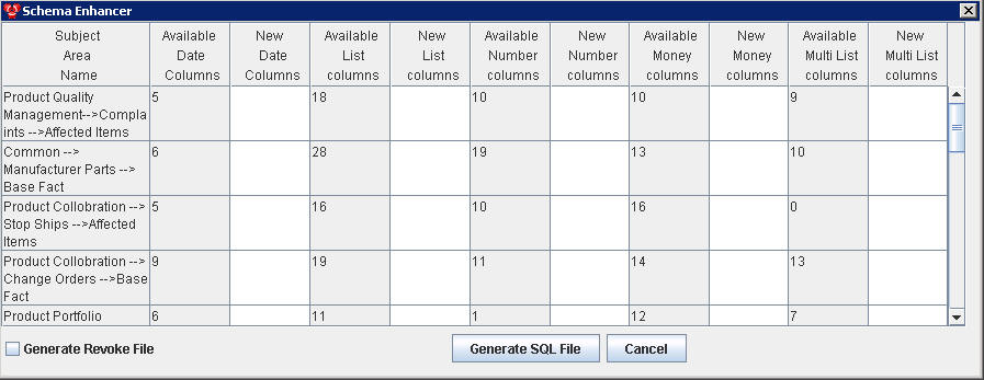

You can increase the number of the available user-defined (configurable) fields in the schema.
You can add columns to enhance the MDS Schema if the available user-defined configurable fields in the tables are not sufficient to accommodate your business requirements.
The supported attribute types are:
Date
List
Multi List
Number
Money or Cost
Text
To add new user-defined columns in the MDS Schema:
Click Options > Add user-defined Fields. The Schema Enhancer dialog box appears.
The Schema Enhancer dialog box lists the tables that have Date, List, Number, Money, Multi-List, and Text columns and the count of each of these columns for every table.
In the New columns cell, enter the number of additional columns of the attribute type you need in the table.
Click Generate SQL File to generate the SQL script that enables you to alter the tables to include the additional columns.
Save the generated file with a .sql extension.
Run the generated SQL file manually on the MDS database schema user, to include the additional user-defined columns in the specific table. The OPLA Configurator displays the new columns as rows.
Note Select Generate Revoke File checkbox to generate a script that retains the existing table structure. If you want to reverse the addition of new fields, execute the revoke file.

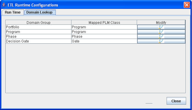

The ETL Runtime Configuration window enables you to:
Configure the Domain values for all the sub classes using Domain Lookup tab
Set the ETL properties at run time using the Run Time tab

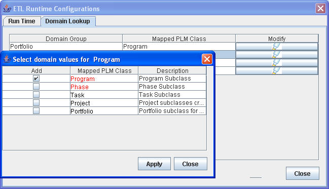

To configure the Domain values:
Click Options > ETL Configurations. The ETL Run Time Configuration Window appears - as shown below.
In the Domain Lookup tab, the Domain Group column lists all the available domain groups. The Mapped PLM Class column displays the PLM sub classes mapped to the domain groups.
Click the Add icon on a domain group row. This is the domain group for which you want to configure a corresponding PLM subclass. For example, Program. The Select Domain values for Program popup window is displayed.
The sub classes displayed in the Select Program Domain Values popup window are specific to the Activity class. This applies to Project, Portfolio, and Phase Domain Groups.
If you \ clicked the Add icon on the Gate Domain Group row in the Domain Lookup tab, only sub classes specific to the Gate class appear in this window.
Select the checkbox in the Add column to choose the PLM subclass. You can select any sub class that belongs to Activity class.
Click Apply.
The selected PLM subclasses are appended into the target domain group and saved into the database. If a subclass is already mapped to another domain, a warning message appears. If you are a 9.2.2.x user, it is recommended that you create separate sub classes for your 'Program' and 'Portfolio', and configure both these subclasses to 'Program' domain. This ensures meaningful analytical reports.

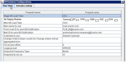

To set the ETL run time properties:
Click Options > ETL Configurations. The ETL Runtime Configuration Window appears.
Click the Run Time tab. The ETL Runtime properties appears as follows:
Calendar to use parameter: Out-of-the-box the default variable is Default Calendar. Choose the Gregorian Calendar option to see the traditional January to December calendar.
Double-click on the Property value column against a Property Name.
Enter or modify the ETL Run time property.
Click Apply.
These properties come into effect only after the ETL has been run.
| Property Name | Description |
| STAGE ETL Load TypeandMDS ETL Load Type | You can set this property to run ETL as any of the following:
1. Full Load (Full) 2. Incremental Load (CDC) 3. Disable (Disable) The very first time you use the Oracle PLA Configurator for new mappings, the ETL run type is always Full Load irrespective of the value of this property. |
| Set Staging Module | Uncheck the check box to disable specific staging modules.
For example, if you only need the PC and PQM staging modules, you can disable PPM, PCM, and PGC. |
| Change Orders | Enter a date from when you want to start analyzing week-level aggregations. |
| Mail server to use | Enter a valid mail server name. Use the server that sends email notifications for the ETL execution status. |
| From mail ID to send ETL Notification | Enter the e-mail ID from which the ETL execution status emails are to be sent. |
| Change Orders | Enter a date from when you want to begin runtime configuration analysis. |
| Mail ID to send ETL Notification | Enter the e-mail IDs of the users who need to receive emails of the ETL execution status. |
| Calendar to use | If you are a Time Utility Member choose Fiscal Calendar as your default calendar. You can change this parameter manually if you want to use Default Calendar. |
| Fiscal Calendar Start Date | Enter the start date of the Fiscal year. This setting allows you to perform analysis of Business Intelligence data based on your organization's fiscal or calendar year.
The date must start with the 1st day of the month. |
| Fiscal year offset | This parameter specifies the offset for the fiscal calendar year with reference to the Default Calendar year.
Values are: 0 - The dates and year for the Fiscal Calendar match the dates and year of the Default Calendar. 1 - The dates and year for the Fiscal Calendar is one year ahead of the current calendar year. -1 - The dates and year for the Fiscal Calendar is one year behind the current calendar year. For example, if your fiscal calendar year for 2011 starts on April 1, 2010, then for the Fiscal year offset value choose 1. |
| Logging level | This parameter indicates the debugging level required to log the run time ETL messages into the VLOG table.
Options are: ERROR WARNING INFO DEBUG ALL |
| Snapshot Frequency Type | Based on the project summary snapshot, this setting is used to perform analysis of BI data.
Options are: Month - Snapshot fact table populated monthly. Week - Snapshot fact table populated weekly No Snapshot - Snapshot fact table never populated. |
| Snapshot to run on | Based on the project summary snapshot, this setting is used to perform analysis of BI data. You select which day of the week you want to run the ETL to take a snapshot of the project summary table.
Options are: SUNDAY MONDAY TUESDAY WEDNESDAY THURSDAY FRIDAY SATURDAY If you have choose Month as your Snapshot Frequency Type, and the day of the week you choose for the Snapshot to run on field does not occur in that month, then the snapshot will run on the last day of the month. |

In the OPLA Configurator:
In the left pane, expand the subject area category node, and click the subject area corresponding to the Agile PLM class. For example, under PQM, click NCR.
In the right pane, select either the Base Fact or the Affected Items tab.
Select the Target Column row for the attribute type you wish to map, and click . The Edit the selected Row dialog box opens. Alternatively, you can right-click on a target cell.
4. In the Edit the selected Row dialog box, select options from the drop-down lists to map the field or column to PLM attributes as per the details you noted down earlier.
In the Attribute Group list, select the PLM attribute group from which you wish to source attributes. The list of attribute groups is different for Base Fact and Affected Items. For details, see Supported Mappings.
In the Attribute Name list, select the attribute name that you want to map. The list shows the options that you have enabled in Java Client. If a list ID has already been mapped to a target dimension table, only those attributes associated with the same list ID are displayed for selection.
If you choose a user-defined list, you are now provided the option to map it to a target dimension table. This is not applicable to user-defined list attributes of PPM.
The Attribute Name list displays only the attribute names that correspond to the Attribute Group you select.
From the Dimension Table Name list, select a target dimension table for the mapping. You can map the same list /multi-list attribute to any number of target dimension table names, but a list ID can be associated with only one target dimension table. You cannot map a cascade list to any user-defined list.
Click OK.

From the Options menu in the Oracle Product Lifecycle Analytics Configurator, select ETL Configurations. This opens the ETL Runtime Configurations window.
In the ETL Runtime Configurations window, select the Run Time tab.
a. From the Property Name column, select the STAGE ETL Load Type row. Click the adjacent Property value column, select Disable.
b. From the Property Name column, select the MDS ETL Load Type row. Click the adjacent Property value column, select CDC.
c. In the ETL Runtime Configurations window, first select Apply, and then Close.
Click OK, in the ETL Parameters Updated message box.
